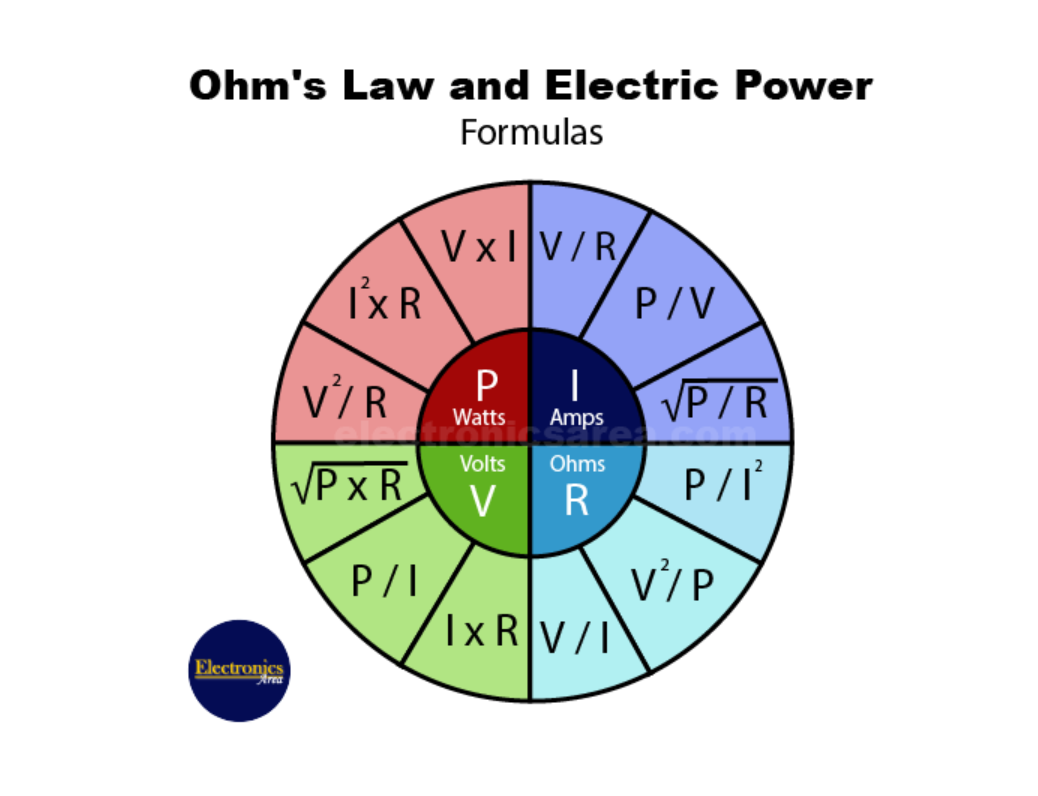

Can I infer that Aleph JZM is seven or so watts of power. Not sure how to calculate output power.

Into what load? For the 6R5 load, assuming your measurements are correct, that's close enough. By my math, it's close to 8W. I wouldn't split hairs.Can I infer that Aleph JZM is seven or so watts of power.
Ohm's Law.Not sure how to calculate output power.
