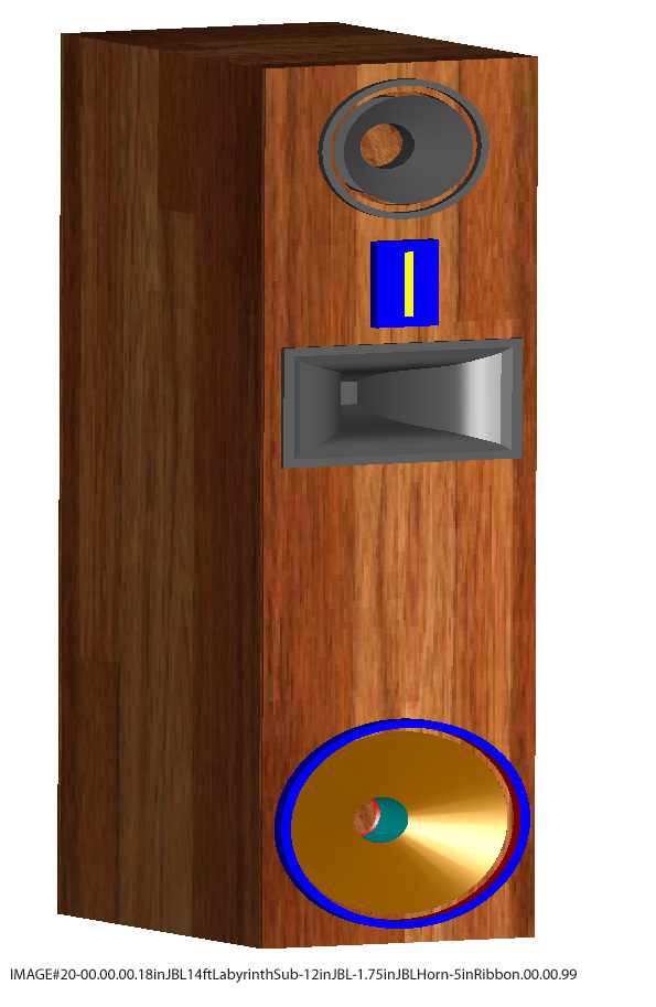

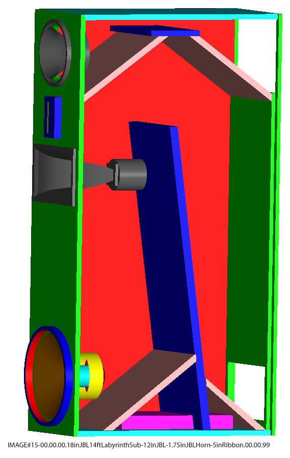

The speakers I have are to use the Aleph amp above 100Hz, below 100Hz the subs have their own amps, above 100Hz my speakers are 98db per watt so I never use more than 8watts at home for 107db continues sound pressure. Can someone give me any information on the quality of A J-X & A J amplifiers sound if power is not an issue ?
