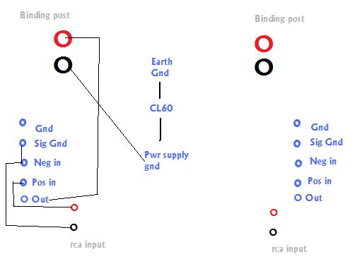

AJ grounding scheme
I thought I had this figured out, but after reading recent posts, I rewired my stereo J's grounding and now the hum has returned. Perhaps someone can tell me the proper grounding scheme at a real basic level. I am using Peter Daniel's signal and power boards and am using rca inputs exclusively (don't even have XLR's on the chassis). So rca center pin goes to PD in+. Rca shield goes to PD- and is jumpered to SG on PD board. PD board 'out' goes to red binding post. Black binding post goes to other side of CL60, which in turn is connected to chassis screw which is earth grounded to ground lead of power cord. Power supply ground also goes to signal ground side of CL60. This configuration hums. I avoided hum by lifting the ground connection between black binding posts and signal ground, and instead wiring black binding posts to ground/signal ground (circuit traces are connected) on PD board. However, this does not ground the circuit - the ground is kept only from the RCA shield. I have tried to attach a picture to help visualize. If someone would kindly help... thanks!
algg,
I agree with Bill, In addition
I run only one ground from the board, RCA - and black terminal to power supply ground as you have it. after your CL60 side, connect to chassis and ground IEC pin (socket). this should be safe and hum free.
