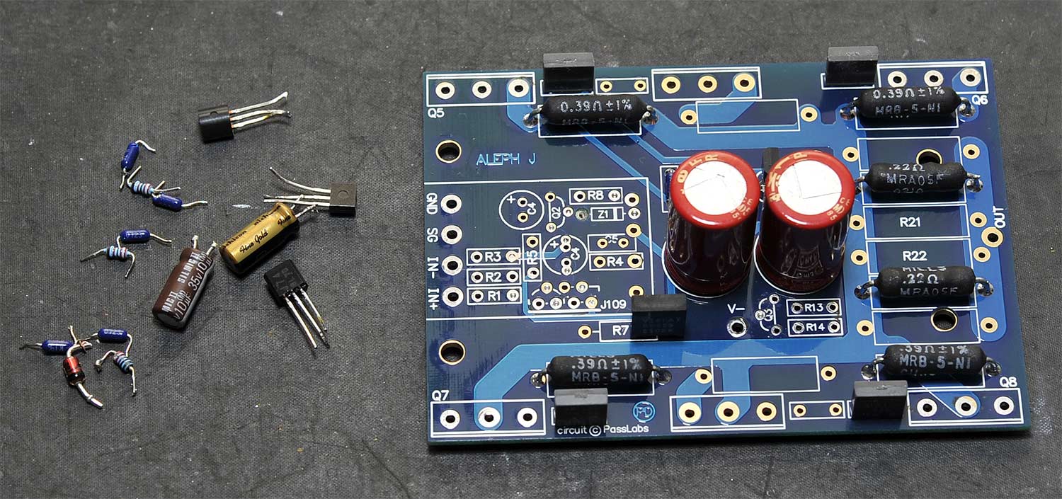

I tested a single Aleph J channel today and everything works fine.
300VA, 2 x 18V Plitron transformer produces approx 28V unloaded and 26V after connecting to the amp.
Loosely matched SJ74 give approX 35mV offset.
Next thing will be J-X setup.:xfingers::wrench:

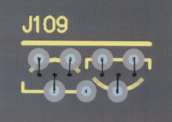

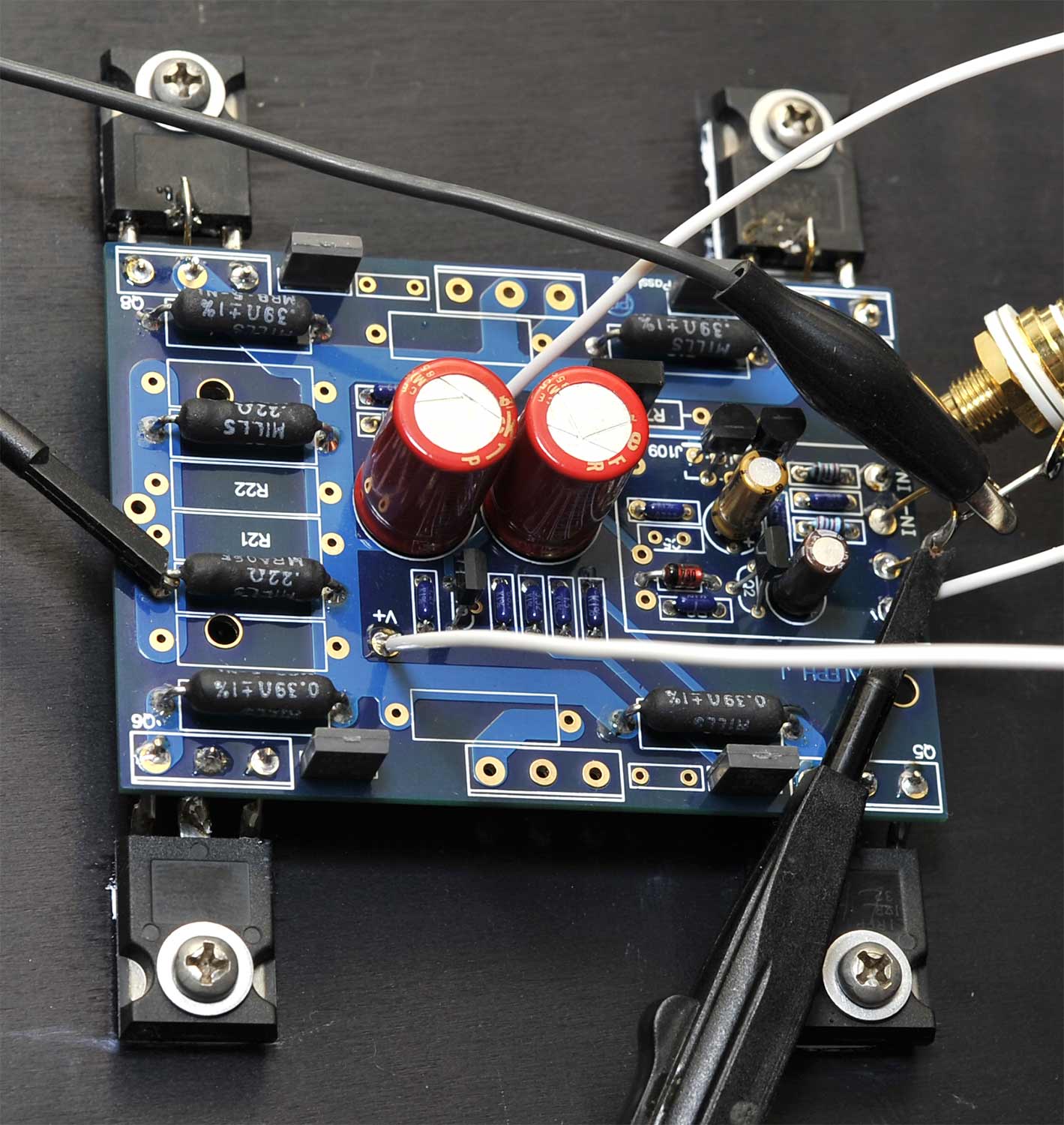

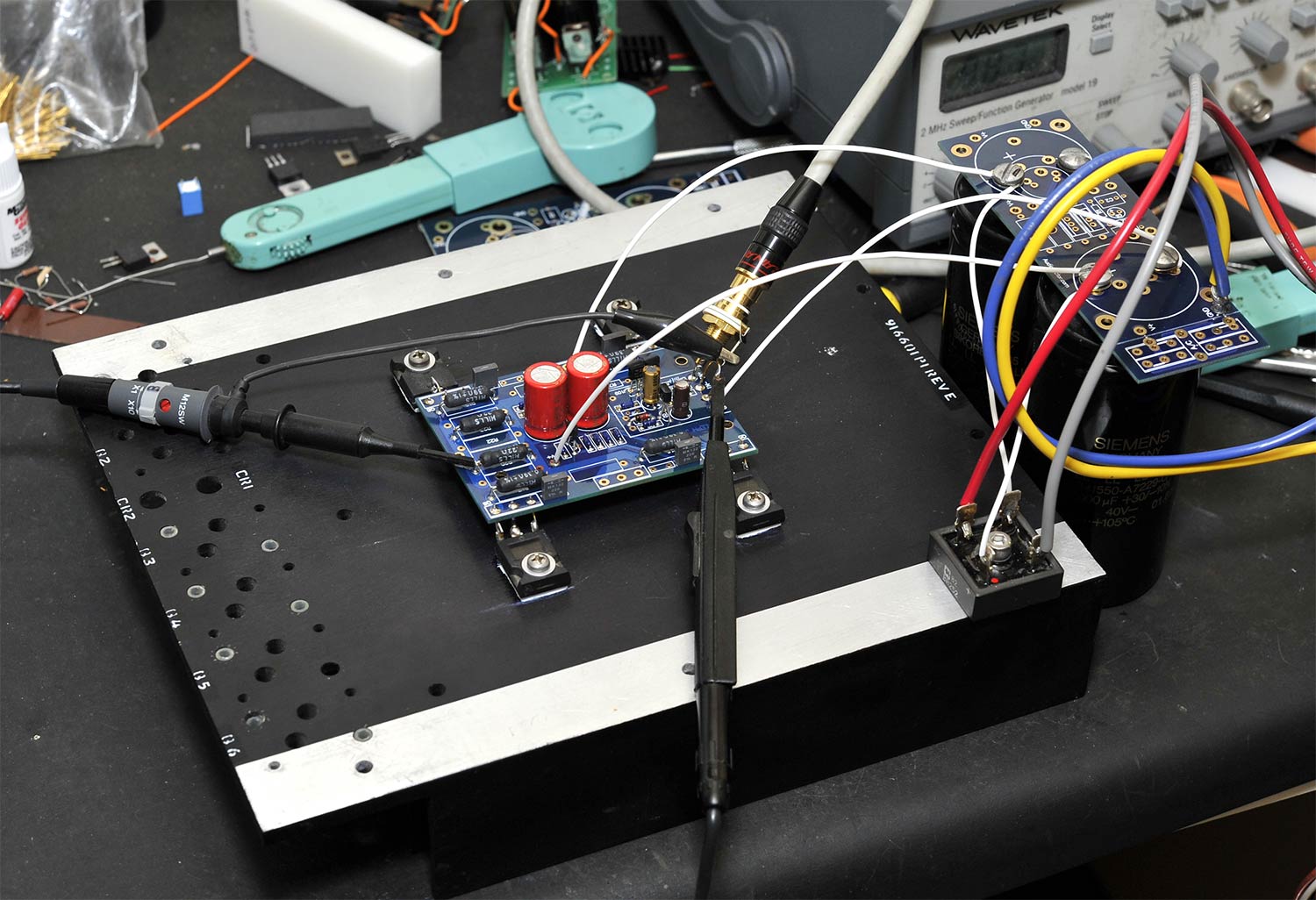

I wasn't actually correct, the DC offset was approx 2mV, I forgot about the offset produced by the generator.
The amp runs hot: the 8x8 heatsink with 1.75 fins was way too small for 2 x 18V transformer.

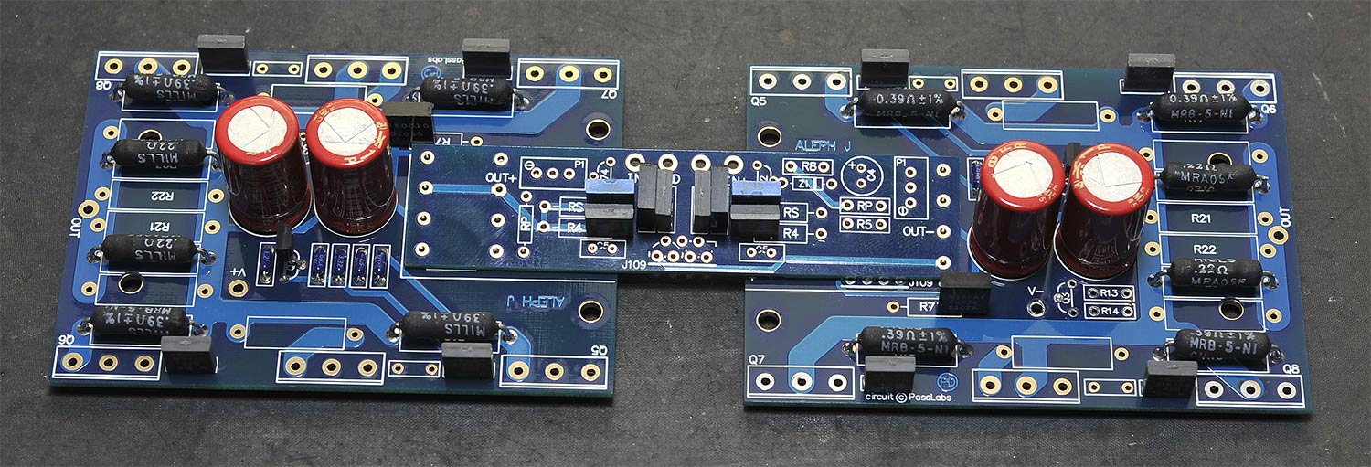

For AJ-X configuration, front end components (inside white border) should not be installed. I just removed them from test channel and I'm slowly getting ready for an X
