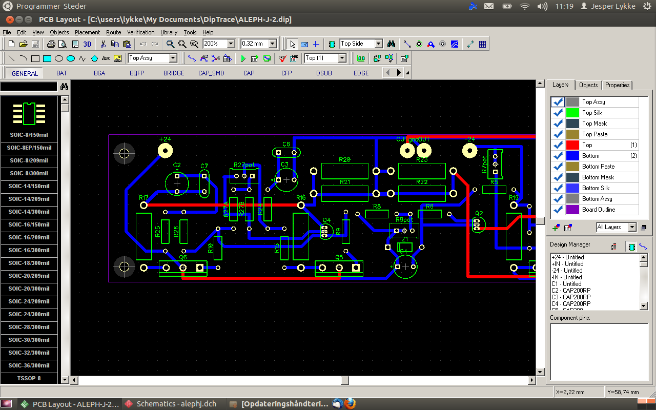

I am about to make a Aleph-J (DIY from scratch). The mounting of the Q5 , 6, 7 and 8, will be wired (10cm approx.) from the PCB.
So my quistion is : Is it wise to "hardwire" or eventually small outputboard the R9, 10, 11 and 12 and the R16, 17, 18 and 19 so those parts will be close to the mosfets ?
// Jesper.
- Attach. screenshoot of proto -layout...
