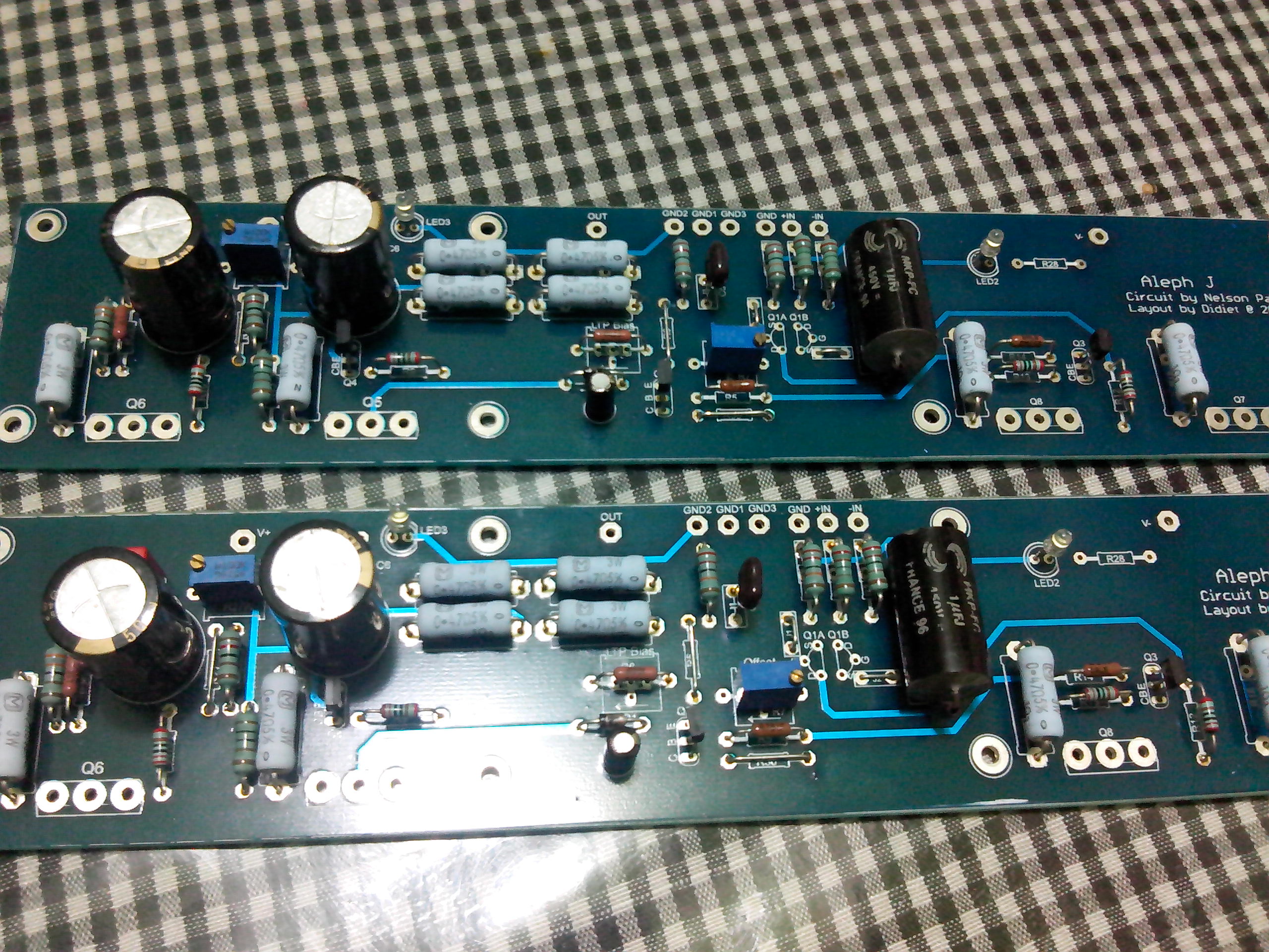

Almost ready to power up one channel... what voltage to expect at the joined sources of the 2sj109? In my case the 2 x 2sj108's ?

Powered up one channel and every thing looks nice... voltage across R8 is around 8.43 volts, around R7 around 4.23 Volts. Voltage on the sources of the 2SJ108's around +0.12 volts,
Voltage around the 0.47 ohm MOSFET's source resistors are around 0.6 Volts. Thanks Buzz for good matching! So biased pretty high. 30 Watts/ Mosfet.
Offset is around 0.014 volts, but with R7 easily trimmed to 0.00 volt.
Only the R27 variable resistor doesn't make much difference for the bias.. turning 3 a 4 turns doesn't make much difference... does it have to be a lower resistance to have less bias?
I ended up with 21k for R27 so keep turning. those 25 turn pots just keep goin round and round
I've been turning, turning and turning until it clicks... so it's doing nothing, have to check what's wrong... it plays music though and rest of measurements seems ok.
Do you have a jumper in the "other" R27? (Between the caps)
If not, your Aleph CCS is running wide open, and the pot isn't connected to the circuit.
