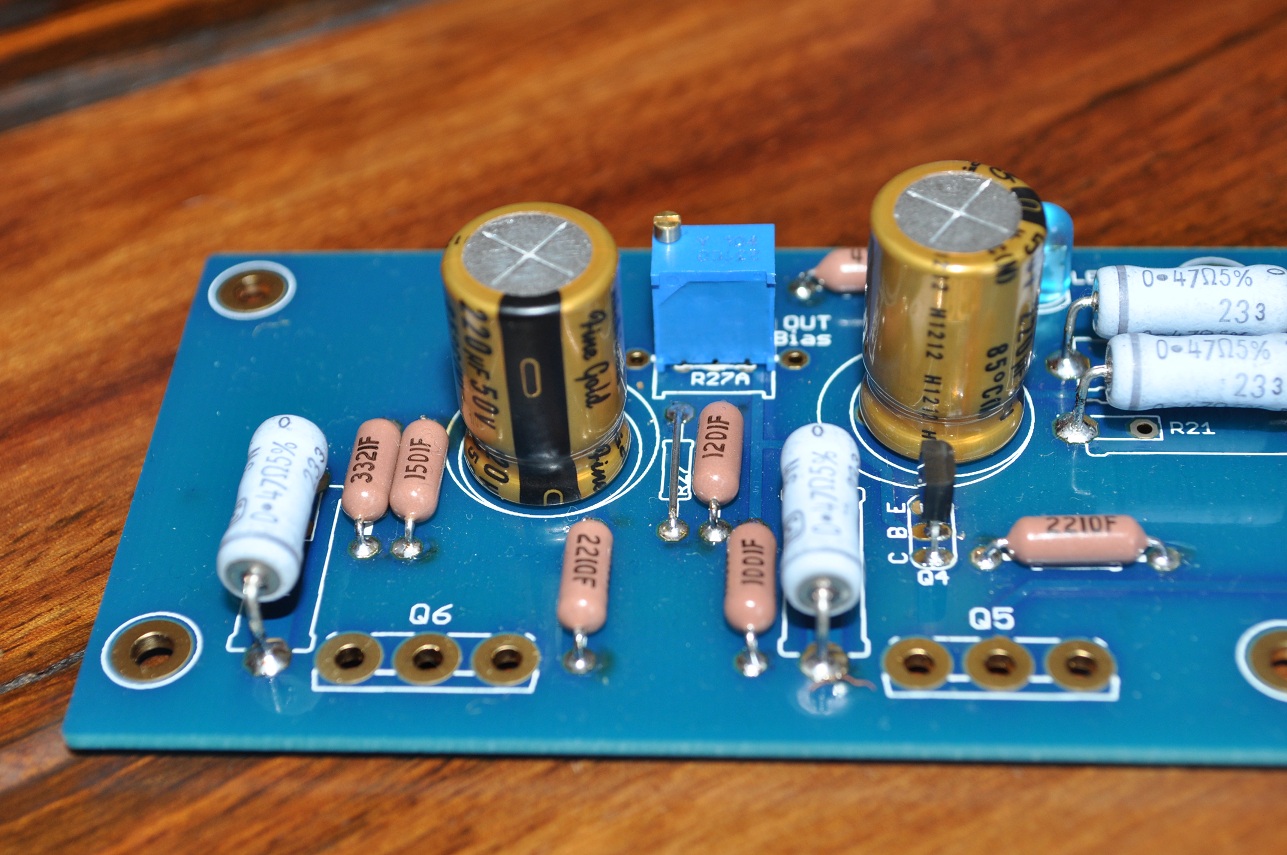

The bend ends up being where the skinny part of the MOSFET lead meets the fat part with the skinny part doing the bending (skinny vertical, fat horizontal). That was a nice touch by Didiet. An easy way to start the bend is insert the MOSFET all the way in to one of the board through hole positions and just bend it over the board about 30º. Use 6L6's widget method or a steady hand with needle nose pliers to finish the bend.
The bigger resistors are mounted soldier-style.
(I thought soldier style was the real term for that... maybe not...)

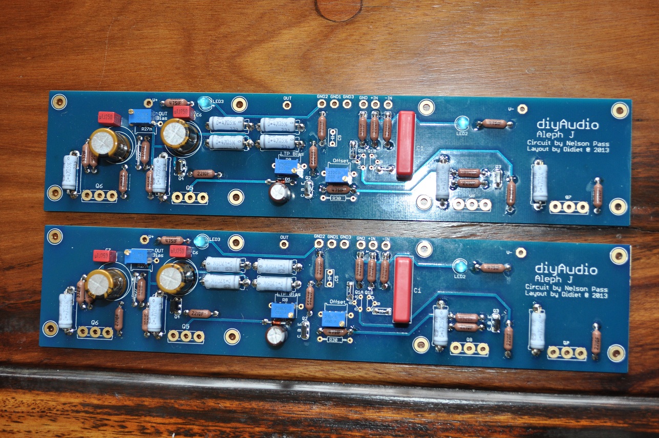

Here I have taken a picture where I am checking my spacing and layout against my KSA50 to get an idea of the sizing for my case. I will take a more close-up pic later today.
Note that I have used the smaller in size Nichicon FG caps. I am saving money for my heatsinks for next month. They will be the same as those I have used for my KSA50. Maybe just a tad smaller in lenght and height. Same profile though. They are working very well on my KSA50.
