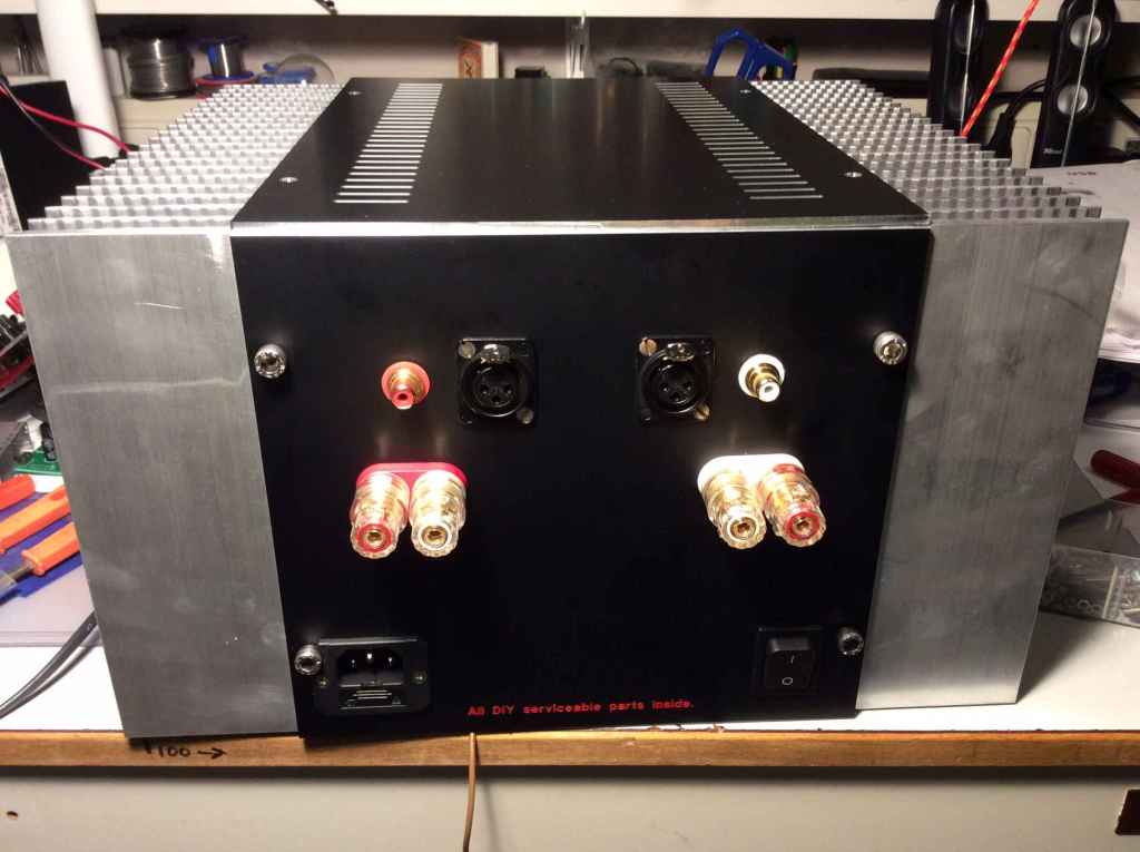

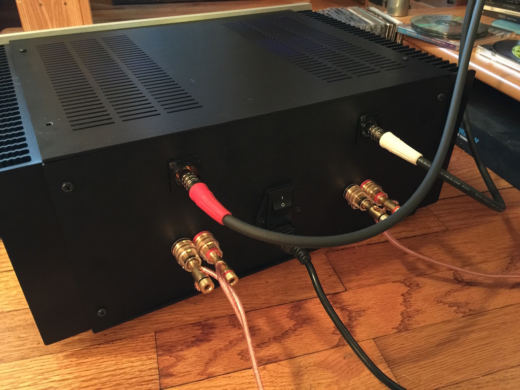

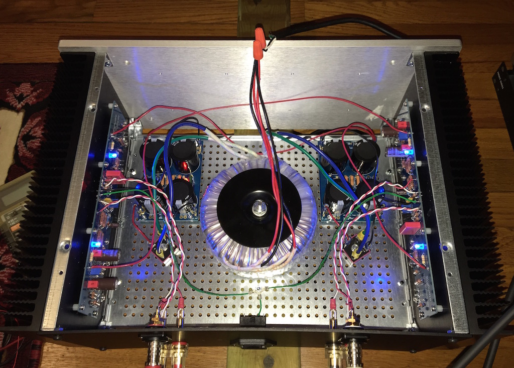

Here are some final build pics for y'all to enjoy! 😀

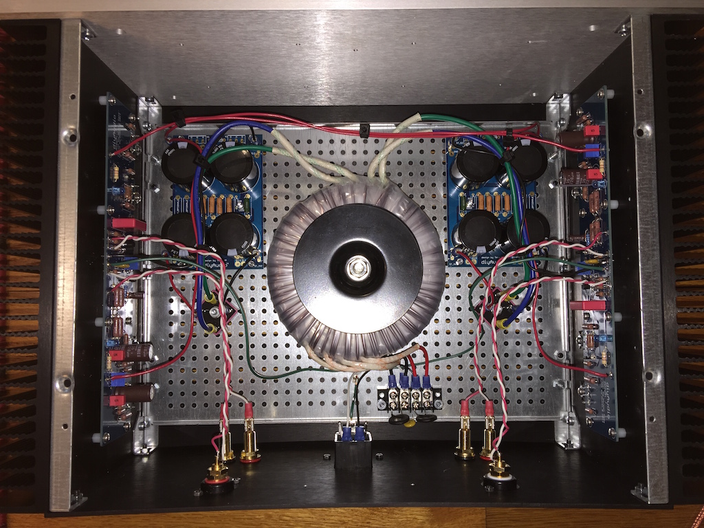

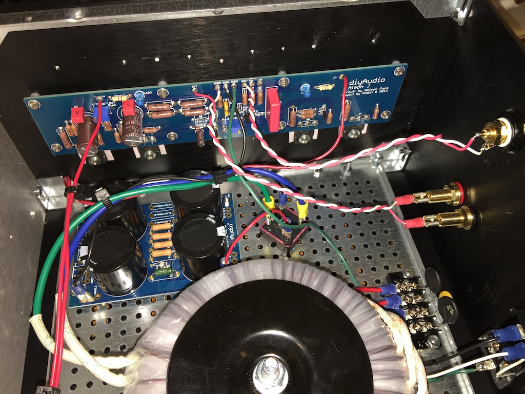

And one more question for the gurus ... when I had the transformer primary wire-nutted to an extension cord (without ground), the amp had NO hum! Now that I installed the IEC inlet, CL60's and AC line filter WITH a grounded IEC cable, I have a very slight hum. I need to go find my IEC that I have snapped the ground prong off of, but take a look at the pictures ... open to suggestions!

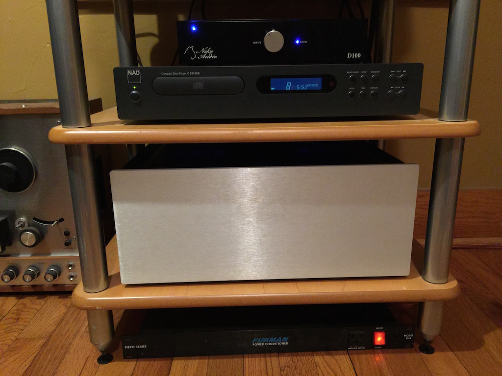

This is the most "engaging" amp I have built. Even more so than my RH84SE Rev2. Still would like the highs less rolled-off, so ordering a set of Mundorf EVO Silver Gold Oils ... hope that helps!

use IEC without filter , be sure that each channel audio gnd is having own dedicated CL60 going to case/safety gnd
damn
it seems that you have common PSU for both channels .......
put fat wire as bridge between main gnd points of two channel's pcbs
The green wire is tying GND together, so PSU is wired as bipolar... But I agree, a bigger wire there is a really good idea.
Isolating that wire from chassis with a CL-60 (as shown in the PSU diagram) will fix that. Your GND is currently at chassis (and therefore AC safety earth) potential.
The green wire is pretty big (hard to tell in the pics). It is about as large as I can fit in the PCB holes.
Right now that wire ties to chassis and IEC inlet. Nelson shows isolating the DC GND from the chassis AC GND with a thermistor which I can try. What about leaving the DC GND connected to chassis and isolating from IEC inlet with thermistor? Will that negate the safety aspect?
The only things that changed between it being quiet and noisy are:
I have also tried an IEC with a snapped off GND pin and still has noise ... makes no sense since it was quiet before with the same chassis/GND wring. 😕
- IEC cord with GND
- Thermistors on transformer primaries
- Cap across AC inlet
AC safety earth MUST touch the chassis unhindered. Power supply GND gets elevated off chassis by the thermistor.

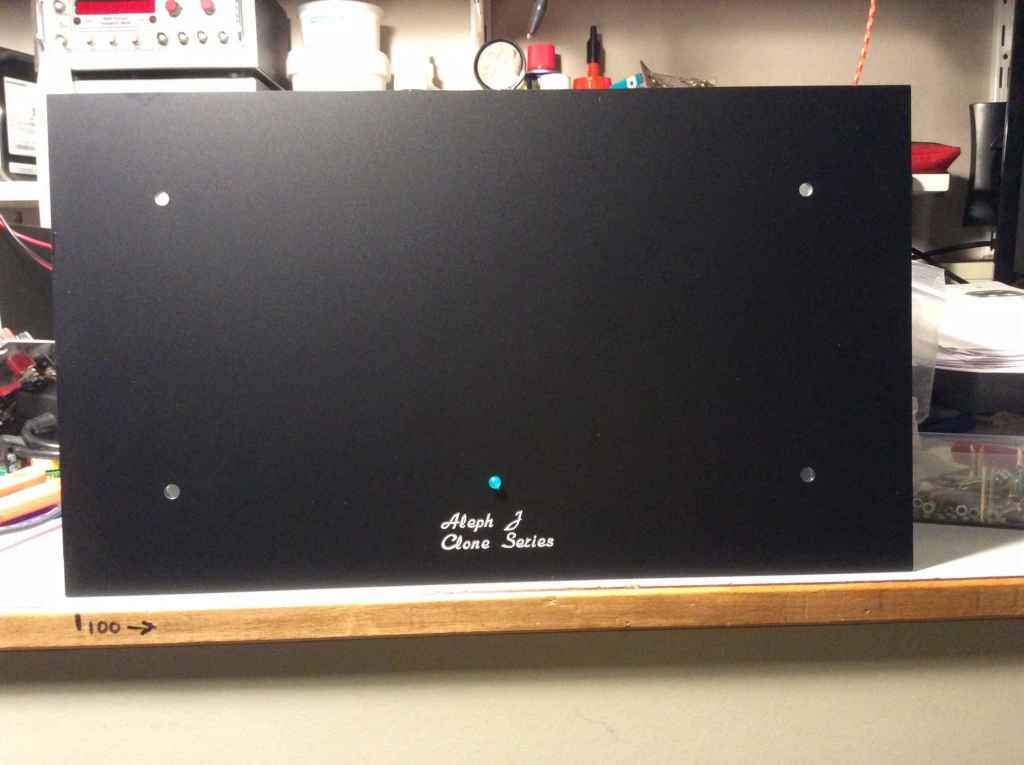

Another dutch Aleph-J nears completion.
Received my panels this week, assembly can start this weekend !
Better and complete photo's will follow soon.
Nick
Nick
