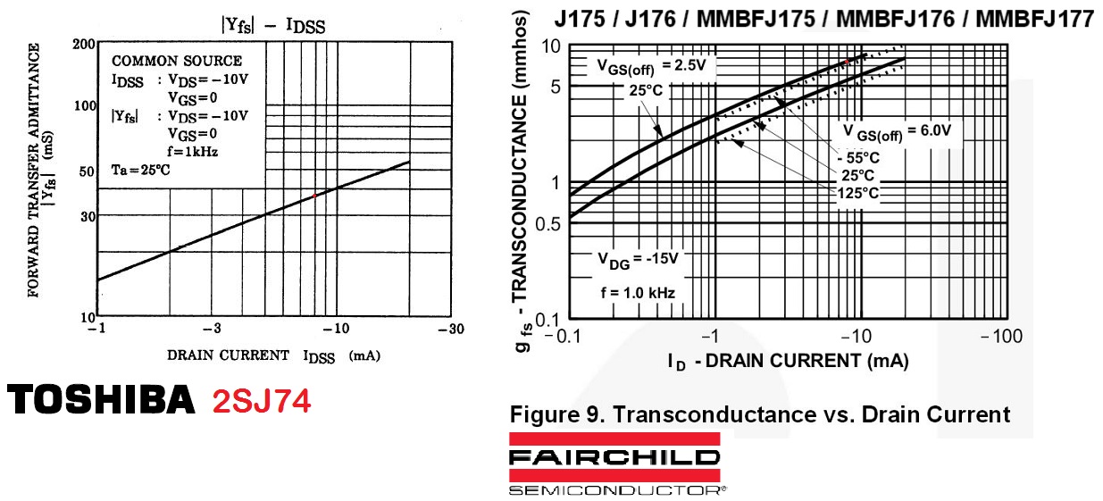

They might be lower in transconductance, but not sure.
Curious me, at which Idss value did you match them ?
(Noise figure in the J manual is 100uV, that's -89dB in reference to 2.83V Noise of the J176 is 20dB worse than the Toshiba part. Normally, a noise level of -69dB would be audible on your 100dB/W horns)
It is not a straight one-to-one match to the Toshiba J174, but a "C" level match and it is the only part in stock at Mouser that comes close to a J174. No noise at all, so far it works very well. Here is the Fairchild spec sheet for the J176. Can you tell what the transconductance might be for J176?
IDSS:
J176: -2.0 - 25.0 mA
Toshiba: -2.6 - 20.0 mA
VGS (off)
J176: 1.0 - 4.0 V
Toshiba: .15 - 2.0 V
Transconductance:
J176: ??
Toshiba: 8-22 Ms
Look at the datasheets.
At 8mA, gm is over 40 mS for the 2SJ74
For the same Idss value, gm range of the J176 is 5.5-7.5 mS
(that's a lot of lost gain)
Were you getting these numbers from these charts?
I am just wondering why in the Toshiba datasheet, the forward transfer admittance is listed to be typical 22 mS in two other places, yet in the chart, at -10 mA it plots to 40 mS.
Do you know?
Do you know?
