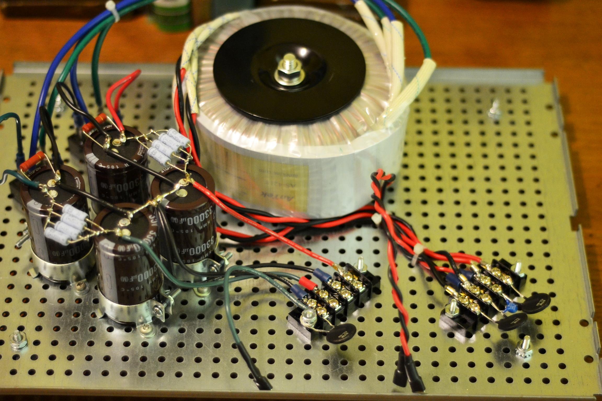

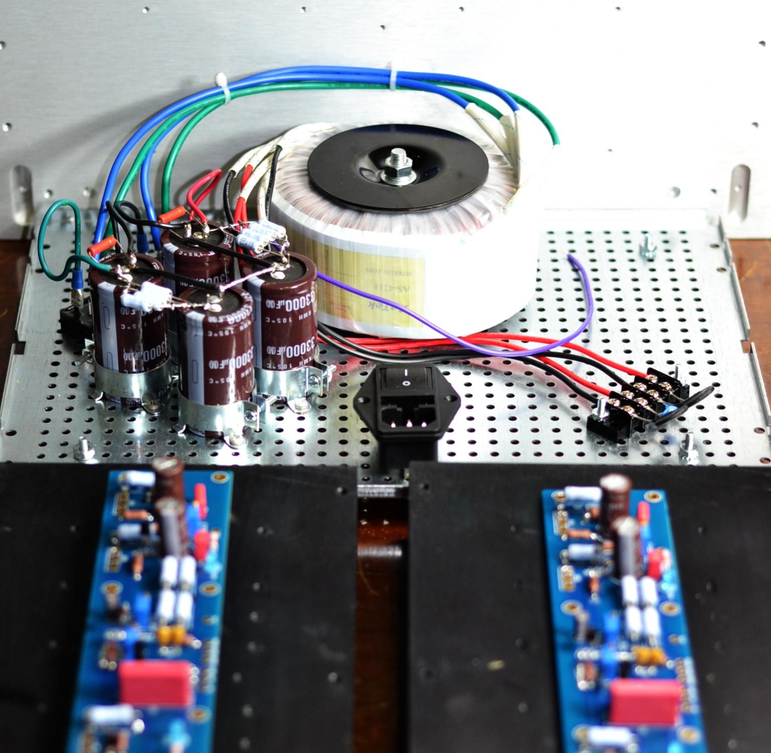

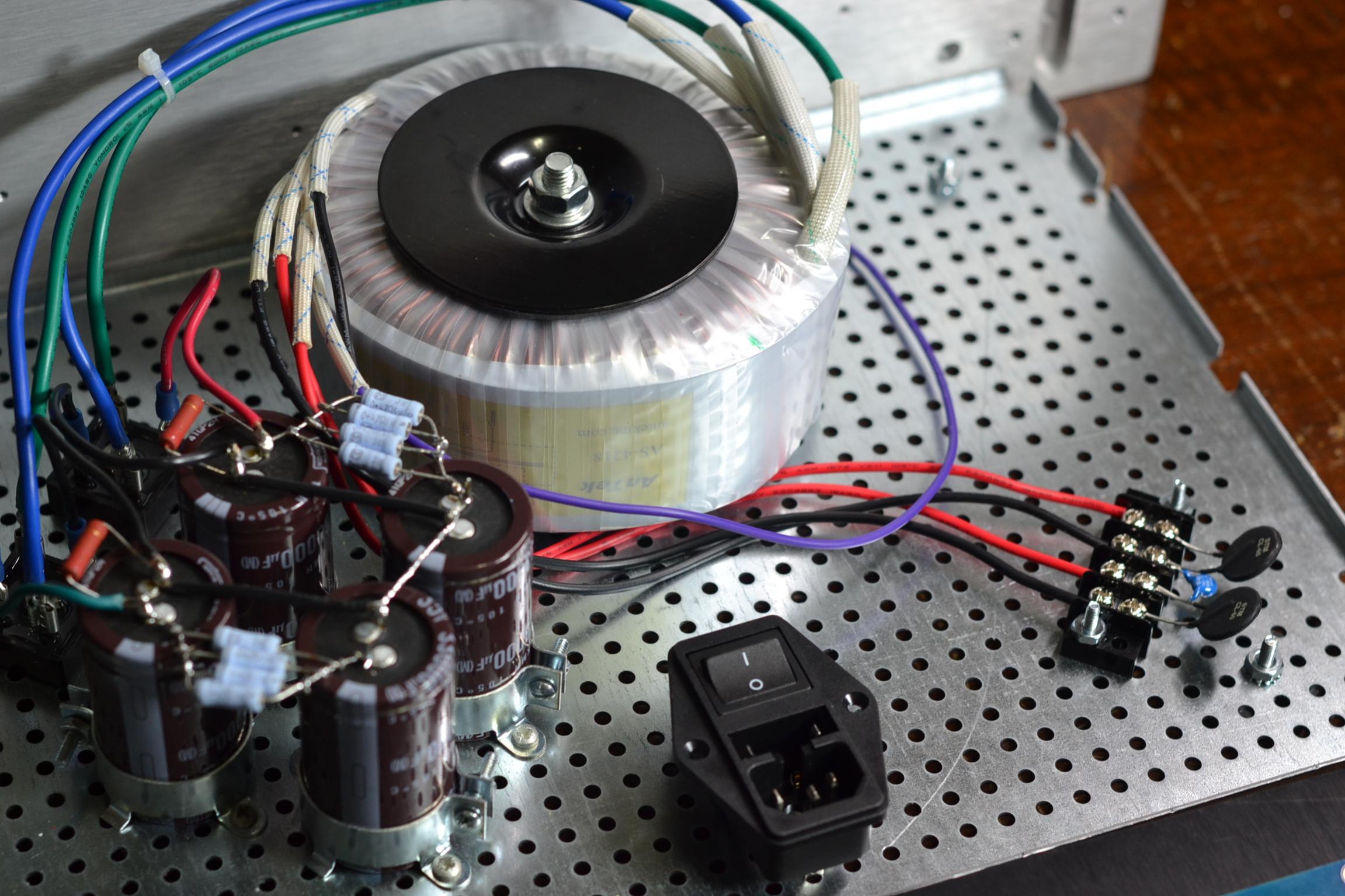

Got the Deluxe chassis yesterday, so I am just starting to put all the pieces together. Here is where I am. Does anyone know what to do with the purple static wire coming out of the transformer? This is a 400VA Antek.

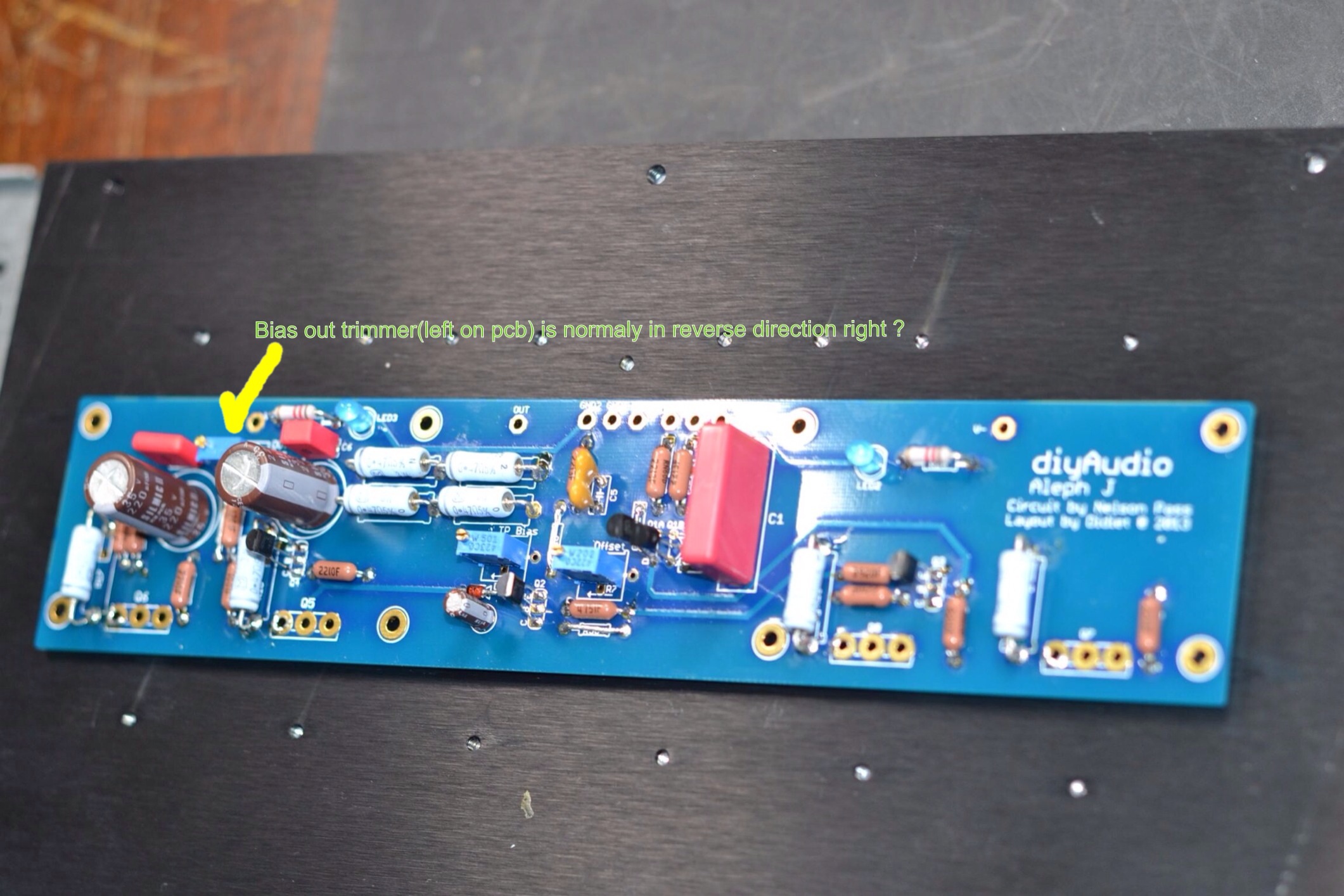

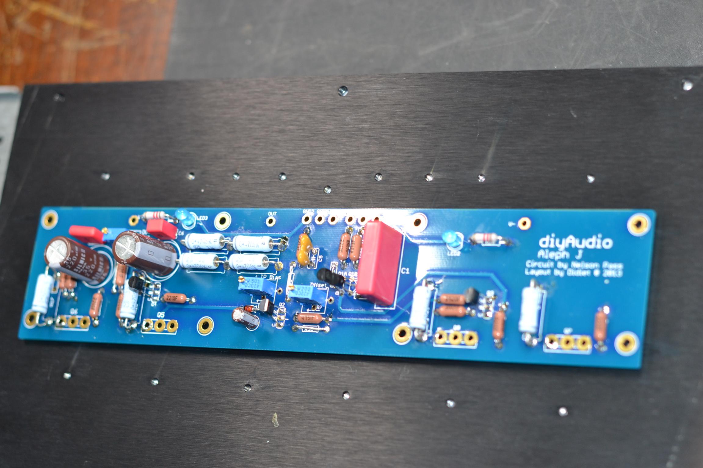

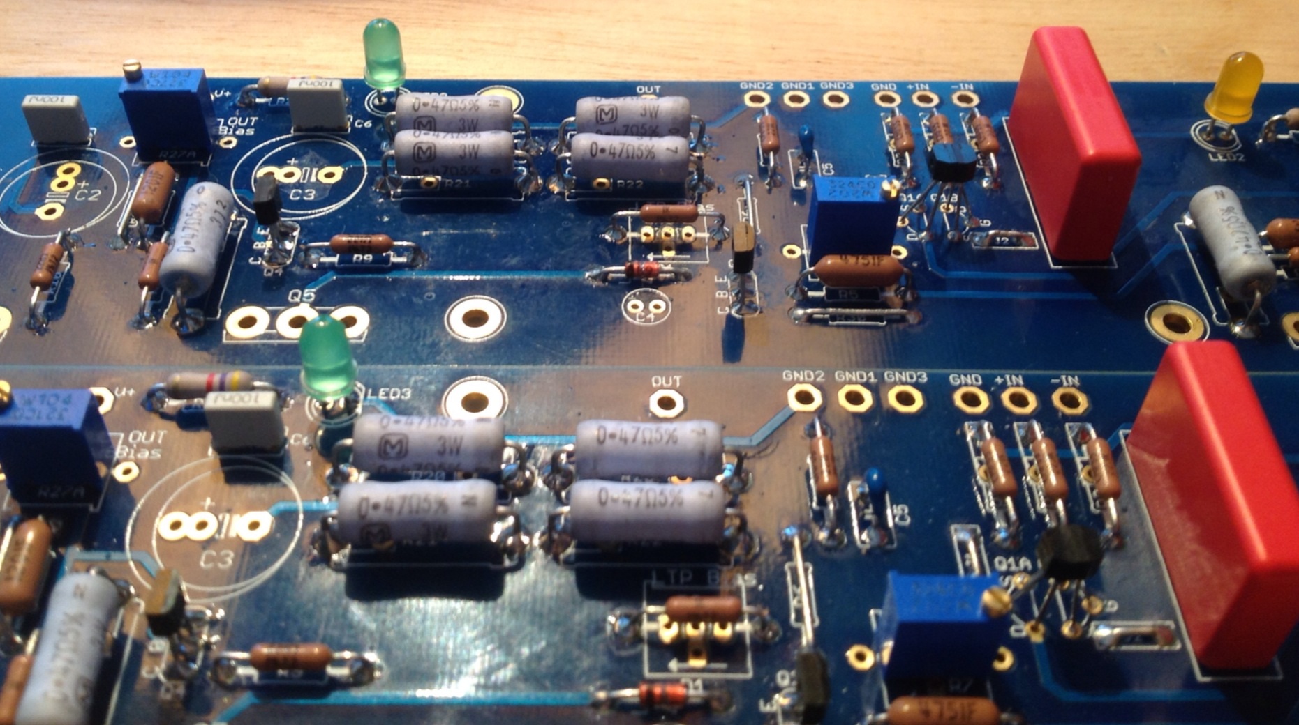

I am too in build process of Aleph J DiyAudio store pcb´s with 6L6 kit 😀
My pcb´s is 95 % populated but what is right position of radial bourns trimmers ?
This -> symbolise position of little screw pot to regulate ?
What resistances on trimmers before offset and bias procedure ?
That be more easy happy ending diy story thanks !
Best regards 🙂

I think it does not matter the direction of the pot. I just placed them with the label facing up so I know that I have the right one in the right place.
IIRC, the initial setting for the BIAS pot is 68K ohms. There are taps on either side of the pot to measure this in case you already installed it...
whaleman - set the pot marked 'LTP bias' to 1K, and don't touch it, or replace with 1K resistor.
EDIT - on second thought, it's all ready installed, so you can't read across it properly to set it...
Turn the pot all the way in one direction until it clicks, then turn the other way 12.5 turns.
Attach it to the chassis as close as possible to the transformer. It's the electrostatic shield.
Thanks, I did exactly that. I imagine it has some kind of purpose...
Thanks, no problem. I just replaced the pots with 1K ohm resistors...a snap.
6L6 and Whaleman great you be connected
i soldered 1kOhm and two trimm´s in real time with your councils.
Thx gentleman's
Vive le DiyAudio 🙂
Me too, we have good oversight here--thanks!
