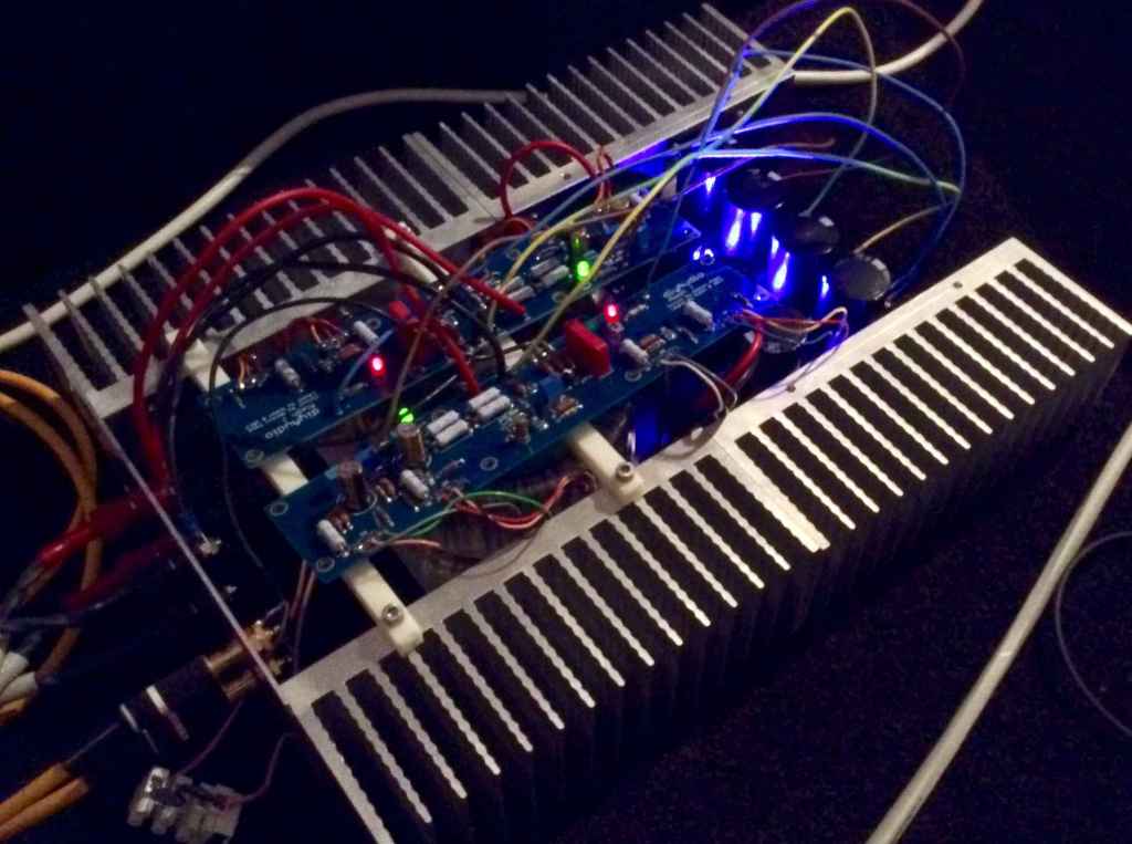

Yess, my baby is ready !
The amp is now running in test mode, no enclosure yet.
Current 0,65 amp/device, is that about right ?

Some figures after a few hours of listening
- 0,65 amp/device
- offset 0,002V
- 24VDC @ 500VA
- temperature is hot, but i can hold my hands on the heatsinks...... >> 5 secs
I heard some oscillation sounds for a few seconds during listening. It ocurred several times, but i guess that's due to the lazy wiring for this test setup.
(long wires to the mosfets)
By the way, sounds very nice !!!!!

Here a crappy picture of the amp working.
The heatsink were found "somewhere".
It looks like a SK102 to me, with about 0.45K/W
They get very warm, but i can keep my hands on 'em. So i guess it's okay !

If you can keep your hands on the sinks for >>5 seconds after an hour you have room to increase the bias. Crank it up!
