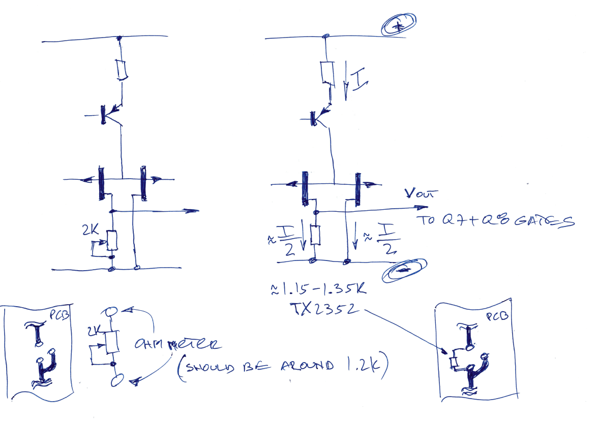

Hi Extreme_Boky,I was on holiday for a few weeks, so I had a day here and there I could spend on my hobby. So, logically, I looked at the Aleph J schematics again and considered what else I could do to improve the sound even further. The things I've done so far were a bypass of C1 with a copper link, removing a short circuit protection transistor and associated voltage divider resistors, and the work I put into decoupling power supply rails with polypropylene film caps and my favourite Black Gate N-type caps.
So, I kept looking at the schematics diagram hoping the Muse would strike... and then I realised that 2k trimpot that sets DC offset should be treated the same way as I/V reisistor in current-out DACs. What I had there before the mod, was a Bourns 2k trimpot, but I decided to find a suitable discrete resistor replacement to see what would happen with the sound. The more I looked at it, the more I wondered how the hell I didn't realise the importance of that 2k resistor before...?
So, I ended up using my favourite graphite film resistors, 1.2K each, 0.25W. And the result was mind-boggling. My kids thought that I bought a brand-new amplifier. What stood out was the speed, extension at both ends... and in particular the top-end extension in "all directions".
The resistor choice (carbon, metal film, Rhopoint (could be inductive!), TX2352, Holco...) would depend on your personal listening preferences and definitely on the rest of your system. I remember achieving very good I/V results with TX2352s, and TDA1541 / DDDACs... but in the case of Aleph J, the carbon films worked best for me.
So, if you do not have better things to do this 2024, put the above mod at the top of your list (of improvements).
I read this just now. By the Bourns 2k trimpot, you probably mean R7' for offset adjustment in the original Aleph J schematic?
How do you propose the new 1.2k resistors you mentioned to be installed in place of the trimpot?
Cheers, Walter
