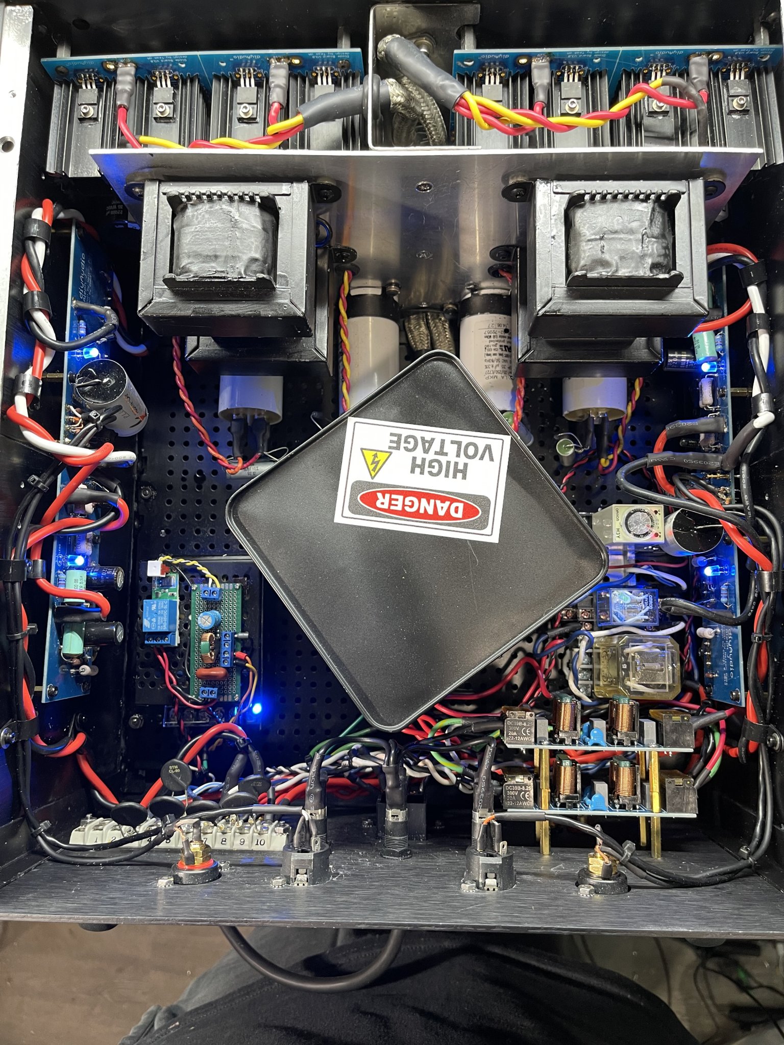

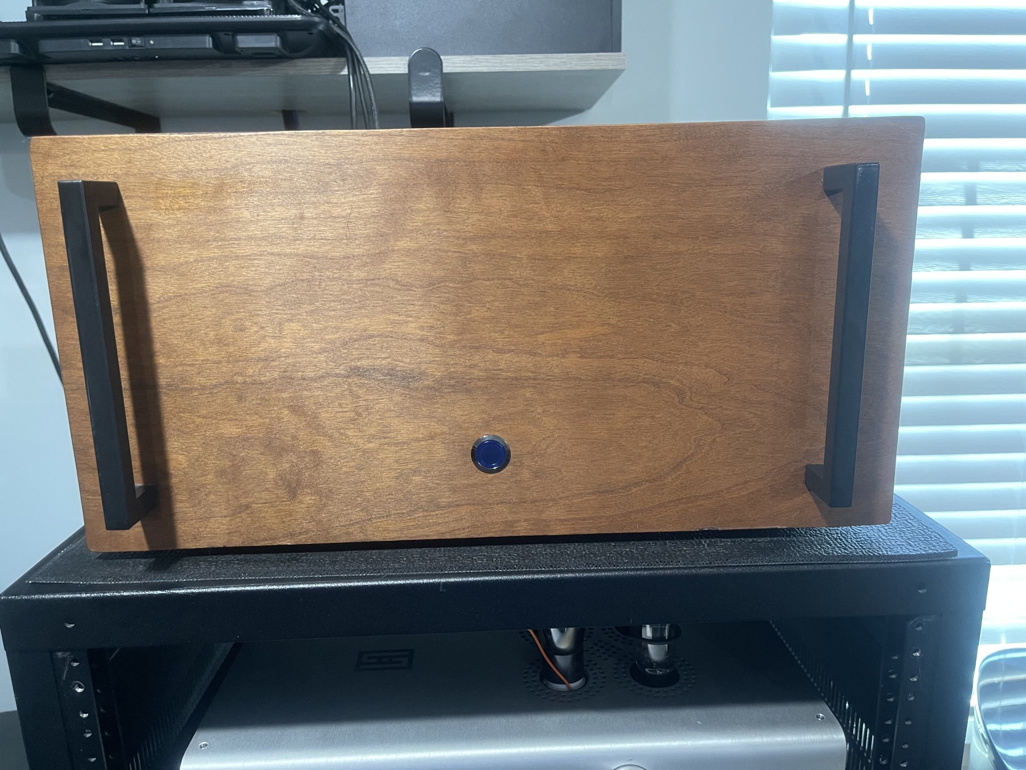

Well since I posted to the wrong thread yesterday (original needs deleted) I thought I'd try
again here. Amp is full mono except for power cord. PS is CLC bypassed w/motor run caps.
Under the cover is 2 Antek 200W 18V x-formers. It adjusted easily and now has probably 12
hours on it. It's also the quietest amp I've built bar none.
