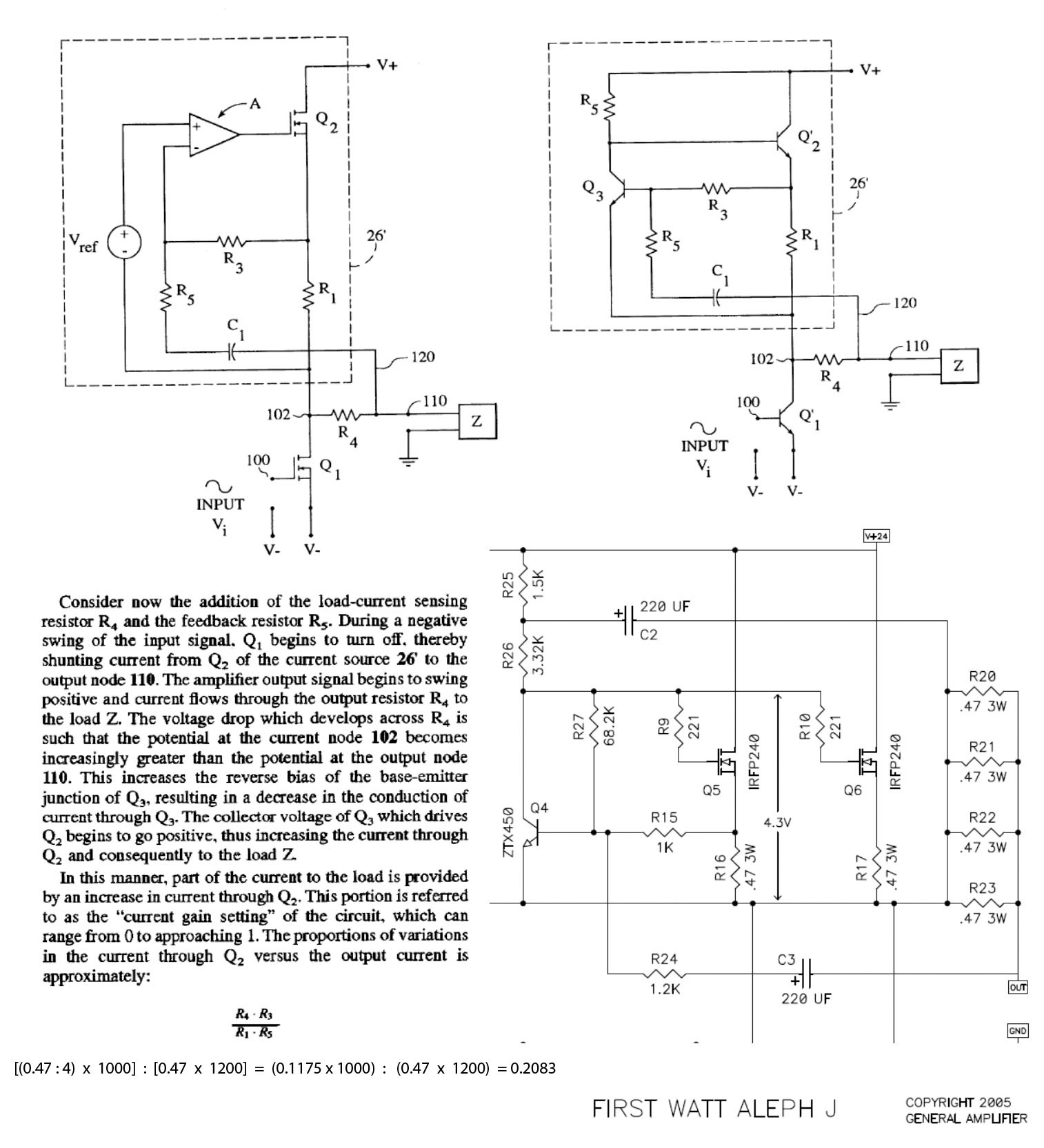

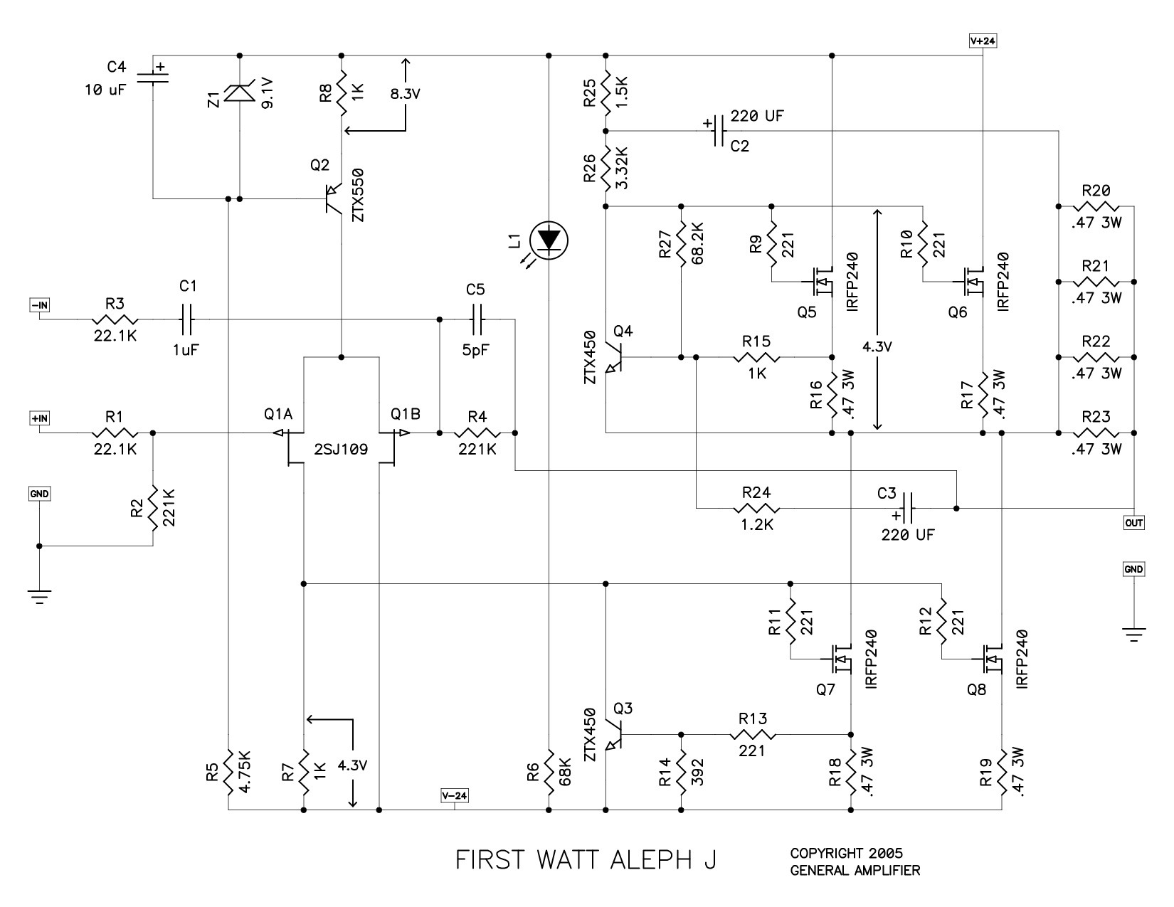

Has anybody a professional idea why I must take 15k for the bias resistor R27 instead of the 68k, what is the dependency?
I am pretty sure that you have seen these already. Approximately 2 years ago, I extracted important bits from a few sources and created one jpg file. Have a look and see if you can find something useful.
There's also Nelson's paper on the current gain in Alephs... but I am pretty sure you've seen that one already.

Yes, I know these articles and I can determine the 50% contribution of the upper IRFP. It did it the last years already some times.
My interest was this time to chase the neg phase H2, even when the 50% rule is injured.
Nelson spoke in connection with the Aleph amps not about the aim to get H2 neg phase, hope I am right.
But maybe the 50% contribution rule may include normally the neg phase H2.
But unfortunately not in my case.....not yet.

Which resistor(s) # should I be measuring AC? 11 and/or 12 on lower rail, 9 and/or 10 on upper rail? Sorry, not so hot on following solid state schematics, tube schematics are a different story.measure voltage AC across source resistor in lower rail, write down
measure voltage across AC resistor in upper rail, write down

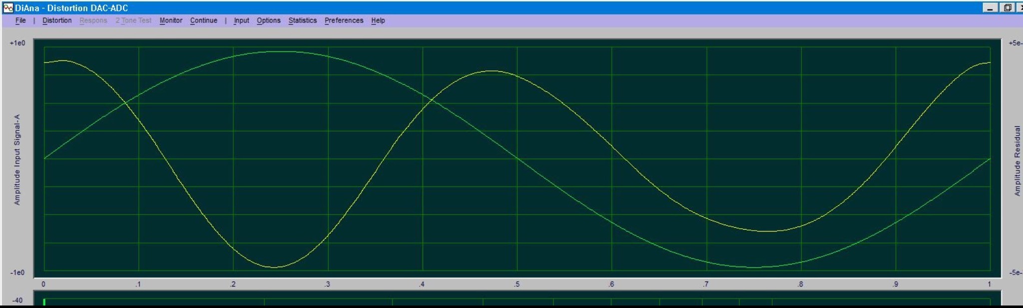

Meanwhile I have strong doubts if my way to determine the H2 neg Phase with my sound card an Diana works as intended......
So do not take my last posting serious, maybe the fault is not in handling but in hard- and software.
Maybe someone can repeat for me the correct way to see the H2 phase with REW? I know if shown +90° it should be negative, but if I remember correct, the was a posting that his 90° suffix + or - depends on the fact the amp is inverting or not. Correct?

I have compared the results from DiAna and REW, and positive phase H2 is -90 degrees in REW. This was done with an amplifier that I knew had positive phase H2.
As for inverting or not, REW does not know. It only looks at the amplifier's output and determines whether the distortion is in or out phase with respect to the fundamental signal.

Here is negative H2 with DIANA as an example. It gets more tricky as the distortion goes down and H3 is more pronounced. Hope this helps
:--))Thank you all for your help!
Is there anybody who can measure or show his residual result made with AJ and using a sound card and Diana?
With normal values for R24 1k2?
