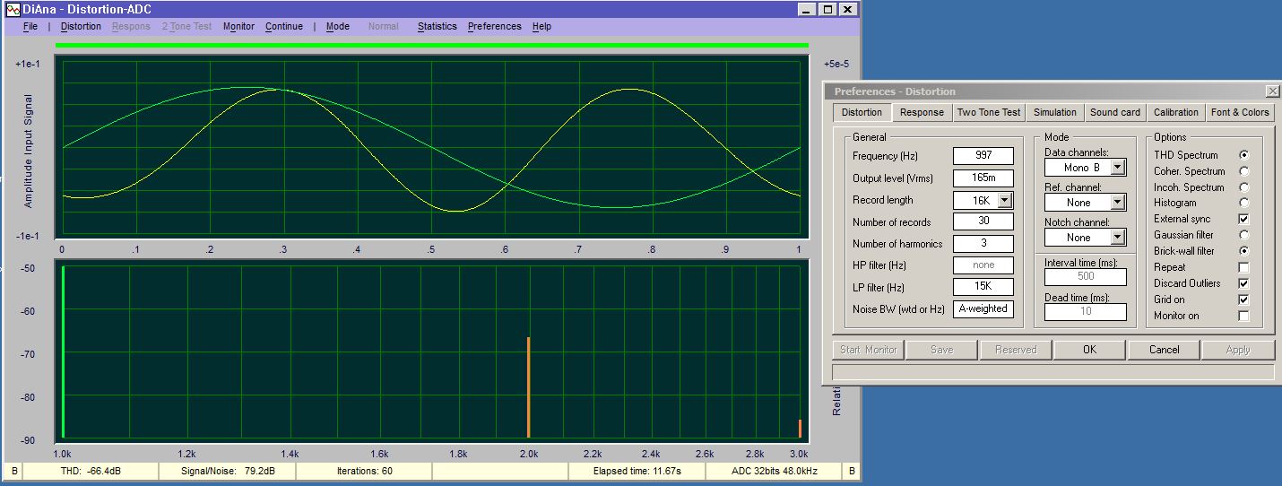

The I used REW first and my Focusrite to get an Impression of THD Pattern. All was fine with one side, 0.034% at 1W/8Ohm and H2 about 20dB higher H3.

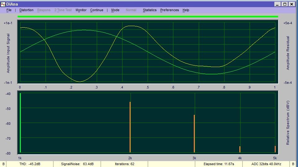

The other channel showed a high distortion of 0.26%. So what? My suspicion was some oscillation and indeed touch with two fingers the both ends of the R27 made the distortion go lower.
I placed a 100pF cap parallel to the R27 and distortion went to the same 0.034%. Fine!
Forgot to mention that I had to go down with the R27 68k to 15k to get the 0.4V over one 0R47 source resistor. I will come back to this point later.
Now it was time for Diana to see the residual.

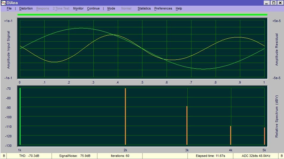

I hoped to have the neg phase H2 with the R24 Aleph resistor 1k2, this was not the case nice pos phase H2.

So what? I had in Spice neg phase H2 with 2k for the R24, but not in real, still pos phase. Spice predicted the change from 68k to the 15k for R27, but for the phase Spice was not correct.
So I went down with the value a mix of 510R and a 500R pot was soldered. Astonishing how sensitiv the 10 turns pot trimmed the residual.
Nearly a matter of Ohms....!

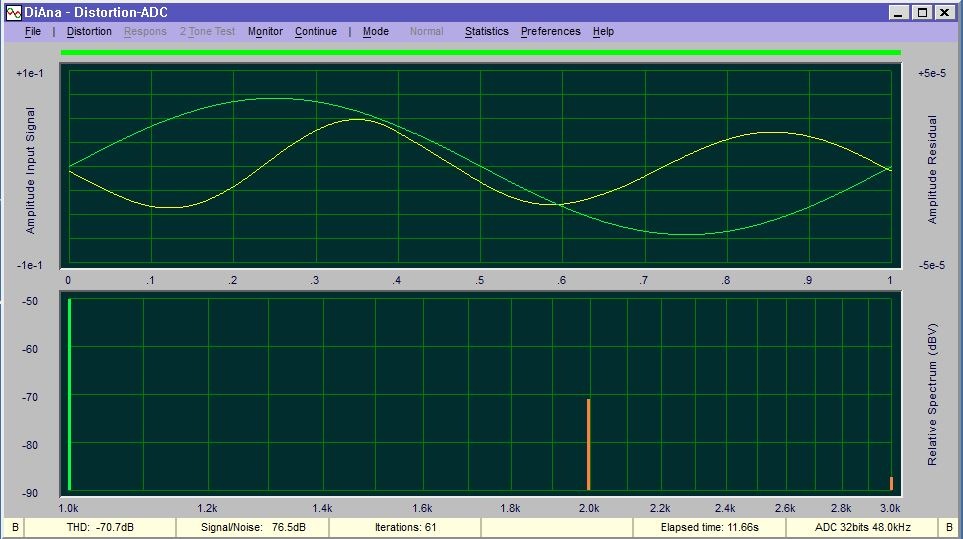

coming nearer with 640R

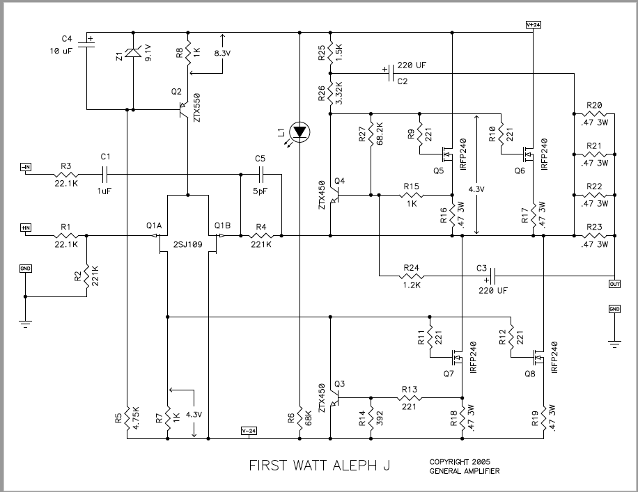

So some thoughts.....
I think the 1k2 value for the R24 is only adequate for a certain transconductance of the lower IRFs. This could also explain the Nelson gives us the value of 4.3V at the 1k R7 for a bias of 1.6A around.
My IRFs seem to have a lower transconductance, I needed around 5V to get the 1.6A.
Is it possible that this is also the reason for the need of my lower Aleph resistor R24?
So I can only recommend, the you have a curve tracer or can measure your IRFs in another way for the Vgs at 0.8A you might be more on the save side.
Mixing the IRFs without matching will it make possible very difficult to chase the neg phase.
Looking again at my IRFP240 curves from the curve trace I think the 5V I mentioned are funny .... I will measure again, tomorrow.

Has anybody a professional idea why I must take 15k for the bias resistor R27 instead of the 68k, what is the dependency?
Now its time for Jazz concert in town!
presume is that there is one Vbe across R16, corrected with pull-up action of R27
so, some say and count that Vbe is 600mV, some say and count that Vbe is 650mV, some say and count that Vbe is 700mV
in first case, that's 1A276
second case 1A383
third case 1A49
far from professional idea ........ but let's say that everything counts in, variation of mosfet Ugs, beta of small TO92, tolerance of 0R47, value of (sum of) R25 and R26
who cares, as long you're able to set it
