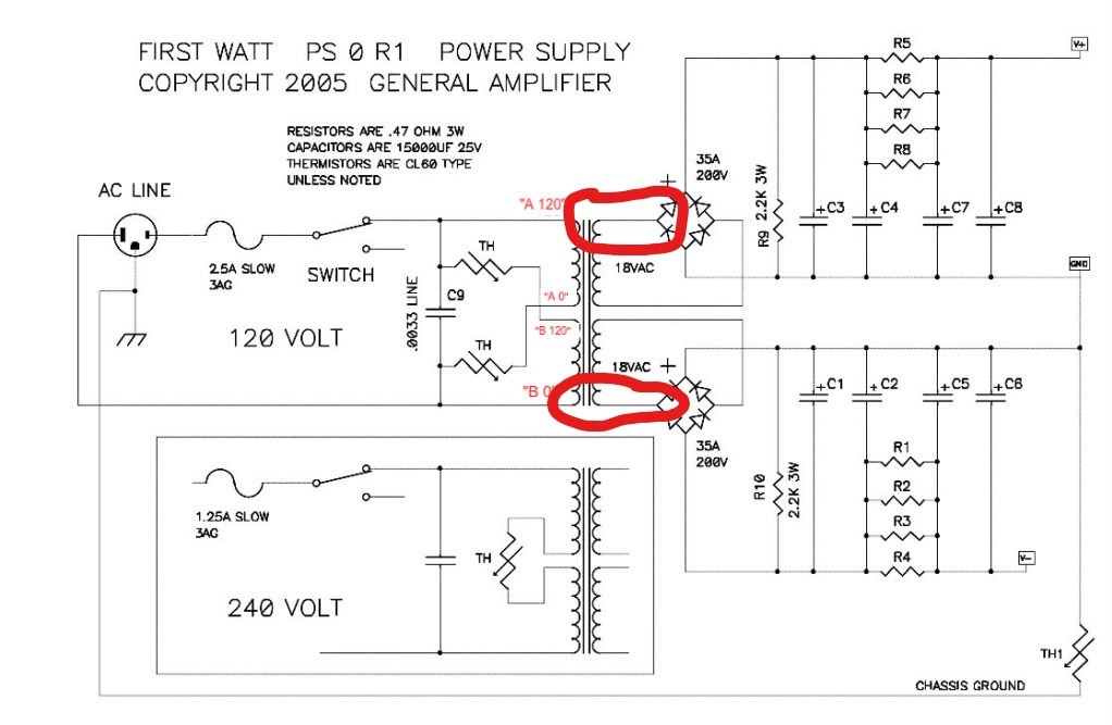

I have a question regarding the wiring of the secondary windings of the transformer to the monolithic bridges. From the schematic of the F6 power supply (I assume that the same wiring works for the Aleph J) (by the way, I am using the universal power supply pcb along with monolithic bridges), it looks as if the upper (or dot) end of the top winding is attached to the terminal to the left of the DC + terminal on one bridge and that the lower (or non-dot) end of the bottom winding is attached to the terminal to the left of the DC + terminal. However, in all the photos of builds by diyaudio members I can find, it looks as if the dot end of each winding is attached to the left of the DC + terminal (see sample photo of one such build). Does it make any difference, which end of the coil is attached to the left of the + terminal? Thanks for any help anyone can give me,

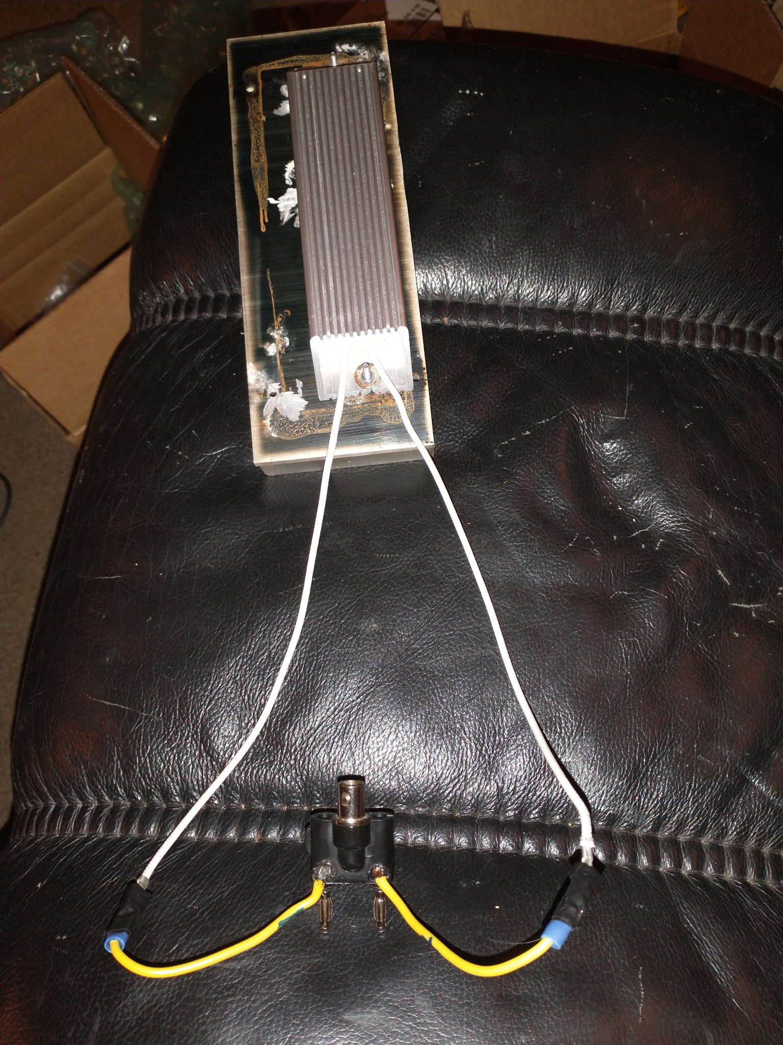

I bought a cheap oscilloscope to play with, and made this dummy load out of a 100 watt 8 ohm resistor attached to a heat sync and attached to a banana to BNC adapter so I can look at the output of my amps. I am using a BNC cable to to go into the oscilloscope in place of a probe, so this thing becomes the probe.
I've used it on my F6 to measure where clipping begins and looked at the harmonic distortion levels with the scope's FFT and it all works fine. However, I read somewhere a long time ago that special care must be taken when hooking up an oscilloscope to a differential amplifier because of something to do with grounding. I think the Aleph J is a differential amp. I am using the Aleph J with single ended input only.
Is this thing safe to hook up to the outputs of the Aleph J?
Is it safe to hook it up to the outputs of a differential bridged amplifier?
I don't want to destroy anything.
Thanks,
Alan

The dummy load is okay to use with Aleph J. If you have 2 dummy loads, you could load both channels at the same time AND you could monitor both channels with the oscilloscope. No need to worry about 2 probes having the same common.
The dummy loads are okay to use with a bridged amplifier as well; HOWEVER, you will need differential probes to monitor both channels at the same time on the oscilloscope. Otherwise, the probes' common returns would short the bridged amplifier outputs... because with a bridged amplifier, the negative speaker terminals are NOT sitting at the same potential.

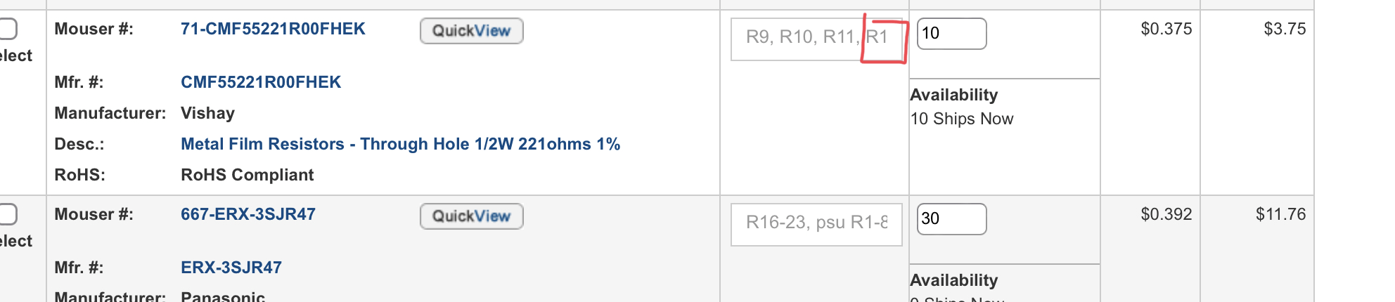

Hey Everyone - Im using the Blogspot build guide. R1 for the amp boards shows up twice in the saved Mouser cart. The values are different.
https://www.mouser.com/ProjectManager/ProjectDetail.aspx?AccessID=35ACFA214D
Is that just an error? Which of the two should I use?

You can check against the BOM. The R1 for the PSU is different - it’s the 3W. Also the customer field for the 221R resistors get’s cut off. It’s 12, but looks like 1 on the website.Hey Everyone - Im using the Blogspot build guide. R1 for the amp boards shows up twice in the saved Mouser cart. The values are different.

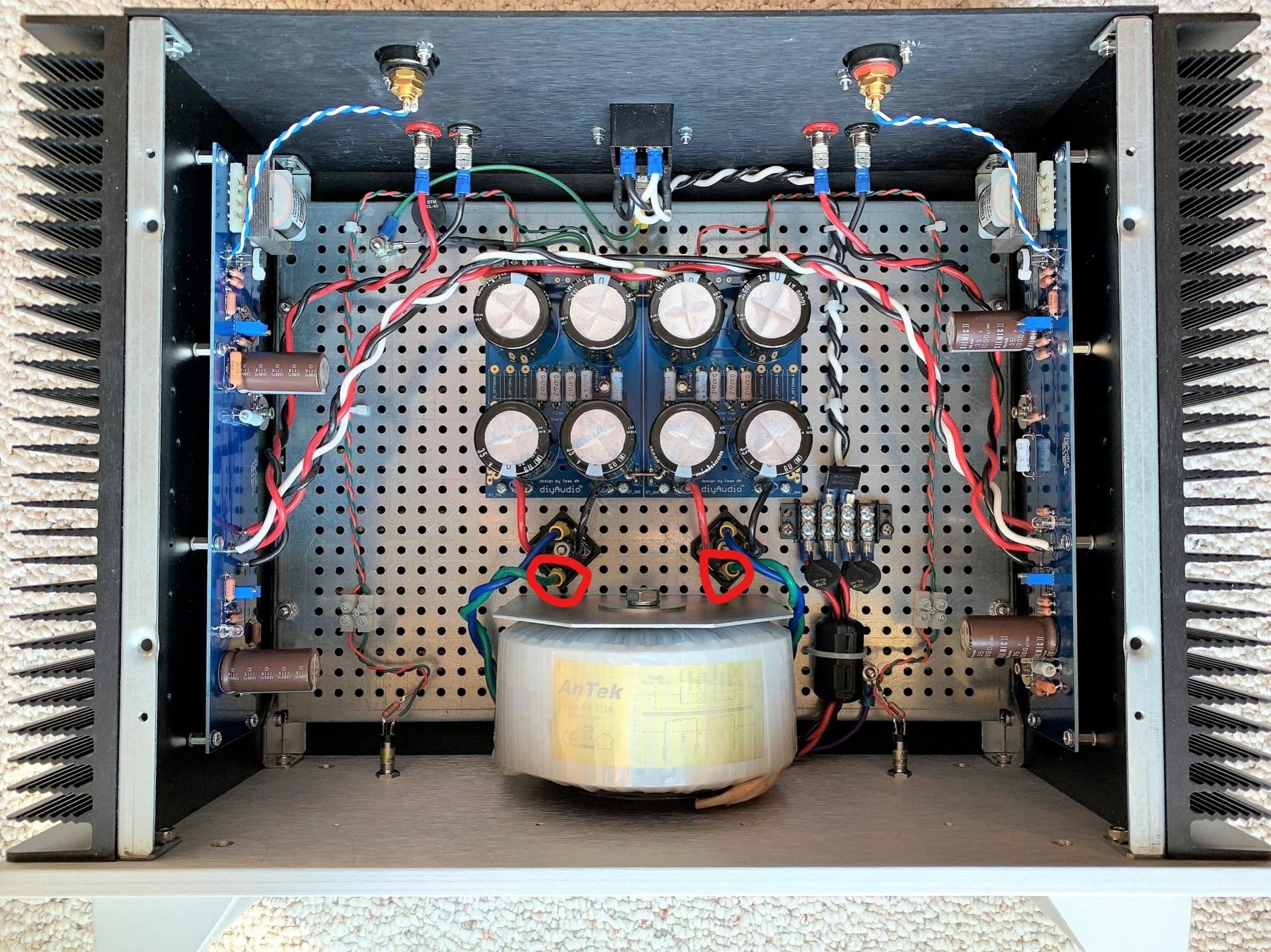

Successfully powered up and biased two channels (one at a time of course) using a lab power supply. This build started six months ago and has been worked on intermittently. Apparently I never set the pot at R27 to 68K, so bringing the voltage up to just 5V increased voltage across R18 to .5V. After some fiddling with increasing resistance on R27 and then slowly increasing voltage, I finally got to .4V on R18 at 24V.
I had some fun playing around with voltage and bias to see how it effected output and distortion. Turning the supply voltage up to 30V and biasing at .45V seemed to give good results. Not sure if it's a good idea to run it this way when installed in it's chassis...but I'm willing to try it. The heat sinks run at about 50C, but the source resistors run 56C. Is this a problem for those resistors?
