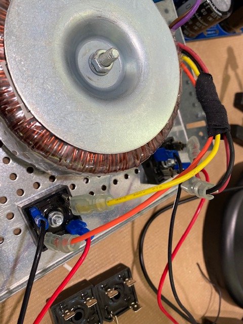

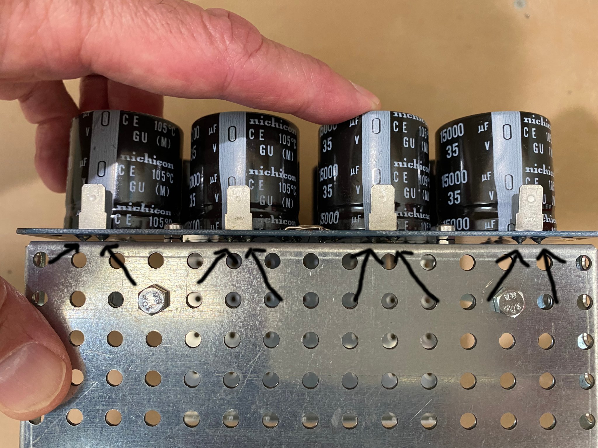

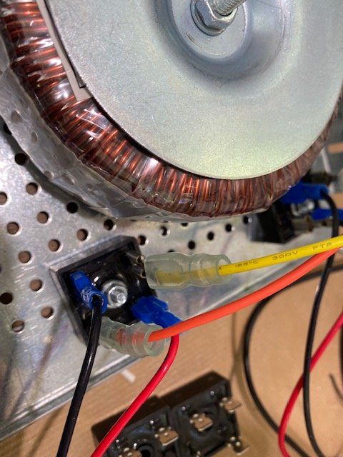

I appear to have blown something when testing the PS. I hope someone can give me a little guidance. I am building Aleph J monoblocks with the DIYAudio universal power supply. I wired up the power supply for the first block. Using the dim bulb tester, the bulb did not dim and I turned everything off. In looking at the PSU board, I noticed that I had it set up such that all the power inputs to the board were shorted. I managed to inadvertently do that by placing the board on top of a riser panel set up over the transformer. The first picture shows a top view of how I thought I had it set up. Unfortunately, i had removed and replaced the PS pcb several times in wiring it up and inadvertently placed it not in the middle of the top riser plate, but on the edge, effectively connecting all power inputs together (see second picture).

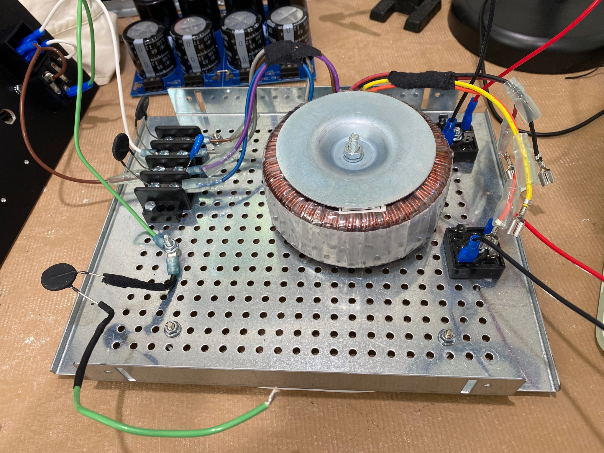

After observing my incredibly stupid placement of the pcb, I moved it where it should have been (as shown in first picture) and tried again. This time the bulb dimmed then went out. I was reading no voltage on the outputs of the universal power supply board. I unhooked the power supply board and tested just the secondary coils of the transformer. The bulb did not light, but each coil measured 20 volts ac. (The transformer is supposedly 18-18 volts.) I then tried measuring the output of the bridges. Before powering on, my volt meter displayed some milli voltage on the bridges, when I turned on the power, the bulb did not light and the meter immediately went to OL. I tried wiring in the second set of bridges, but got the same result. (I also changed the bulb in the dim bulb tester to no avail).
My next step would be to buy 4 new bridges and try again. Does that seem like the correct next step? Also, is there some way to check the Universal Power Supply board to make sure I did not blow any of the capacitors? Should I also get a new ps pcb and capacitors etc? The final picture shows the transformer wired up after I removed the ps pcb and disconnected it from the bridges. Any help would be appreciated.
Your bridges may still be ok.

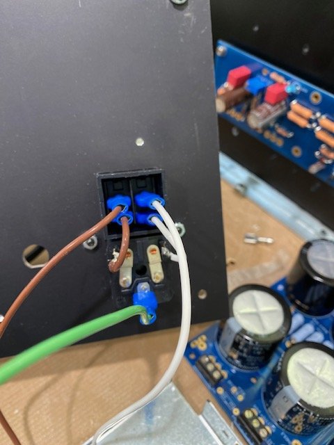

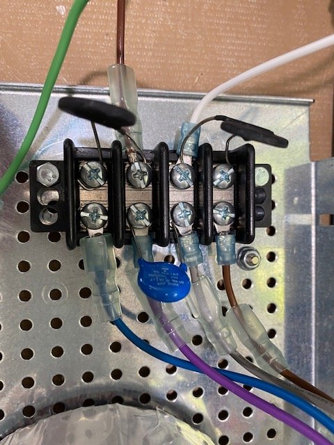

However it's impossible to assess your wiring based on your pictures. You need to post pictures that clearly show the connection of wires to the board, recitifers, transformer, AC power, CL60s., etc. Overhead shots of the complete circuit so that all of the wiring can be traced and verified.

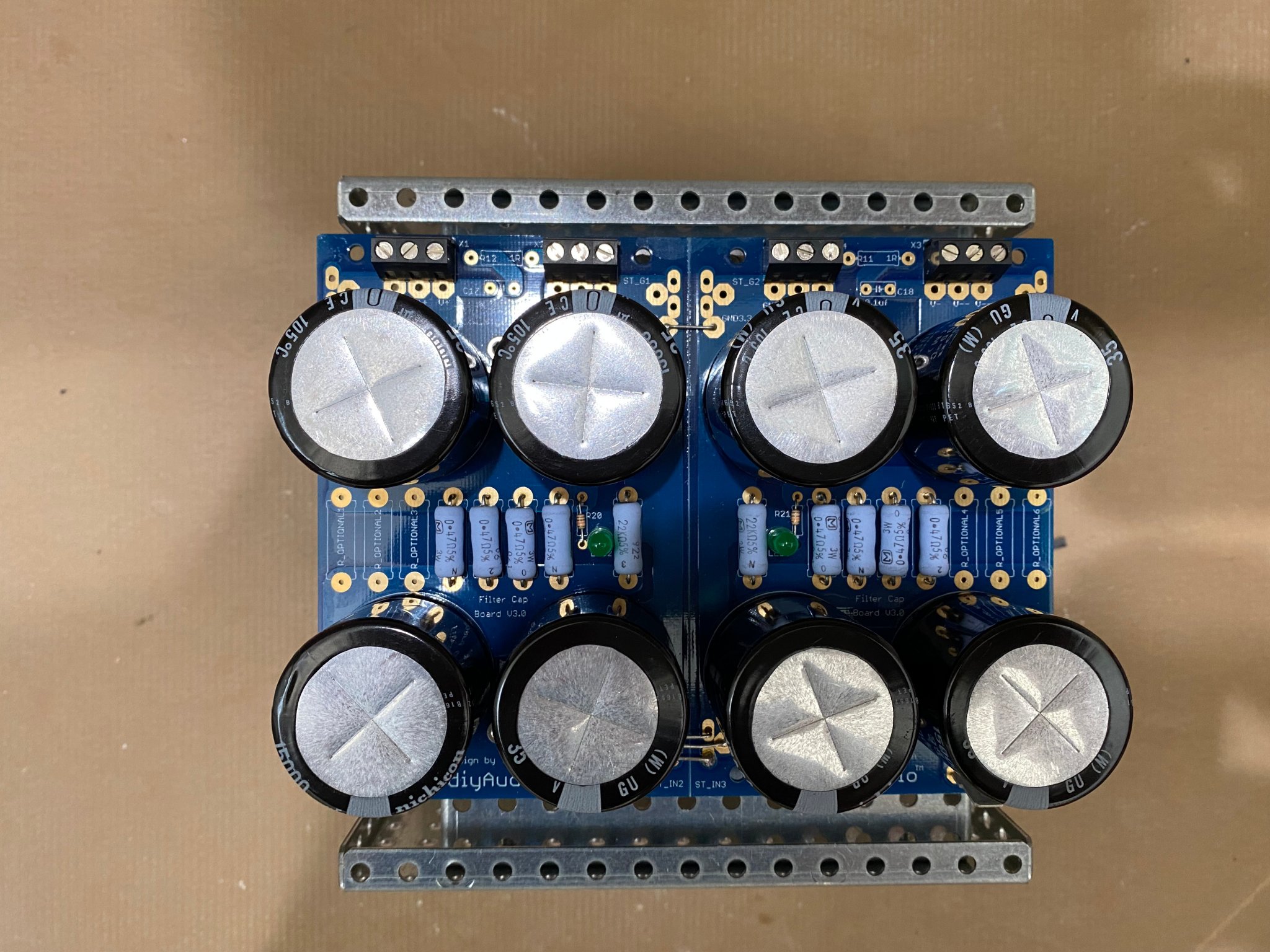

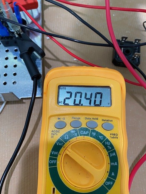

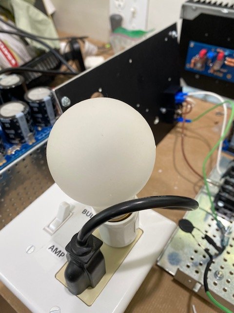

The best way to build the power supply is to do it in stages and test each stage.
Connect the AC from input to CL60s and power transformer. With dim bulb tester in place, power up and measure the AC voltage at the transformer secondaries. If dim bulb tester is dim and there is AC voltage, that is good.
Next connect the secondaries to the rectifier bridges. Is there DC voltage at the output of the rectifier bridges? If yes, that is good.
Next connect rectifier outputs to the PS board and power up and check.
At all stages check and double check that your wiring and connections are correct. Make sure AC is connected to the AC input of the rectifier bridge and DC positive and negative out of the rectifier bridge are connected to the correct points on the PS board. When connecting the transformer secondaries to the bridges, check that you have paired the secondary wires correctly.

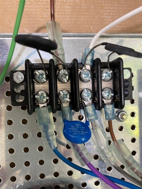

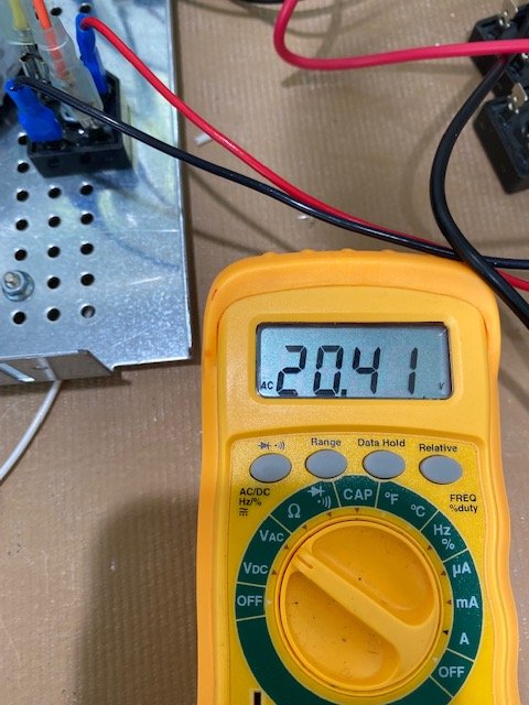

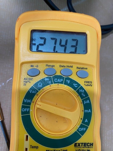

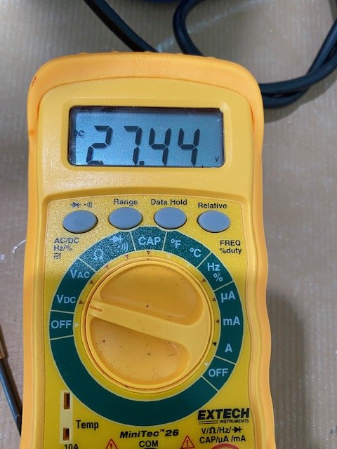

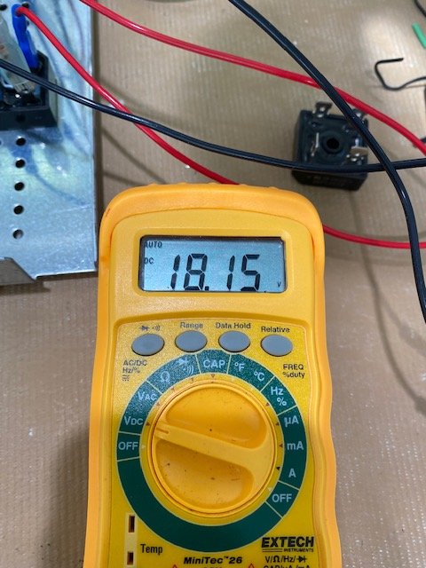

What voltage range was your meter set to? Or is it auto ranging?when I turned on the power, the bulb did not light and the meter immediately went to OL.
Thank you Ben Mah and KevinHeem. I have a feeling the OL resulted from my meter being out of range. Ben Mah, I have attached pictures showing my wiring (I intend to remove the shrink wrap from the legs of the CL60 as I understand they may get very hot - I will try the ceramic block that the Noob Guide shows). I tried measurements as you suggested. First, with the PS pcb unattached, I measured transformer secondaries - I got 20.4 ac. I then measured the output of the bridges - I got 18.19 and 18.15 dc. The bulb never lit. I then hooked up the ps pcb, the bulb lit and dimmed to nothing - I got 27.43 negative on one set of outputs and 27.41 positive on the other. I turned it off between measurements to relocate the test probes and when I turned it back on the bulb did not light but I got similar readings.

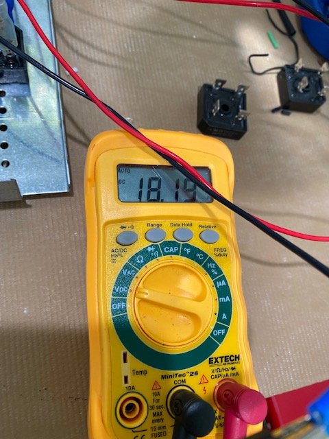

I am confused about the 18 volts out of the bridge and 27 volts out of the ps. Should I take those again?
Anyway it appears that it might be working, but I wonder why my dim bulb tester dims to nothing and then does not light. Any thoughts?

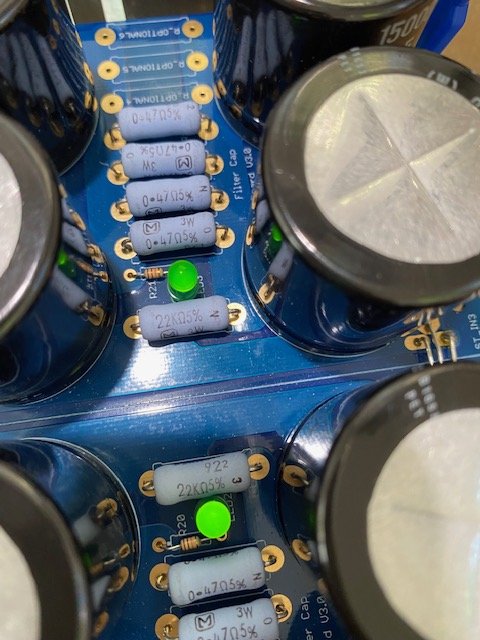

When only the transformer is connected and when only the transformer and rectifiers are connected, there is no load connected so the bulb not lighting is correct, as there is no load to draw current. So it is working properly.
The voltages look good too. With the rectifiers connected, the voltages are lower because there are no capacitors.
Then with the capacitors in the circuit, they charge up and increase the DC voltage. The bulb lights up as current flows to charge the capacitors. Once the capacitors are charged, the current flow stops and the bulb goes dark.
The voltage of 27V seems high but that will drop once the amplifier boards are connected and draw current from the power supply.
It looks like your power supply is working correctly.
Now when you connect the ampliifier boards, only connect one board at the beginning, and of course use the dim bulb tester. Only connect the second channel once you have the first channel working properly.

and remember to remove bulb thingie, when commencing actual setting of amp
it's there "just" to save you of fireworks
