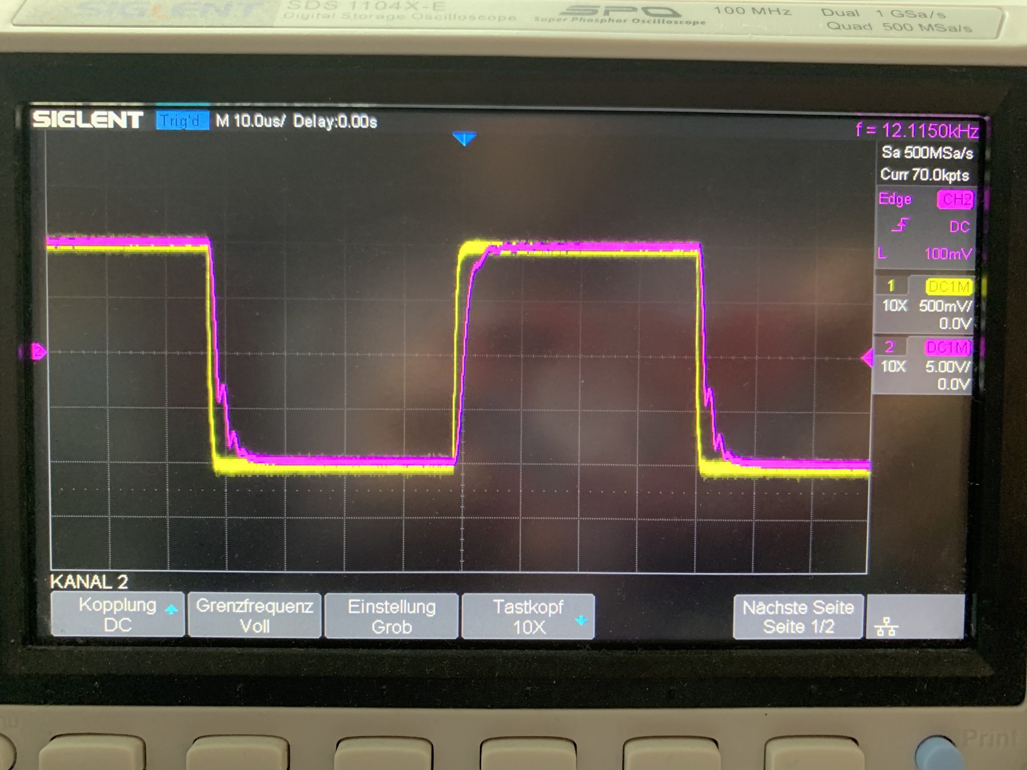

So, after completing and setting up my two Aleph J boards I threw some stuff from my signal generator at the boards, with an (to my eyes) odd result: looking at a 10kHz square wave, 0.5V input (neg imput to gnd), no load at the output, I see the expected round off of the raising edge of the wave, but also two small humps(?) on the falling edge. Same on both boards, which otherwise behave nicely at 0.85A bias.
Any idea what causes those ditches on the falling edge at the output? (yellow is input, purple is output)

Have you tried with an 8 Ohm dummy load @ the outputs? Perhaps it will look different?
