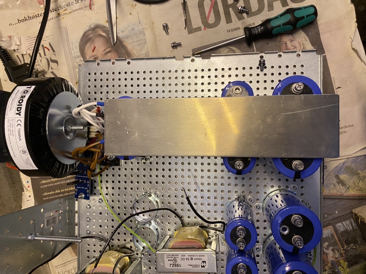

Couldn’t resist the ground plane idea. Hand cut, filed, and ready for drilling. Maybe make a trace in the middle from first to second set of caps, but will try like this first.
0v take off at the back, in the middle, geometrically far from the currents between halves. Excited. Sloow, steady.

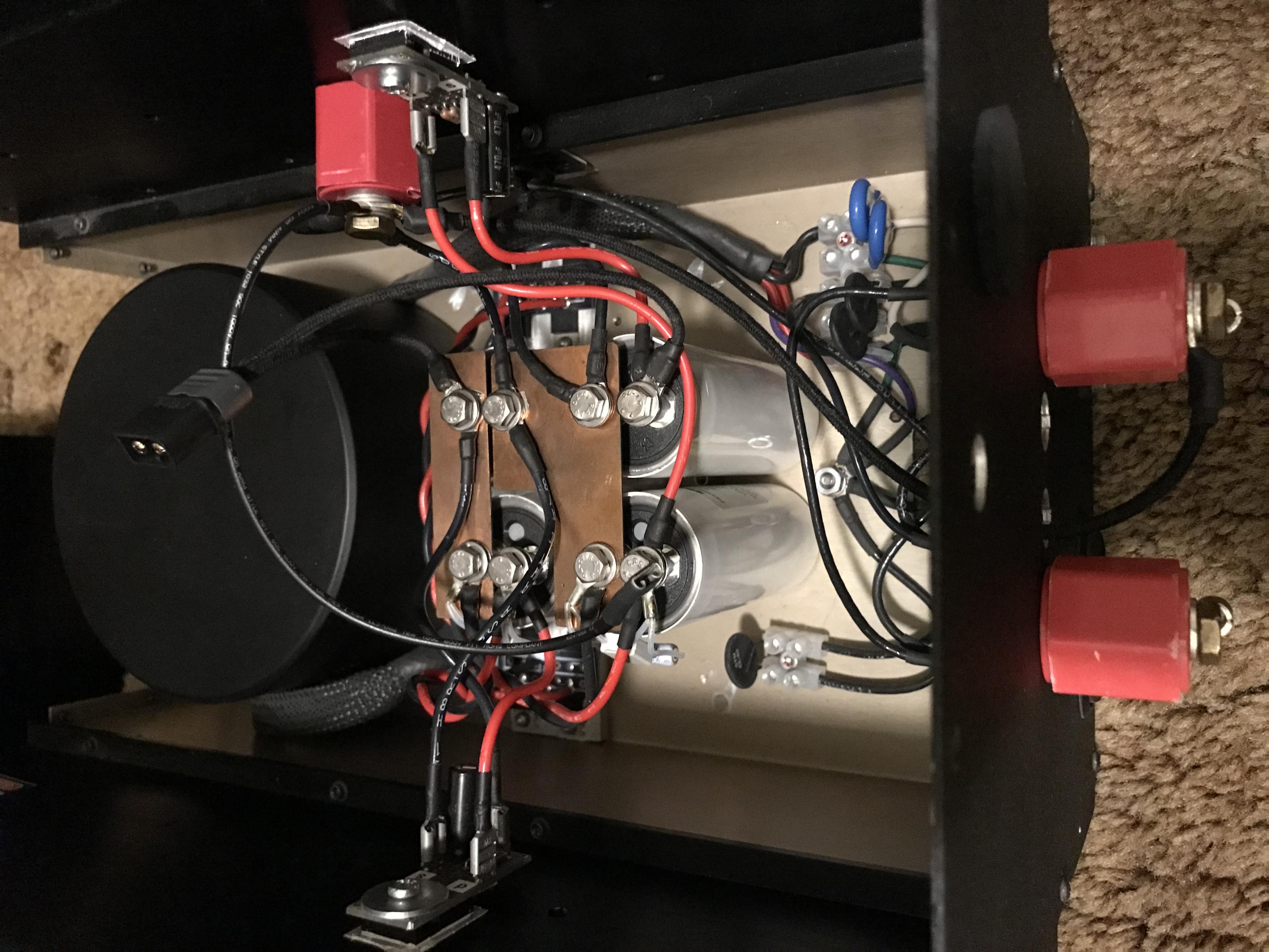

This is how I did mine years ago. Juma's cap multiplier circuit. Red insulator on the side is the main star ground. Picture is kind of a sneak peek of my SissySIT rework, binding post delete, coupling cap upgrade, and some other small tweaks I've been meaning to do for awhile...
