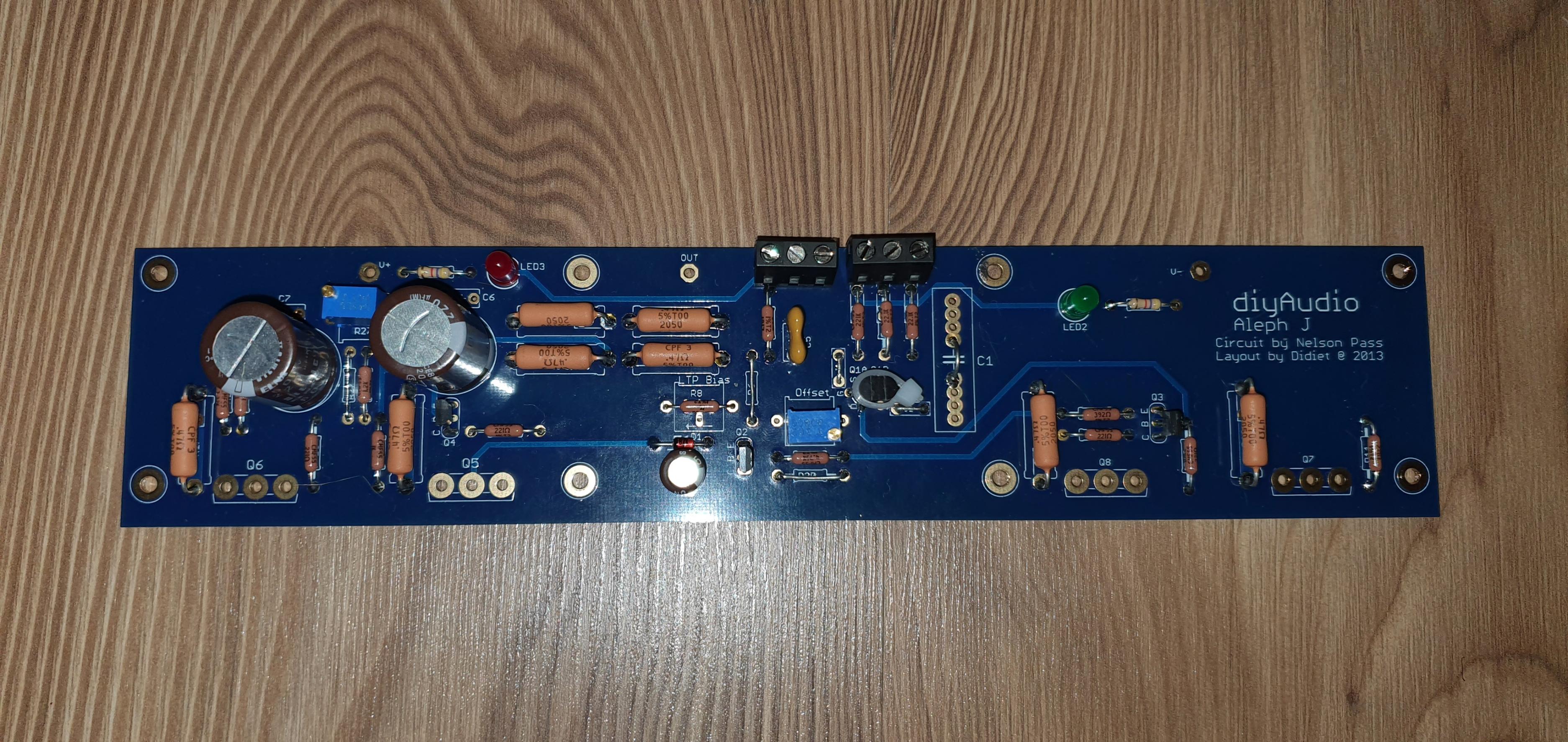

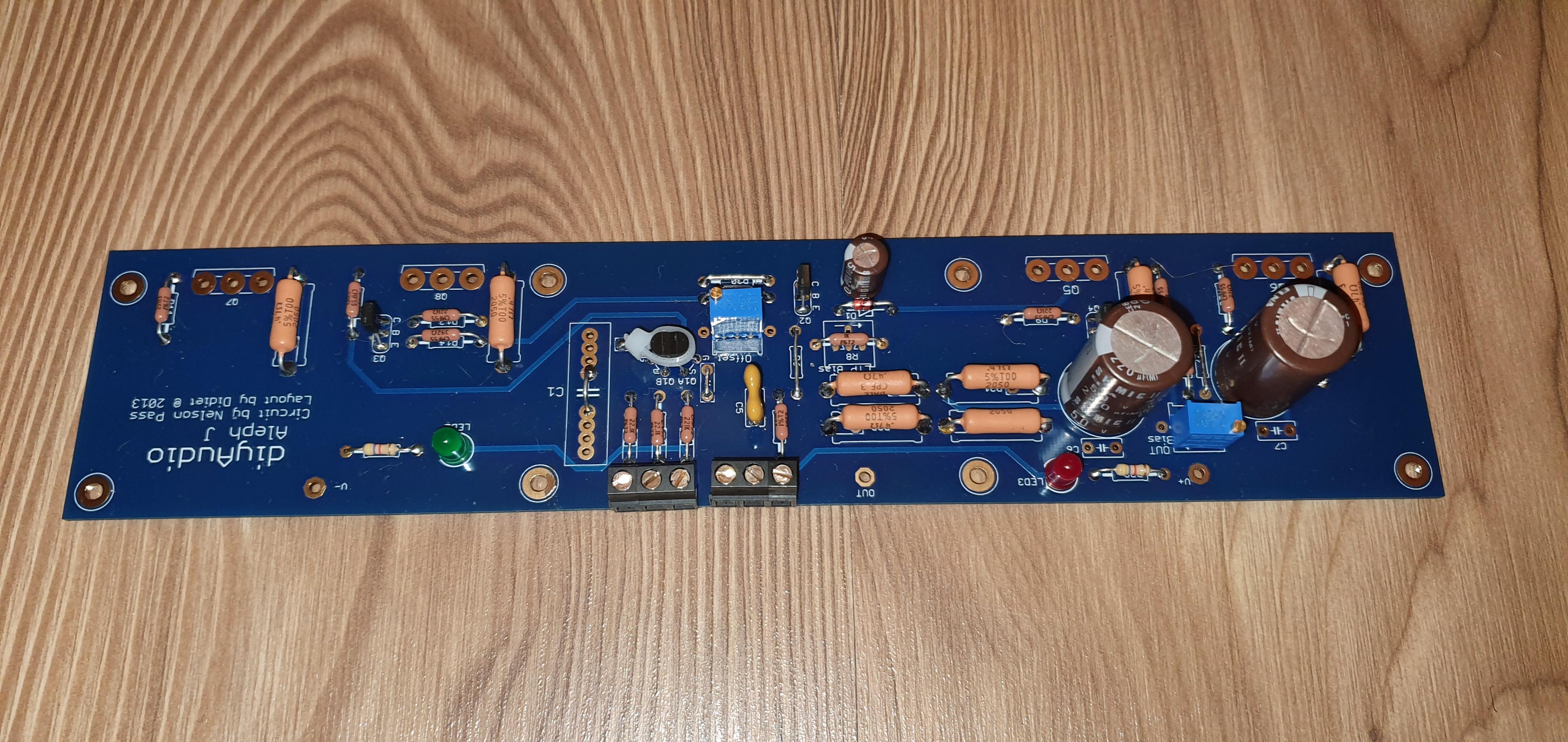

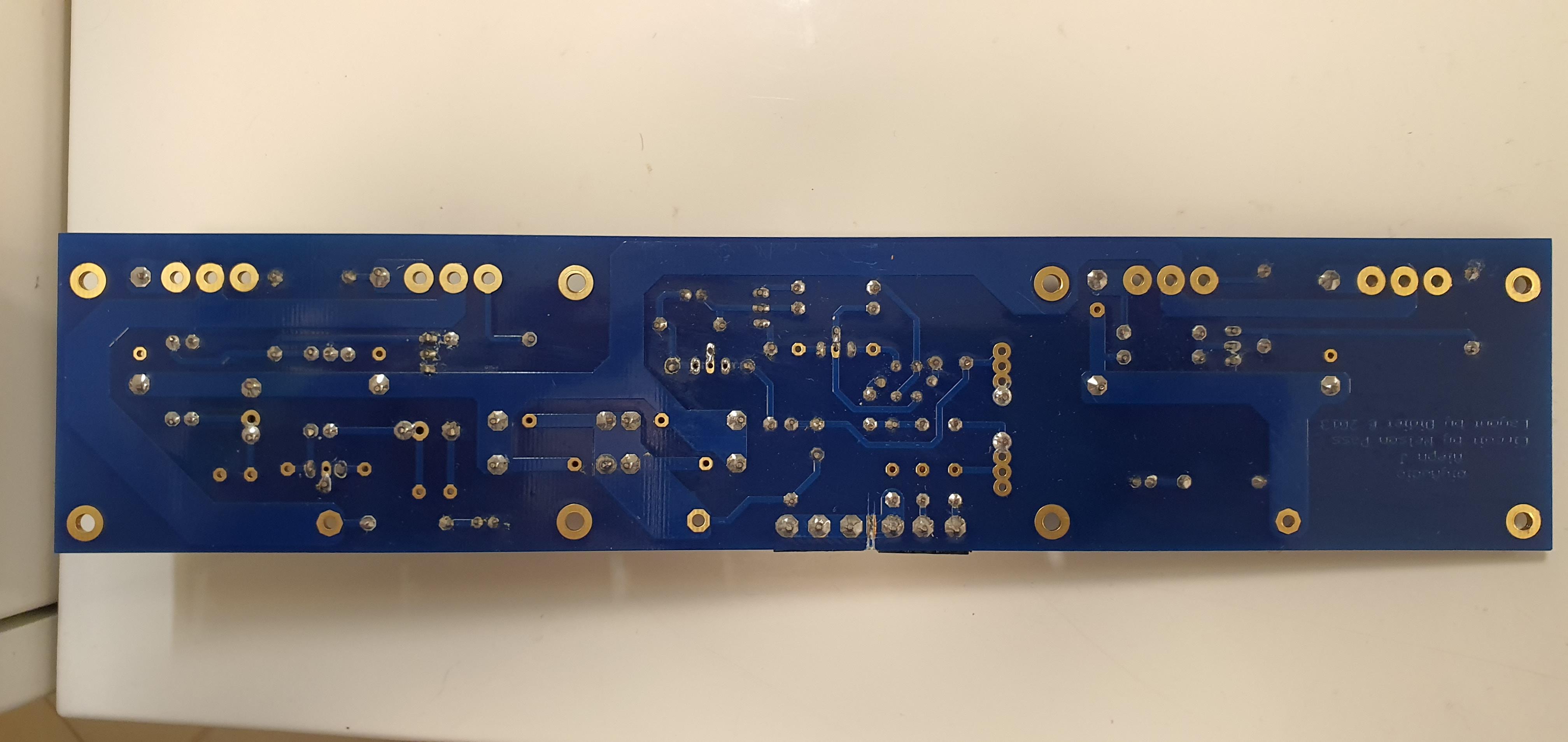

If you have the boards already removed... post the well-lit high res, in-focus photos, please.

1. Just removed and confirmed Trim pot is to spec and working - getting 1K ohm between pins 1 and 2, and 996 OHM between pins 2 and 3. Resoldered and all good. This was compared with another bourns trimpot, and the behavior is the same (though value was different.) What I was referring to earlier is that when reading resistance off the R7 test points, I get 1k OHM on the bad channel, while I get quite a bit less on the good channel. That being said, when powered with dim bulb, I am reading at or close to the specified 4.3V (though Id be happy to reconfirm since it was late.)
2. Q2 is the MPSA92, just confirmed
3. Followed all of the proper protocol for the JFETs, but I agree they seem to be the culprit. Question, if I need to order more, these are the pricey matched quads (and rare too) - would I need to swap all 4 so the amp is matched to itself? Second, is there any history of these being faulty - ostensibly they were tested at some point, but at $50 a set, one failure is a pricey one to take on.

Update - Removed the JFETS from the board, and after reading some other posts, it seems there's no way to really rest them with a diode/ohmeter. I've reached out to the store to see if they can furnish a pair at least - seems the quad sets are OOS again.

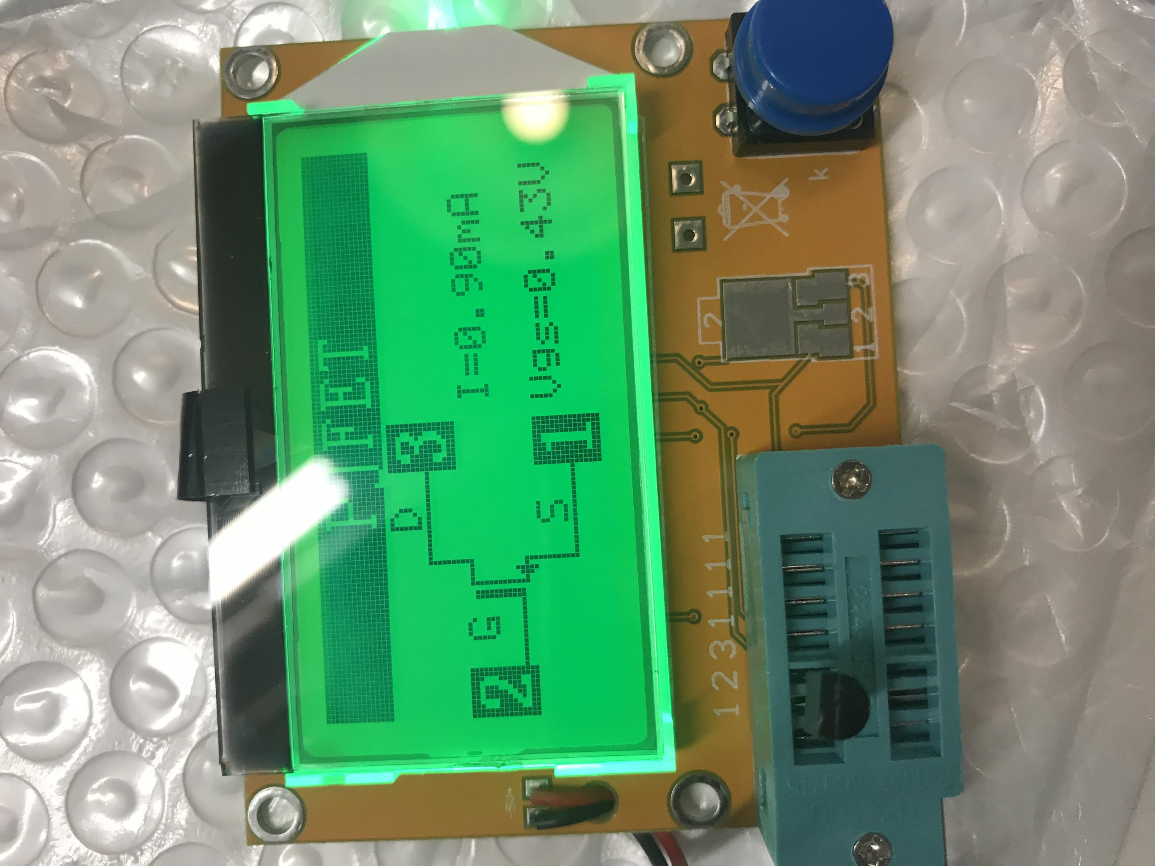

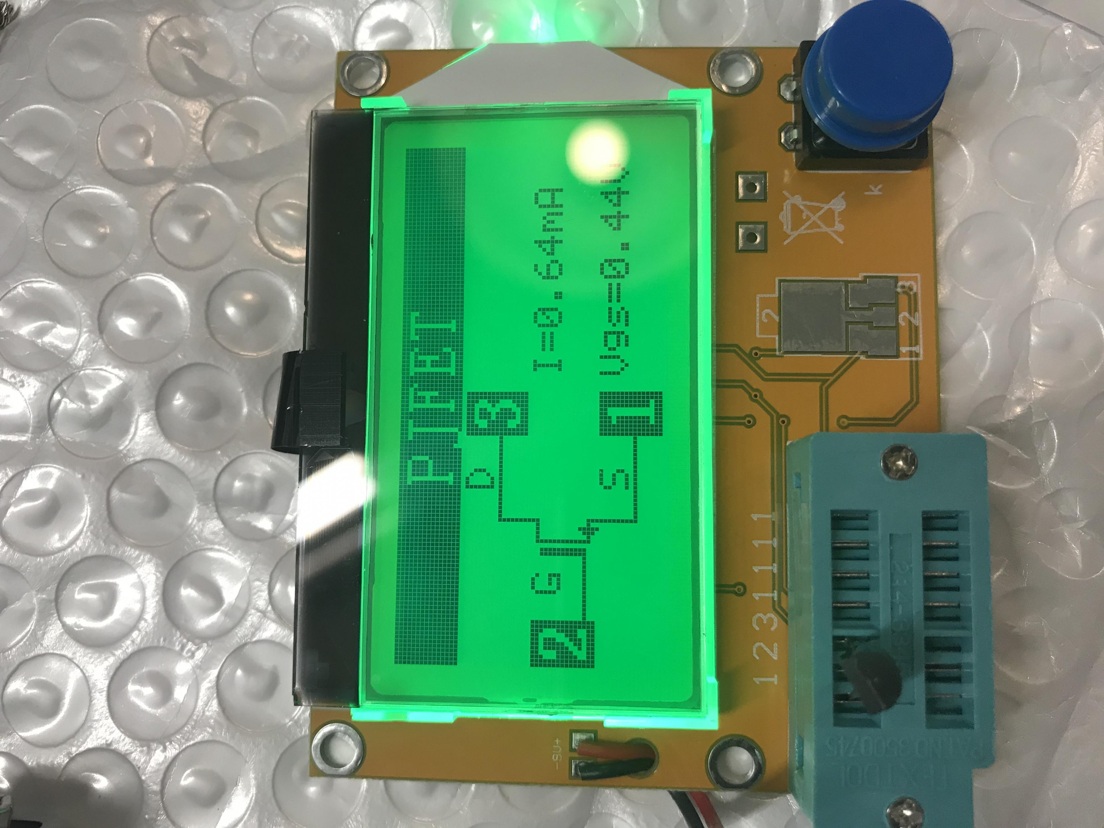

I don't think you can draw that conclusion. It may just mean one jfet "turns-off"
slightly earlier than the other.
Have you tried doing Idss measurements, as outlined here? :
JFET matching information – diyAudio Store
Yup yup, they are good for identifyingI have the same cheap tester, its very handy, but I find Idss value it provides is much lower than real value I obtain from test rig
Both jfets are ok
hfe and idss measurements are too far off.
