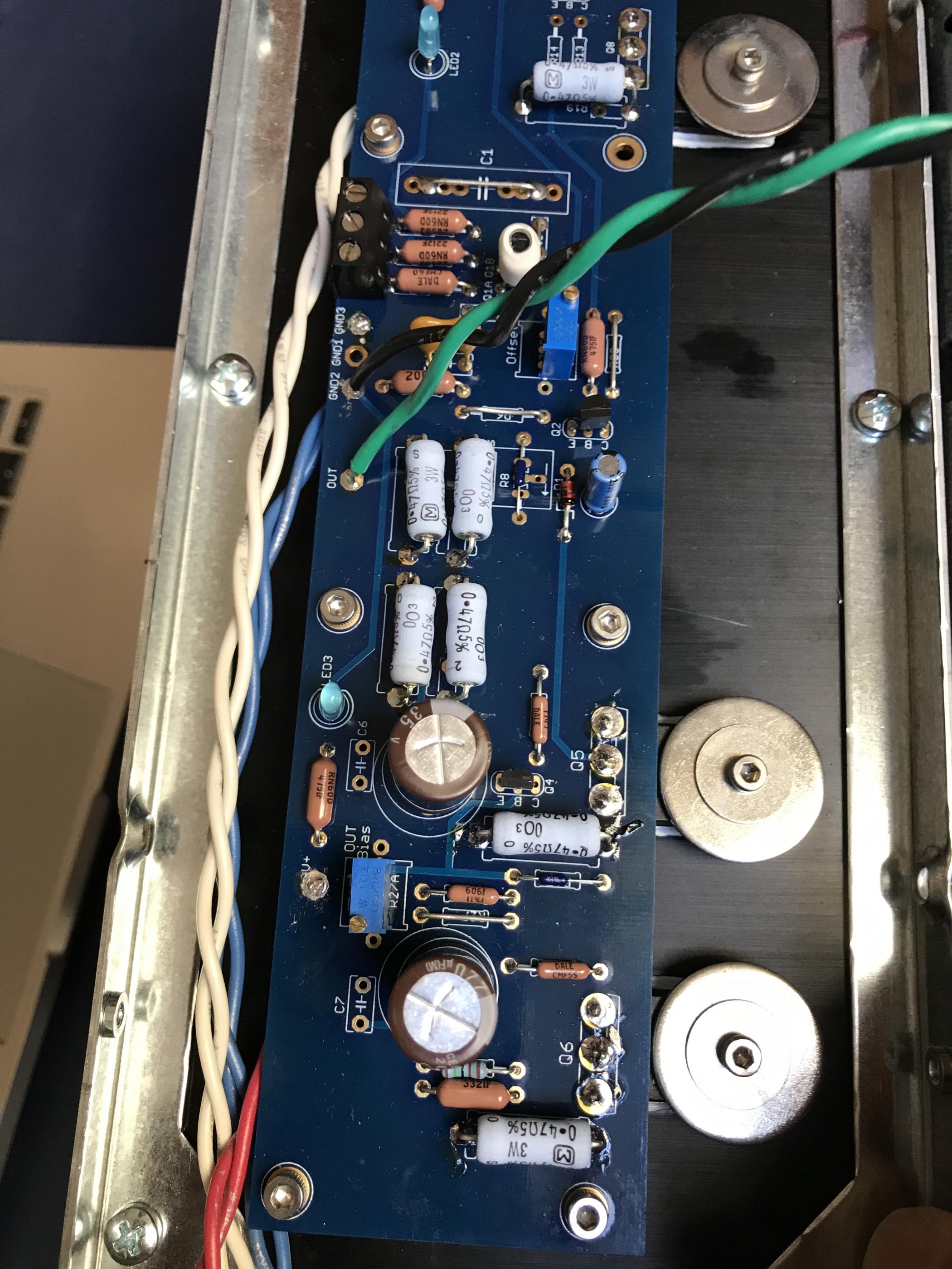

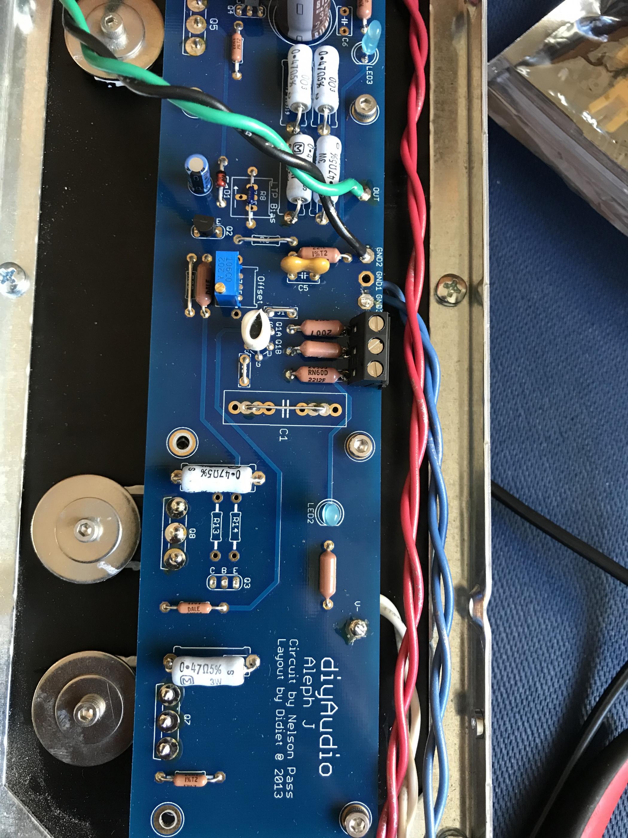

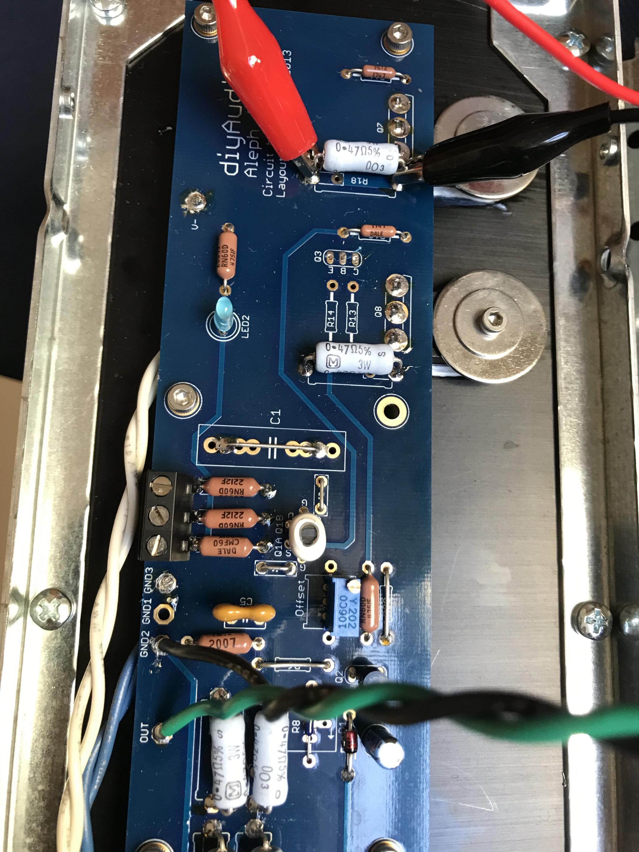

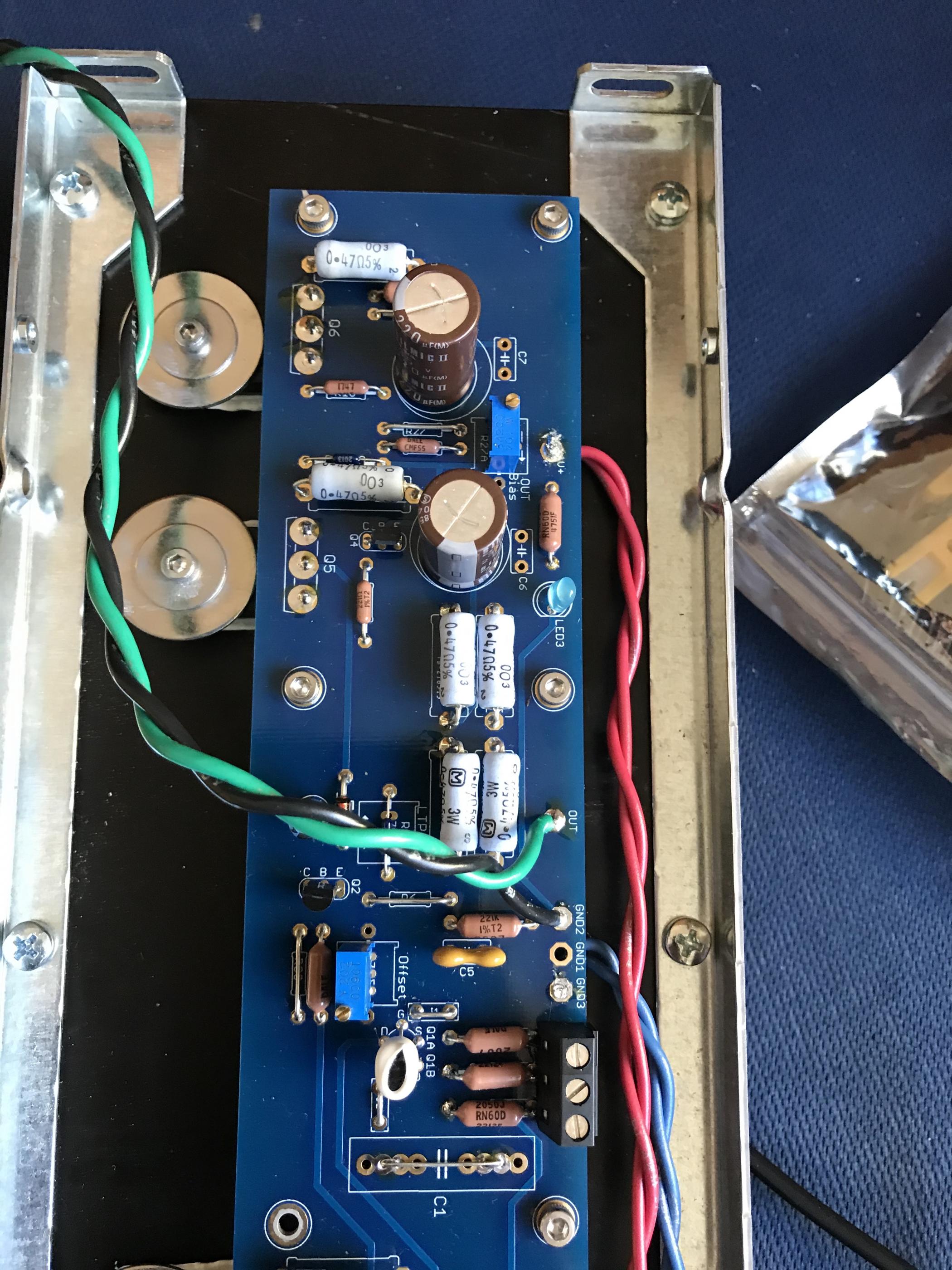

Hey folks, posted this on another discussion regarding C1, but maybe I can get some eyes here.

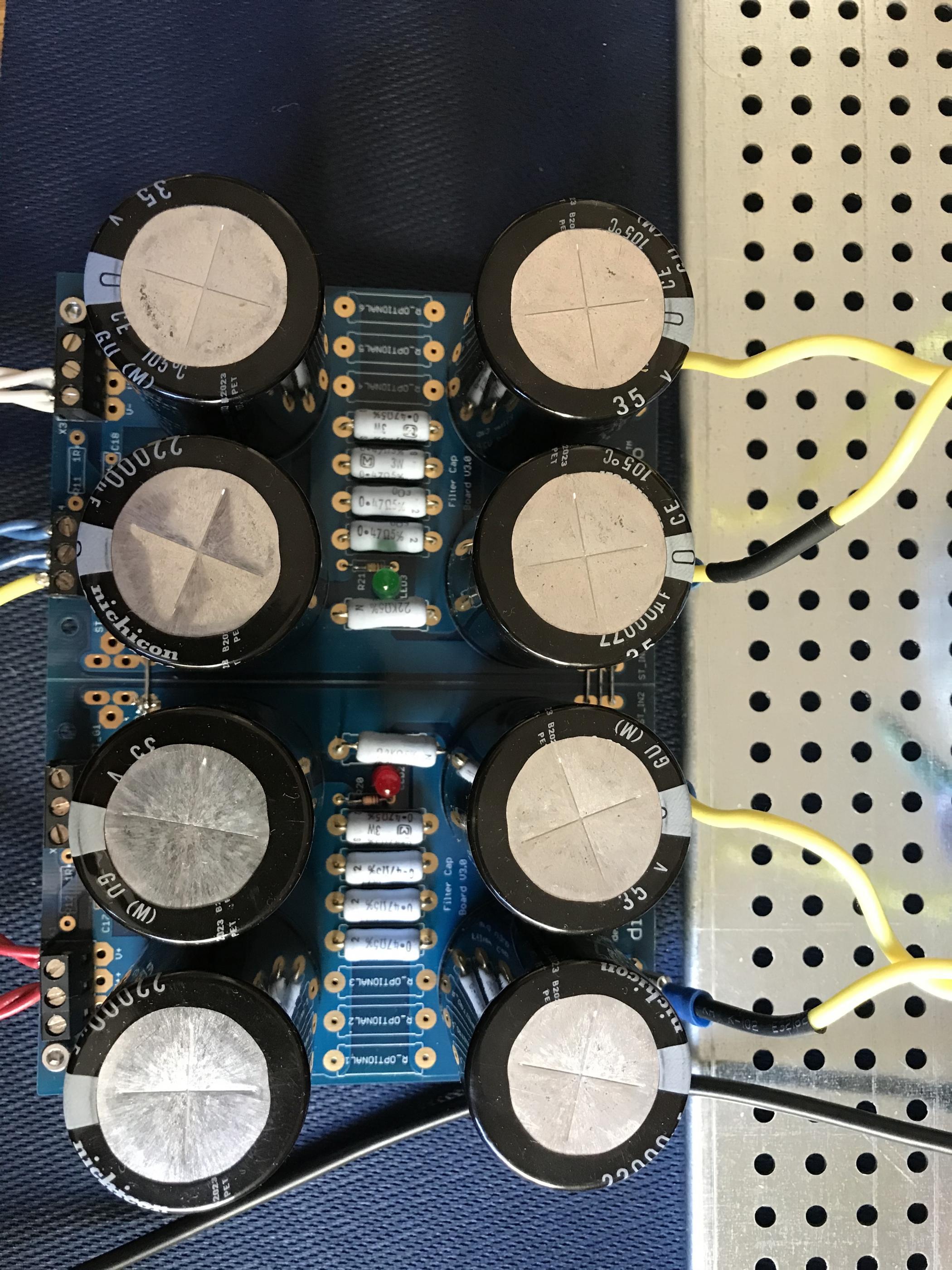

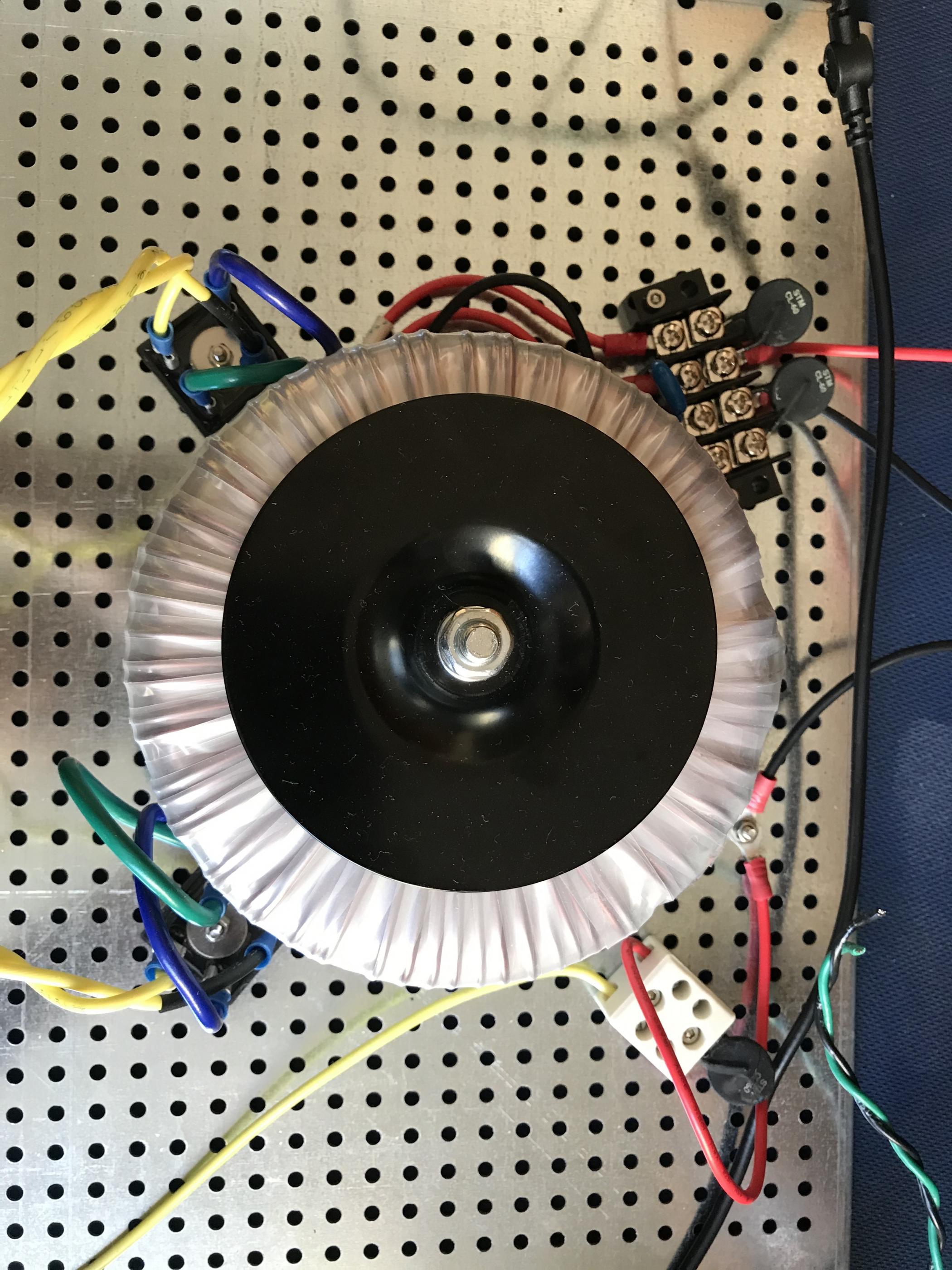

Just powered up the full amp after testing PSU overnight - seem to be having an issue thats showing itself as a smoky CL60 tied into ground block.
1, PSU tested "perfectly"
2. Mods are - C1 Bridged and C6 & 7 omitted - shouldnt relate, but worth mentioning
3. Q3, and R13, 14 omitted as well.
Checking everything over and over, and I can't find any particular culprits at the moment - the ony clarification:
Channel 1 - I have solid connections from V+, V- and GND. and ALL THREE show continuity when tested against star ground or base plate.
Channel 2 - I have the same behavior EXCEPT V+ does not chime conitnuity to star ground/Baseplate
on the PSU Board, I get continuity from V+ to GND to V- as well, but seems normal.
Any targeted thoughts for troubleshooting? Should I take this to another thread? finally, Could this be that the CL60 is poorly rated for the mods and start-up current needs?
**** QUICK EDIT*** - After retesting the PSU board, it seems that the solder grounds on the connection block are weak - while I get my ~+/- 25V when going to the ground leading to star, I am not getting a nice ground when going to other two - going to reflow these after it's drained out, and see how we do. Those are all reading the same now -
Again, inrush seems fine and the issue is showing up on the CL60 inline with PSU GND to Chassis GND and earth
Thanks in advance
Alright, here we go....
FWIW both boards are behaving identically, I just spent a nice amount of time checking on this - so it would seem that way, at least without voltage applied.

I don't know yet. But I have no idea why it (C1) is not there, as all the DC issues happen on the V- side of the diff pair.
Also, why is the limiter removed? That may be adding to your woes...
Build a Lightbulb tester, that will save expensive parts moving forward.
