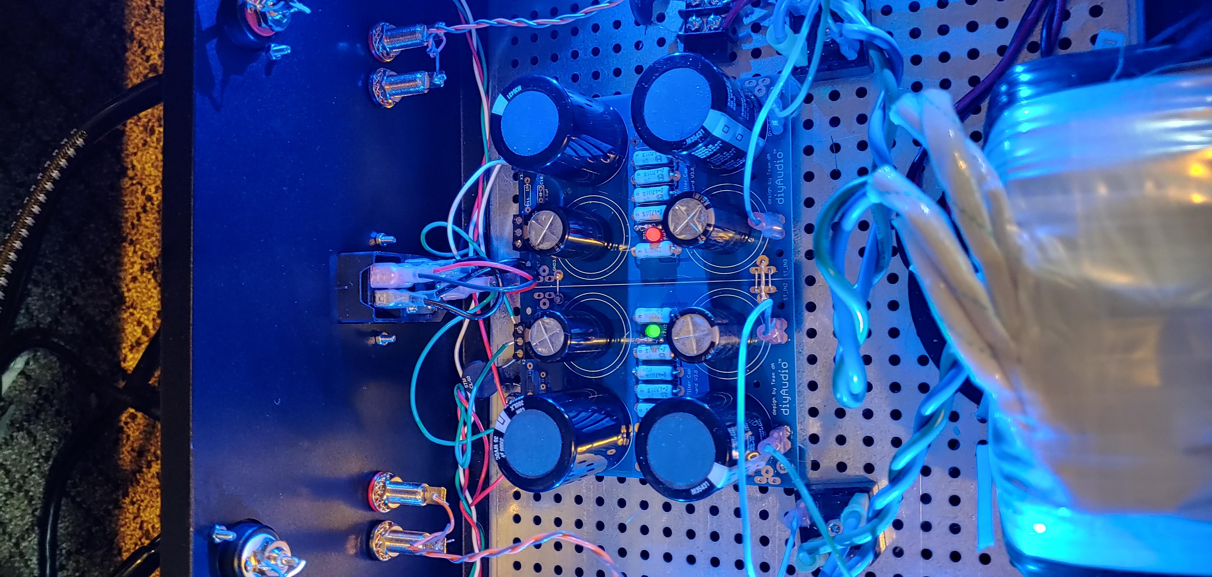

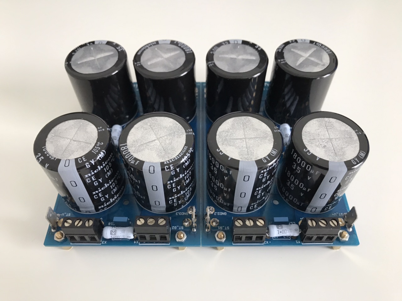

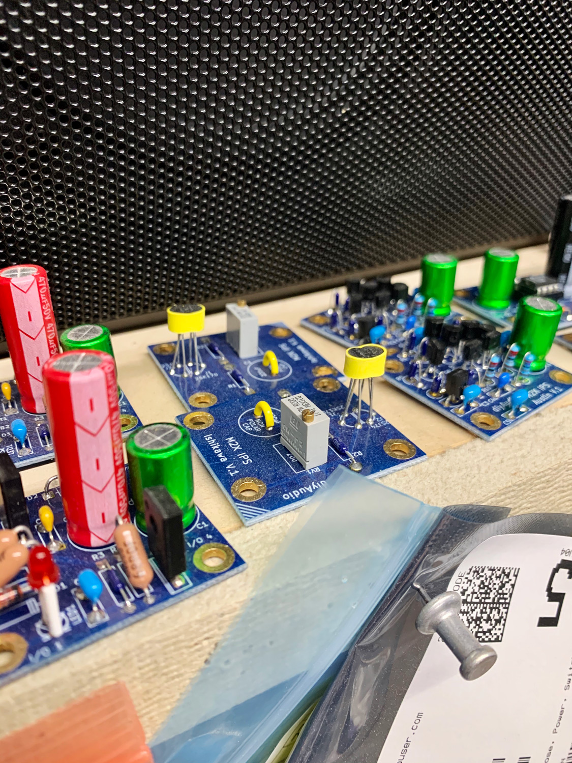

Added 4 Nichicon KG series caps into the previously empty mounts on my power board. Amp is again stable with bias and offset after 2 hours of setup burn in. Had a quick listening session to make sure things sounded good. I'll get more time to listen tonight and give my impressions with my upgrade/modification.

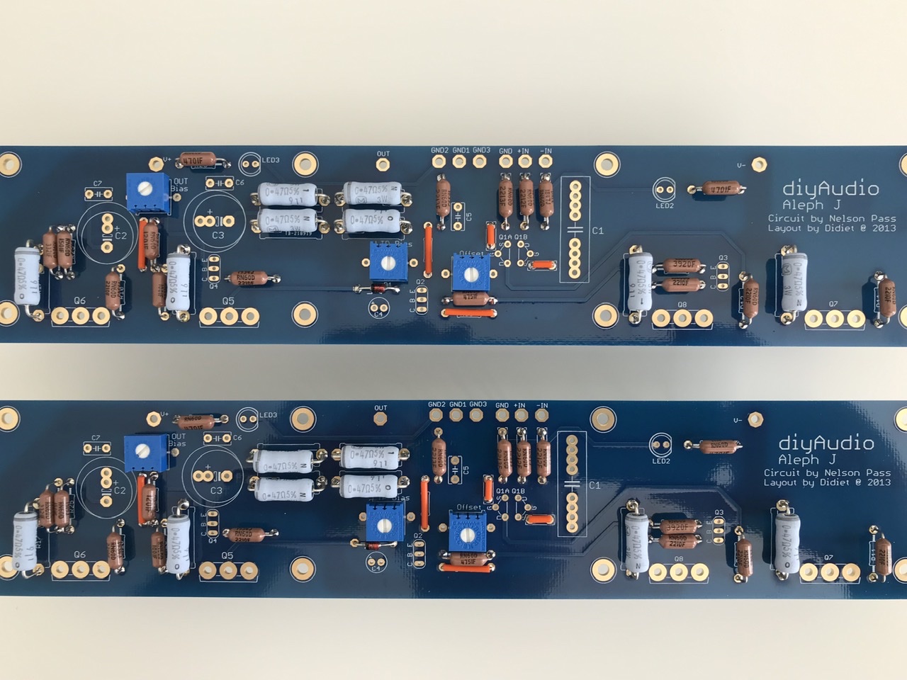

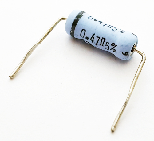

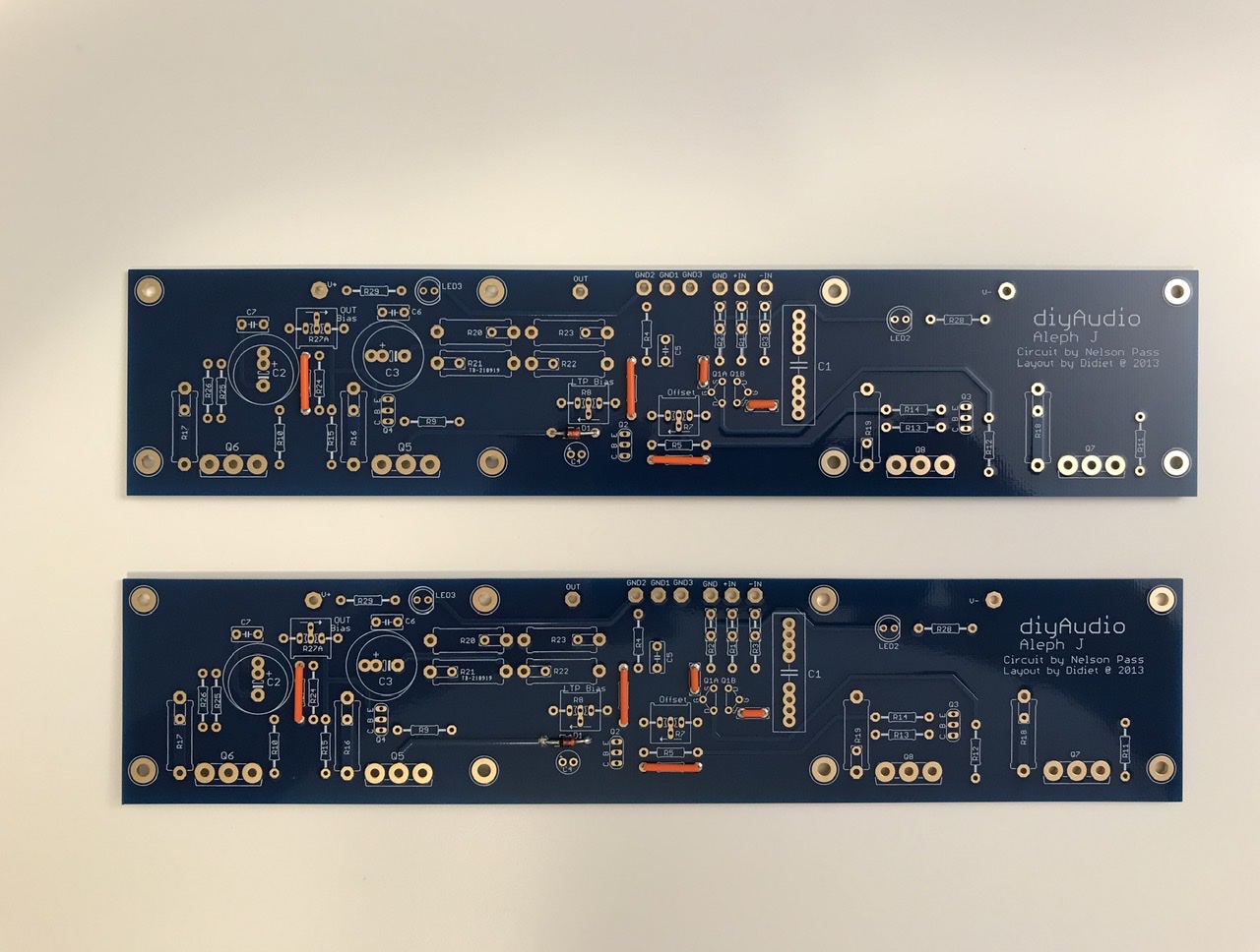

I am building the Aleph J with a couple of friends across the country. We’re using Zoom to video conference and go through preparations. I looked at the Panasonic 0.47R 3W ERX resistors and noticed they have a stripe on one end of the body. Is there any significance to this stripe? I’ve never known resistors to have any polarity or directionality. I looked in the data sheet and nothing stood out to me about that marking.

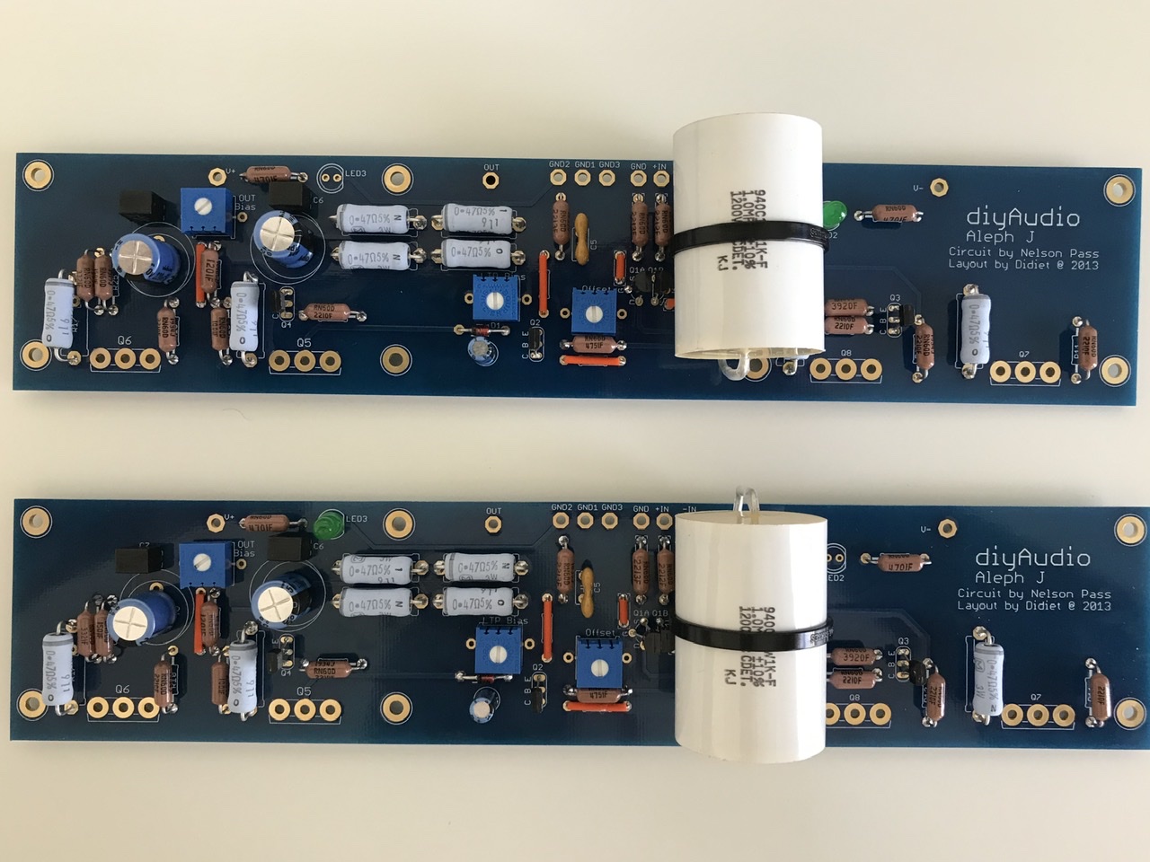

I have completed the power supply board and the two amp boards. I am placing an order for a black 4U Deluxe Aluminum chassis with handles. I’ve got everything else to finish it once the chassis comes in.
This build guide has been extremely helpful. Thanks again to 6L6 and all for sharing your knowledge and experience.

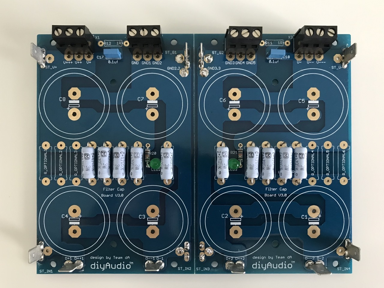

I will remove the PSU output snubber. The jumpers between the power supply grounds are underneath. I just thought I’d have lugs in case it makes sense to to use the lugs rather than the terminal blocks. I might go with a dual mono configuration in the future.
As for the LTP Bias pots, I set both pots to 1.000 kohms.
