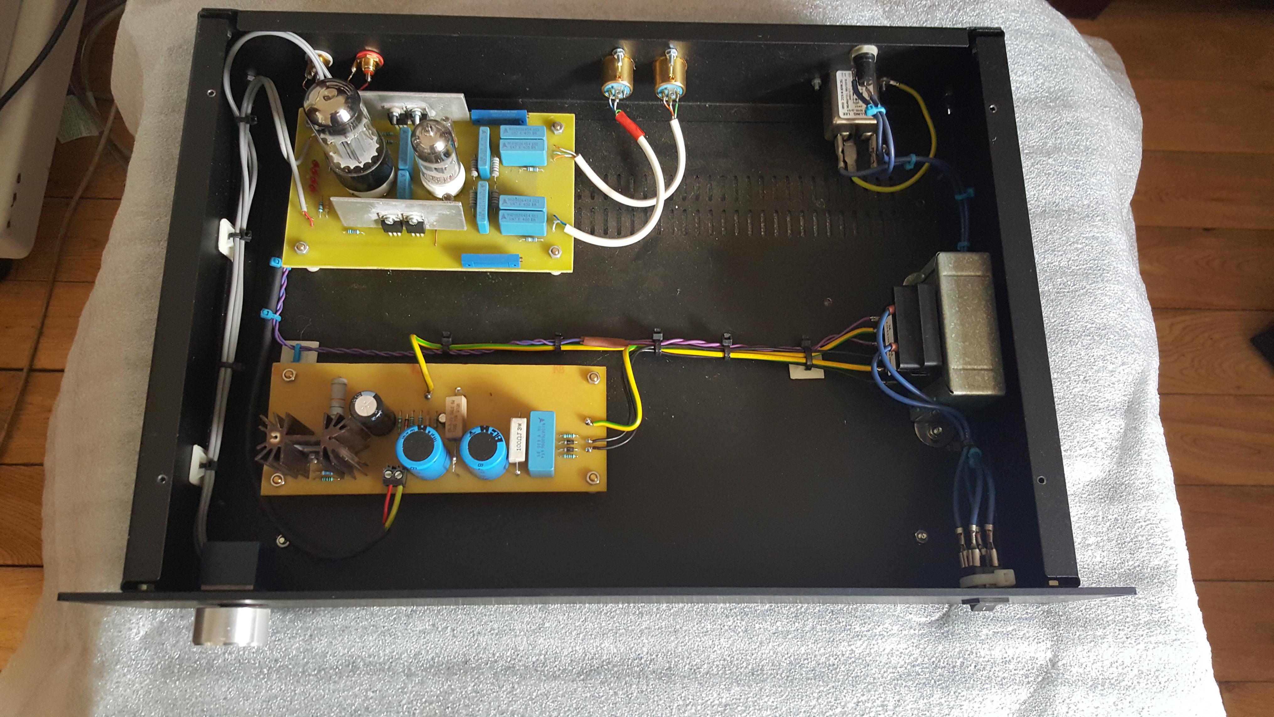

Listened some more with my new build last night. First I have many SE tube amplifiers and I love the sound. To me the Aleph needed something to get to the level of my SE tube amplifiers. Then I decided to hook up one of my Tube linestages and boy did it make a difference. In NP's description of this amplifier he noted how this amp with it's high input impedance was excellent for a tube linestage. One must remember that this amplifier was introduced almost 20 years ago. Excellent sounding with my tube linestage.
I do not want members to get the wrong idea. On it's own with just my B1 buffer the amp sounds really good, if not excellent depending on your taste in amplifiers and music. To me the tube linestage took it to another level.
I relegated my B1 in preference to the P1.7.
I built the Aleph J as it is supposed to be as close to tube sound as a semiconductor amplifier can be.
Unfortunately my Impasse pre-amp has a hum problem that I haven't been able to solve.

Just want to mention, the Nutube linestage should have the same results. My Nutube has developed a nasty oscillation that I need to dig in and find.
I could not get to the root of the hum in the Impasse.
The HT was rock solid and regulated.
I played with the GND but that didn't seem to make any difference.
Heaters were isolated and twisted pairs.

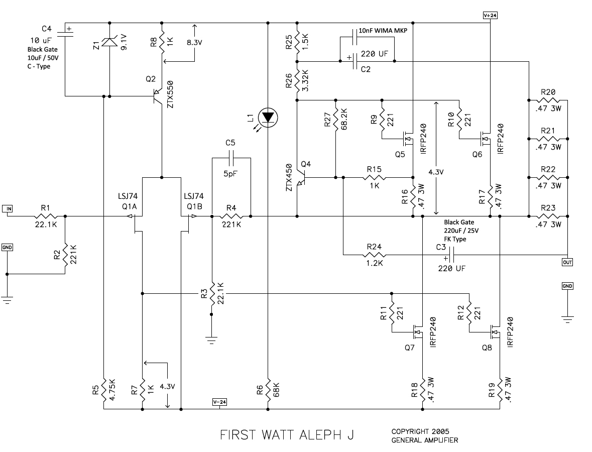

That’s not one of Nelson’s designs, that I’m aware of, but looks to be some omitted parts and other notes on a schematic. It will probably work.
Concerning the question I asked it appears that only R3 and C1 are eliminated. Just briefly comparing the 2 schematics nothing other than a few values has changed.
And the output limiter is removed. This won’t effect operation.
I must admit, in my experience Black Gate caps are awful (YMMV) and anytime I see them specifically called for I twitch a little... that said there’s no reason why the changes won’t work. I personally, however, would not omit C1. I want no possibility of DC on that side of the diff pair.
And the output limiter is removed. This won’t effect operation..
Are you talking about Q3, R3, R14? Just trying to learn something.
