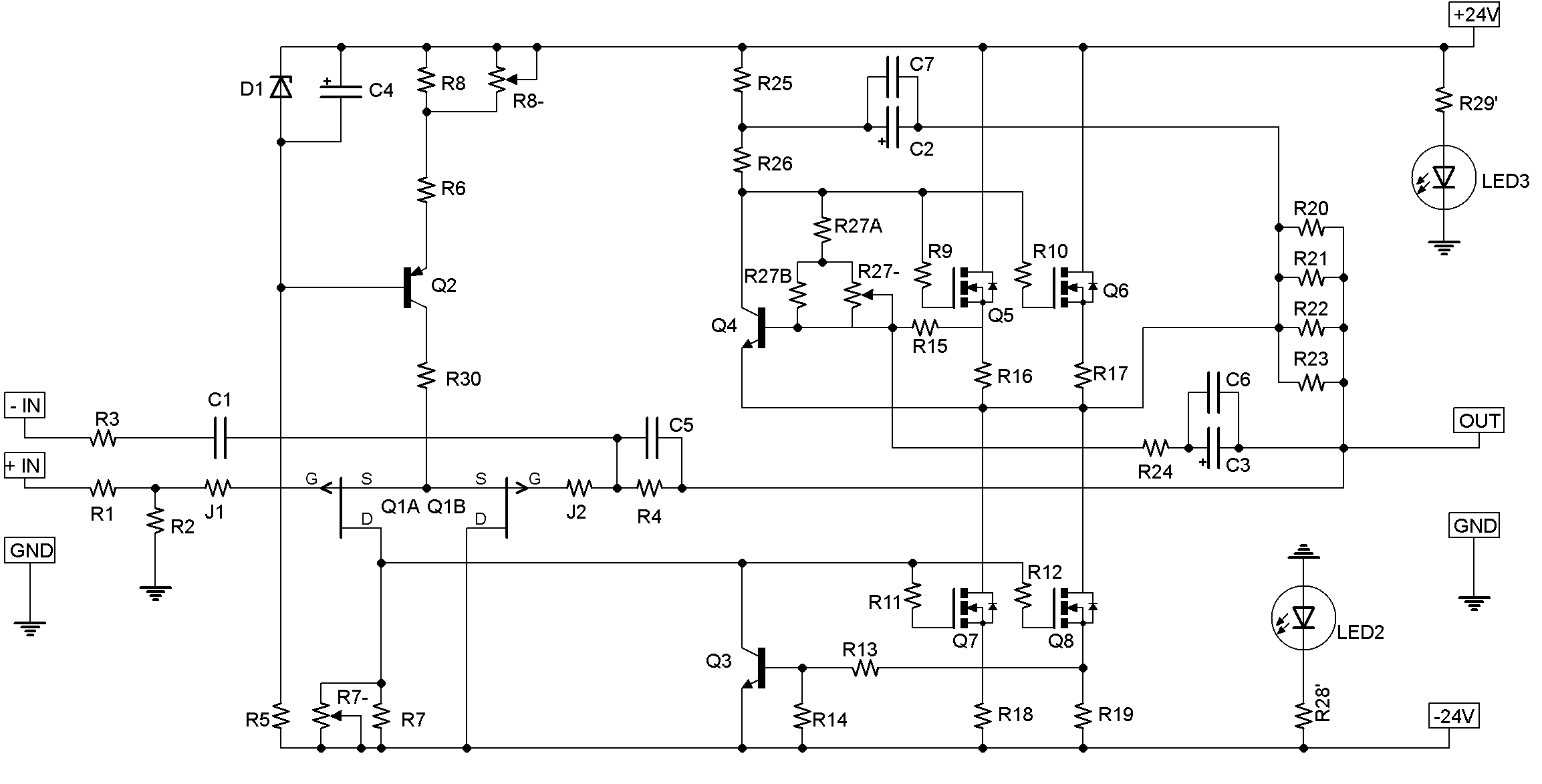

I am in the process of building this amp, one I have not done, getting ready to match some IRFP 240's and the way I see it is I do not need to match all 4 mosfets to each other but rather match Q5 and Q6 being they are the output ones and Q7 and Q8 being the Aleph constant current source matched to each other. I ordered 25 of the IRFP240's, which should be a tube from the same run and will not be far off to begin with, so matching all 4 would not be a problem but I am just being curious wanting info from more talented members than myself.
You are right, on both accounts. In my case, all 25 MOSFET's (Mouser) were perfectly matched.
My experience hasn't been that good, though getting 4 matched pairs from a
single rail was not a problem.
The last tube of 25 I bought were matched pretty good. I did match the ones I used in an amp I was building closer to each other. It could depend on method used in testing and how close you try to match but buying a tube of 25 from the same run is the way to buy these mosfets to get closer matches.

Few weeks ago i asked for help with the hiss in my Aleph J.
Output offset was jumping.
Now i can tell you, that one of the LSJ74 was guilty.
When i soldered them out and checked with transistor tester, i found out , that good one gives me the same measurment results in both orientation, the other one gives good measurements only in one position. When i rotate it for 180 degrees, it becomes fault.
So, i bought a matched quad 2sj74 from punkydawgs. Today i soldered two j-fets in faulty channel. Offset becomes excellent zero.
Question: should i replace good LSJ74 in the other channel with Toshiba or not?
Cheers

On our store boards there is a place for the R7 resistor along with the 2K pot. On the BOM there is not a listing for this resistor. The boards 6L6 used are not the same as these and he is talking about a jumper along with the pot. What goes in the R7 position on the store boards. I am not able to adjust offset or bias right now.
What did you put in R7? Both the 2K pot and the 1K fixed?
What do you have for R8? 1K fixed or a pot set at 1K?
...The boards 6L6 used are not the same as these...
The only difference is the color.
