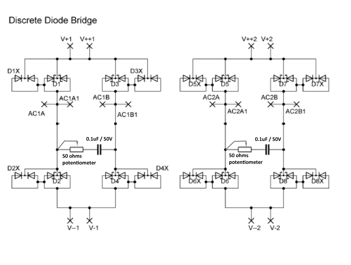

NOTE: this is a long shot... do it if you are keen on experimenting and you have time.
Connect the secondary windings to the power supply PCB, load the power supply PCB with amp PCB's, and then use a series combination of 0.1uF /50V AC film capacitor and a 20-ohm potentiometer (you'll need two sets of these), across each secondary winding. While the amp is ON (transformer fully loaded with both amp PCB's), rotate the potentiometers to see if the buzz changes... If you have an oscilloscope, monitor the AC windings for oscillations and see if you have any, and if you do, if the potentiometer rotation is affecting oscillations' amplitude.
Attached.

Bias issue
I finished assembly of my Aleph J, and am having an issue with the left channel bias. Right channel I was able to adjust offset and bias with no issue. however in the left channel, I can adjust offset to 0, but I cannot get the bias to go past .274 V. I have turned R27 to it's maximum and it will go no further.
