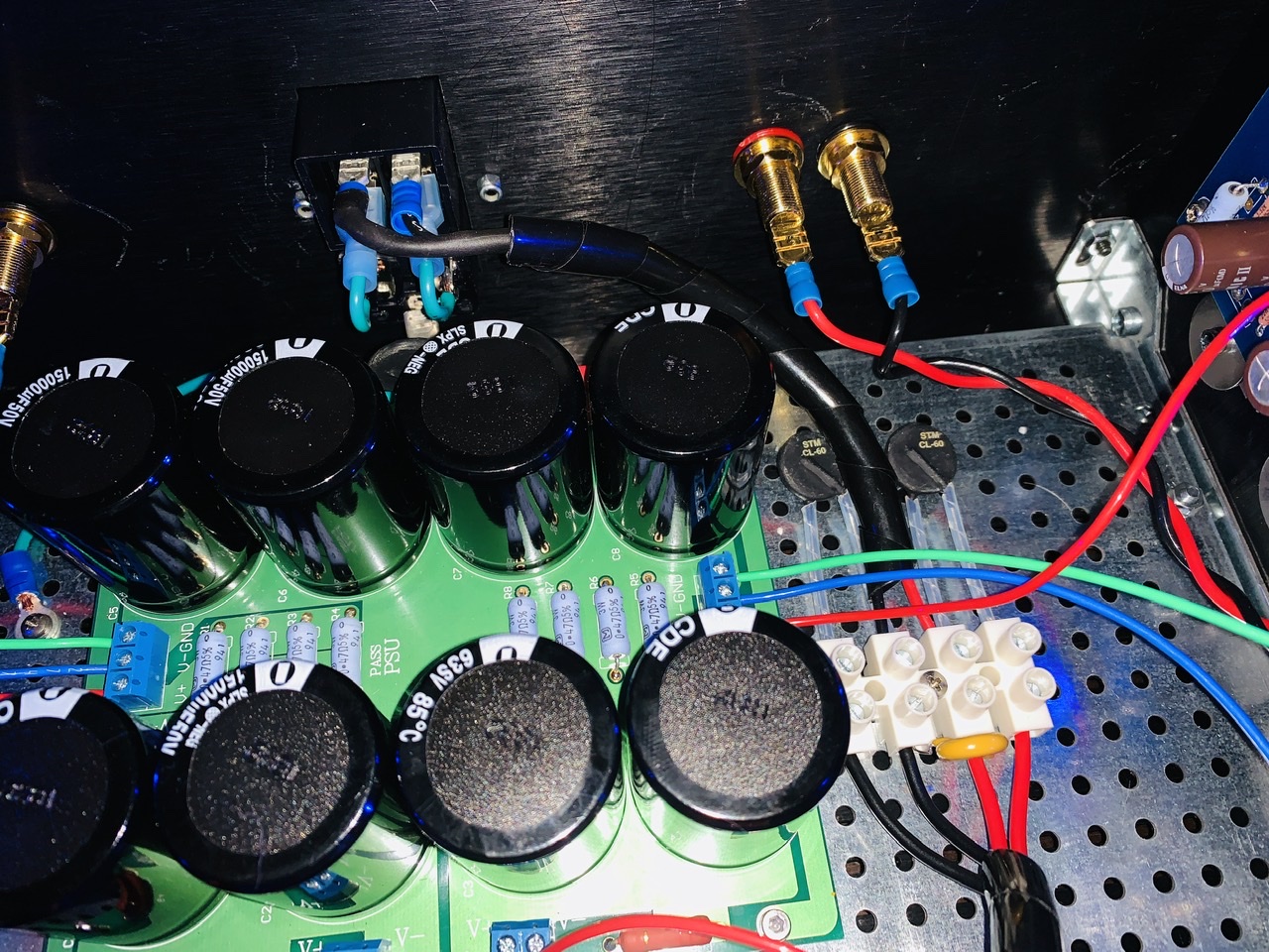

Sounds good on snubber. Here are a couple of detail pics of where I’m at now. Let me know if you see areas for improvement (aside from the shortening of mains wire and including a snubber)

The mains wiring runs in parallel with one of the secondary wiring. There's the reason why the manufacturer chose to separate primary and secondary wirings' tails as much as possible🙂.
Anyway, I would look at shortening the mains wiring.... or at least, getting rid of a terminal block, and then running the full mains loom length between the "floating chassis" and the case bottom plate.
But, you should definitely consider my suggestion to shorten the mains wiring, as I already mentioned in my previous post.
