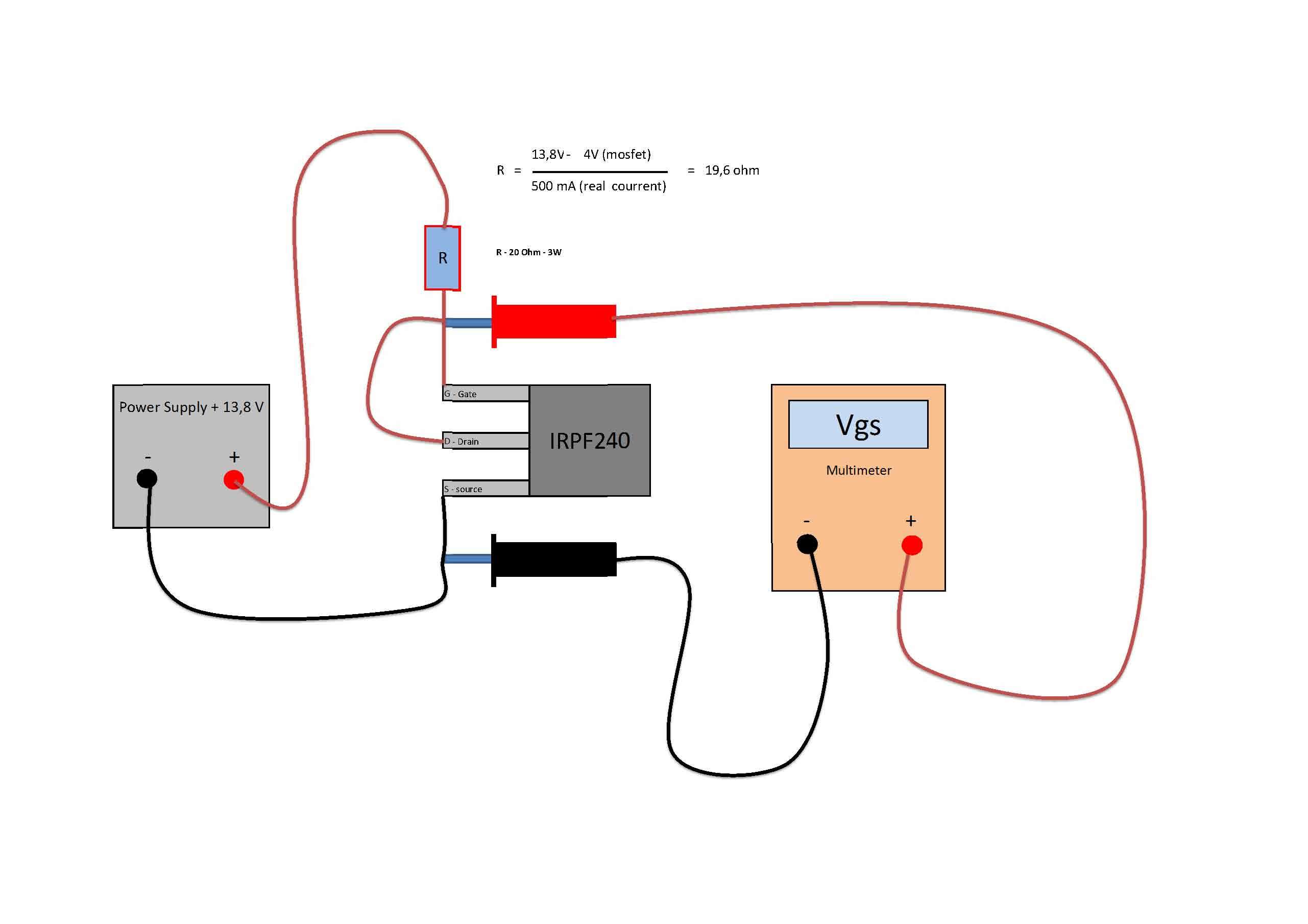

Hi guys, I've received a bunch of IRFP240PBF for my Aleph J build but have a question regarding matching them. The only power supply I have to hand is a 19v laptop supply so what value/wattage resistor would I need to match Vgs for an Aleph J? Also, should the FETS be mounted on a heatsink for matching?
I tried 20 Ohm 3W as mentioned in another thread but the resistor got very warm!

I used three resistors in parallel to achieve 24R with a 30w rating and my resistors STILL got hot while testing each mosfet for only 30s. Ideally, you want to test at the same voltage and current levels that they will see in the completed circuit, but I found that mosfets that match at some power dissipation level also tend to match well at other power dissipation levels.
Thus, the final measure I made for my in my big Aleph-X amps was 15v at 0.5A current. In the finished amp, they run at 21v and 1.5A and they match nearly exactly with one another.
In my Aleph-X page (linked below) search on "Matching Mosfets" and you'll find lots of details.

With 20 ohms you're matching at 800mA, which might be a bit high. I'd shoot for somewhere between 170mA and 500mA (90 - 30 ohms).
Very warm is fine. Hot is fine. Very hot is fine. Smoking is not fine. 😉
