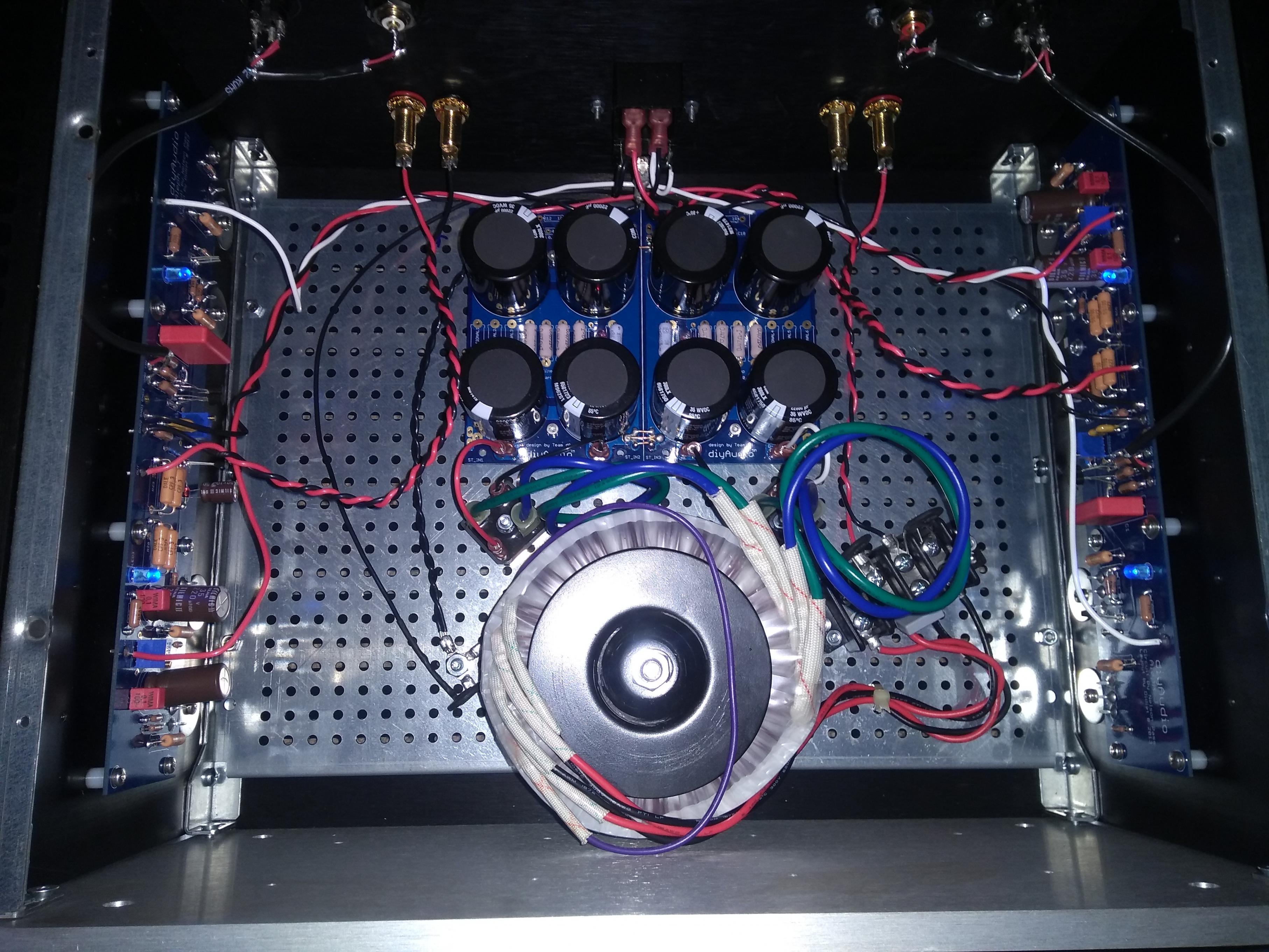

Today I finished an Aleph J. I had read the thread front to back before building. Thanks to the great info and tips, everything went well. I bought matched 2SJ74s from Punkydawgs. The other devices came from the DIY Audio Store Aleph transistor kit. (Beware, they are still shipping the F6 zeners instead of the Aleph J zeners).
I did way too much DIY over the past six months. I started with a pair of ACA 1.6, and was so impressed with them I decided to build an M2. I was so impressed with the M2 I decided to build an Aleph J. Now I am going on the wagon - no more amps for me.
However, I would like to build a good solid state preamp that would work well with these amps, if anyone has suggestions.
