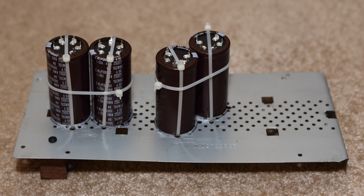

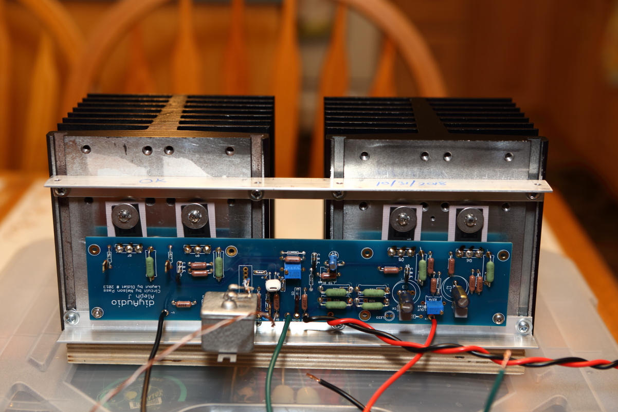

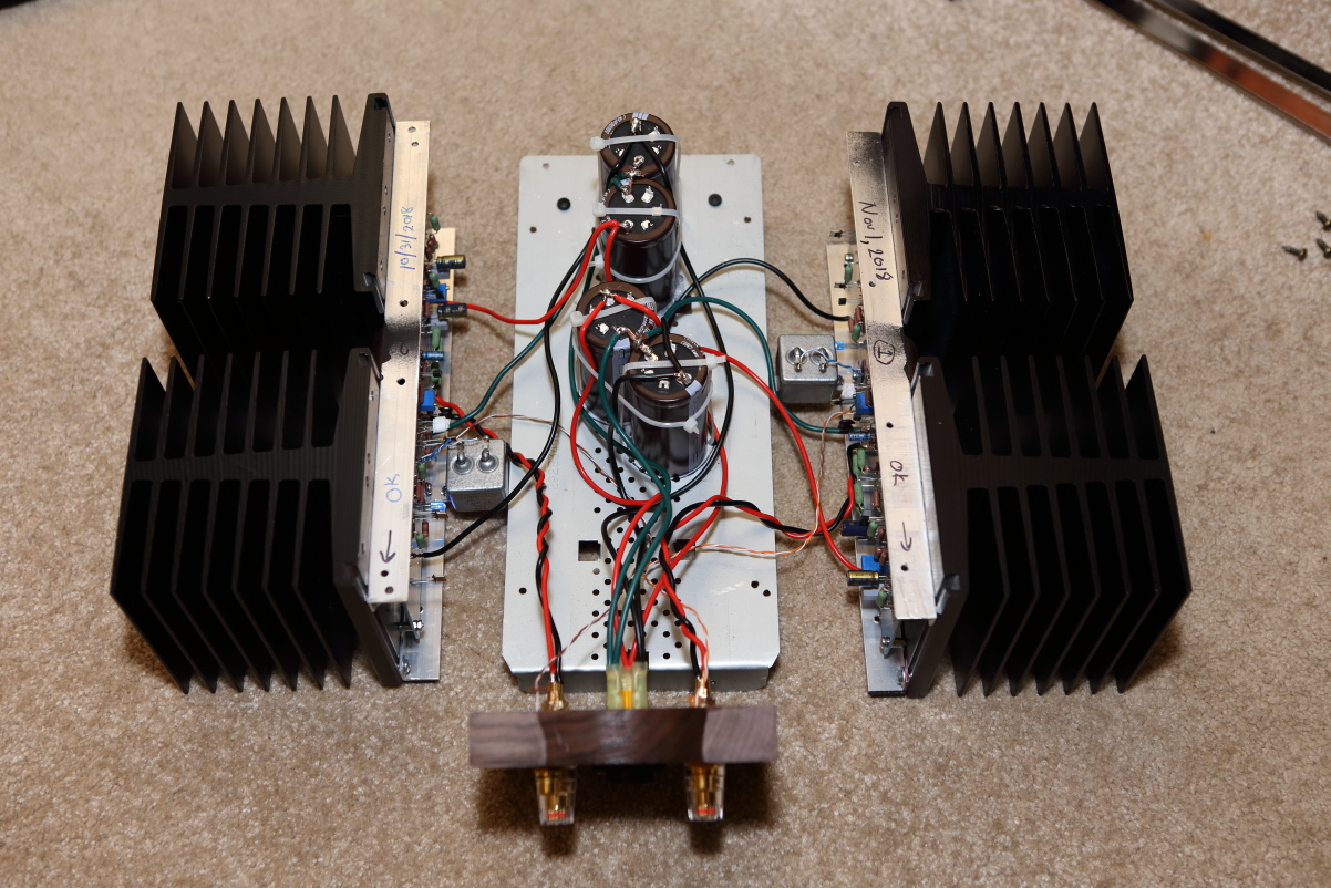

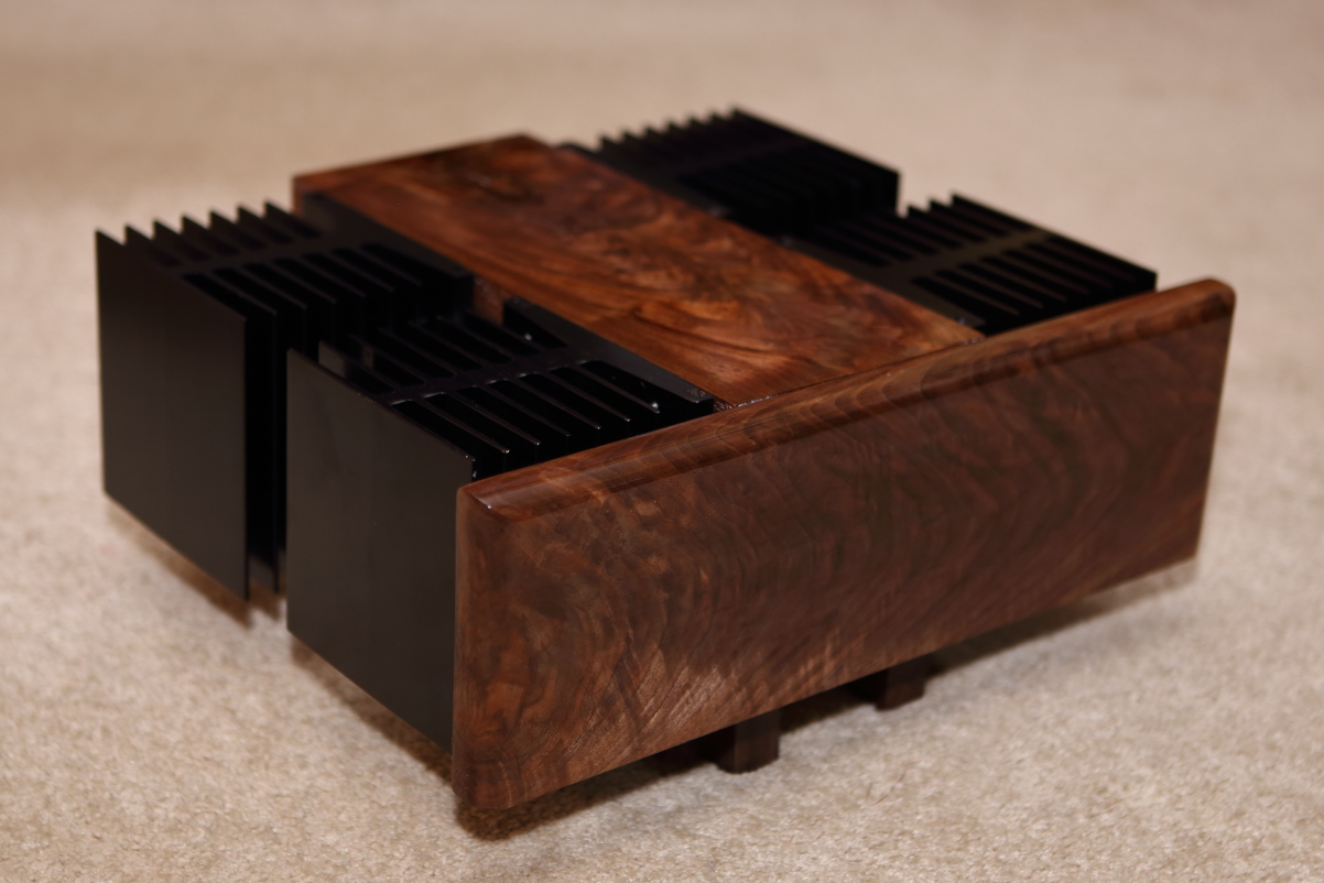

Finally had some time to finish my Aleph-J while the turkey was in the oven today. This is my third amp that makes use of my modular power supply.
It runs on +/- 21v rails with ~1.25A bias per mosfet, so the completed amp consumes about 200w out of the wall with a final sink rise of 31c above ambient. I used Keratherm pads for the mosfets and the big silver caps are Russian MBGCh. The CRC power supply has ~70kuF per rail and the amp has another 200kuF inside - 50kuF per rail per channel. The caps are held in place with silicon caulk and wire ties. Final offset is about 3-4mV.
Wood for the chassis is a nice Walnut that I found locally with a few coats of shellac on it. The sinks were a flea market find for $12 total and the metal plate on the bottom came from an old television that I disassembled to recycle. The legs keep the bottom of the sinks about 1.5" above the tabletop for good airflow. Turns out I could have pushed the bias a bit higher, but my pots ran out of room to adjust.
I'm hoping to get it installed tomorrow so I can give it a listen.
