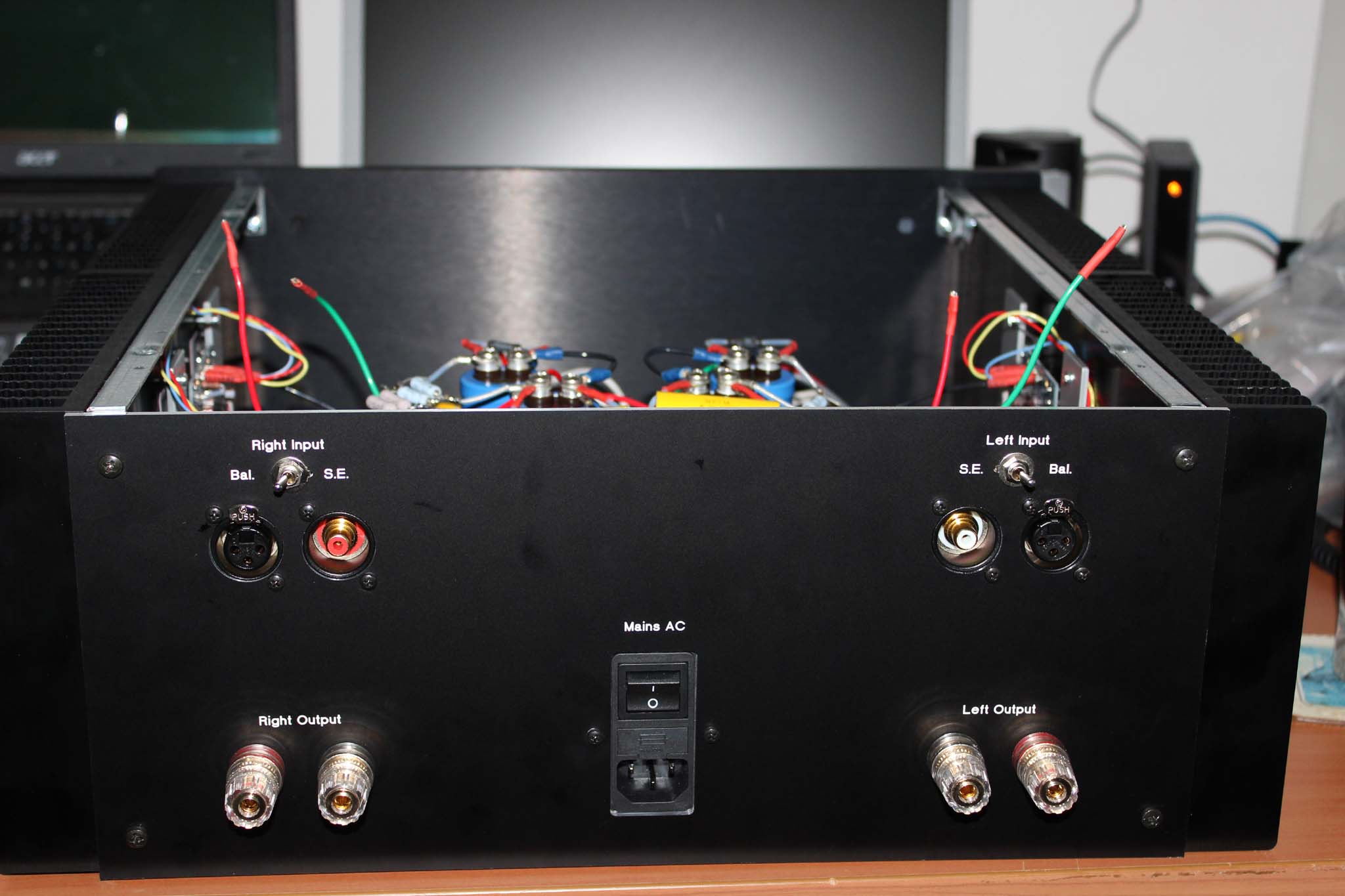

I have seen somewhere here a diagram showing what to do to correctly integrate/change XLR and RCA inputs with a switch but can' find it now - can anybody help?
No diagram at hand but it is easy to understand without one:
Connect GND of RCA and pin 1 of XLR to GND on amp
Connect + of RCA and pin 2 of XLR to + on amp
Connect pin 3 of XLR to - on amp
Connect terminals of switch to pins 1 and 3 of XLR.
Switch in BALANCED position: No connection
Switch in SINGLE ENDED position: Connect Pins 1 and 3 of XLR, shorting - to GND.
I do not have a photo of the inside, but this is how mine looks from the rear.
Thanks for reply; as amps seem to be working ok (not auditioned yet) I won't fiddle with it. Just a small amount of hum to chase down - wish me luck!
