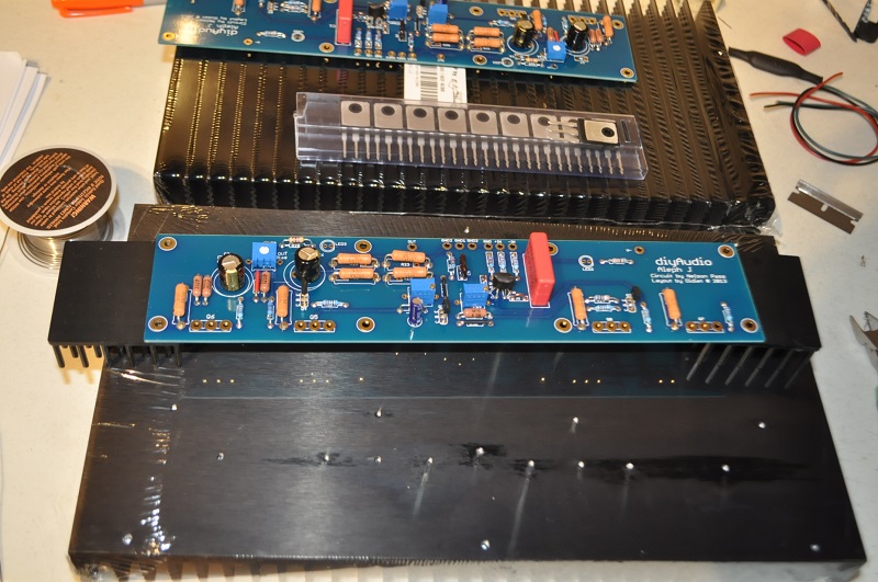

Just finished my first Aleph J build! It isn’t up and running as it’s blowing the .5Amp 250v fuse I had on hand. It did pass the light bulb tester.
Looking at the FirstWatt Aleph J manual it states a 4Amp 250v slow blow so I’m guessing that is what is needed. Is this correct? Anyway had to post a picture, just cause.
Edit: Sorry about the upside down picture, I’m a goof.
Very Nice! Looks great! I love my Aleph J, I’m glad I took 6L6’s suggestion to build it.

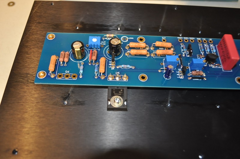

I have a question about mounting the mofsets. Is there a best way?
1. Mount them to the board and then make the bends and if so how far do you insert them
2. Mount them to the heatsinks, make the bends and then solder
3.Mount the boards to the heatsink first then make the mofsets fit
thanks
Not many 3mm screws around here. Hardware store trip tomorrow. Just right tight I suppose and thanks for the tip. This will make the Eikona 2's sing. One more question. Should I use any substance between the heatsink and the mosfets? Thanks
