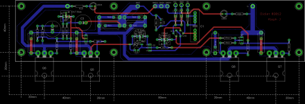

Aleph J for Universal Mounting Spec
whatever you do - edit those default Eagle packages , to have bigger pads
especially for resistors , but for semis too
Agreed. So I need some dimensions :
1. Resistors (small one) :
- Spacing = 10mm ( need longer?)
- Pad Diameter = ? mm
- Drill Diameter = ? mm
2. Cap C2, C3 :
- Spacing = 5.08 mm ( need bigger?)
3. Big Resistor :
- Spacing = 17mm ( need longer?)
4. Wire Pad
5. C1 elco or Film ?
6. Add Pot to R7 or R8 ?
7. Semi To92 (I use BC), and SJ74
8. IRFP Semi :

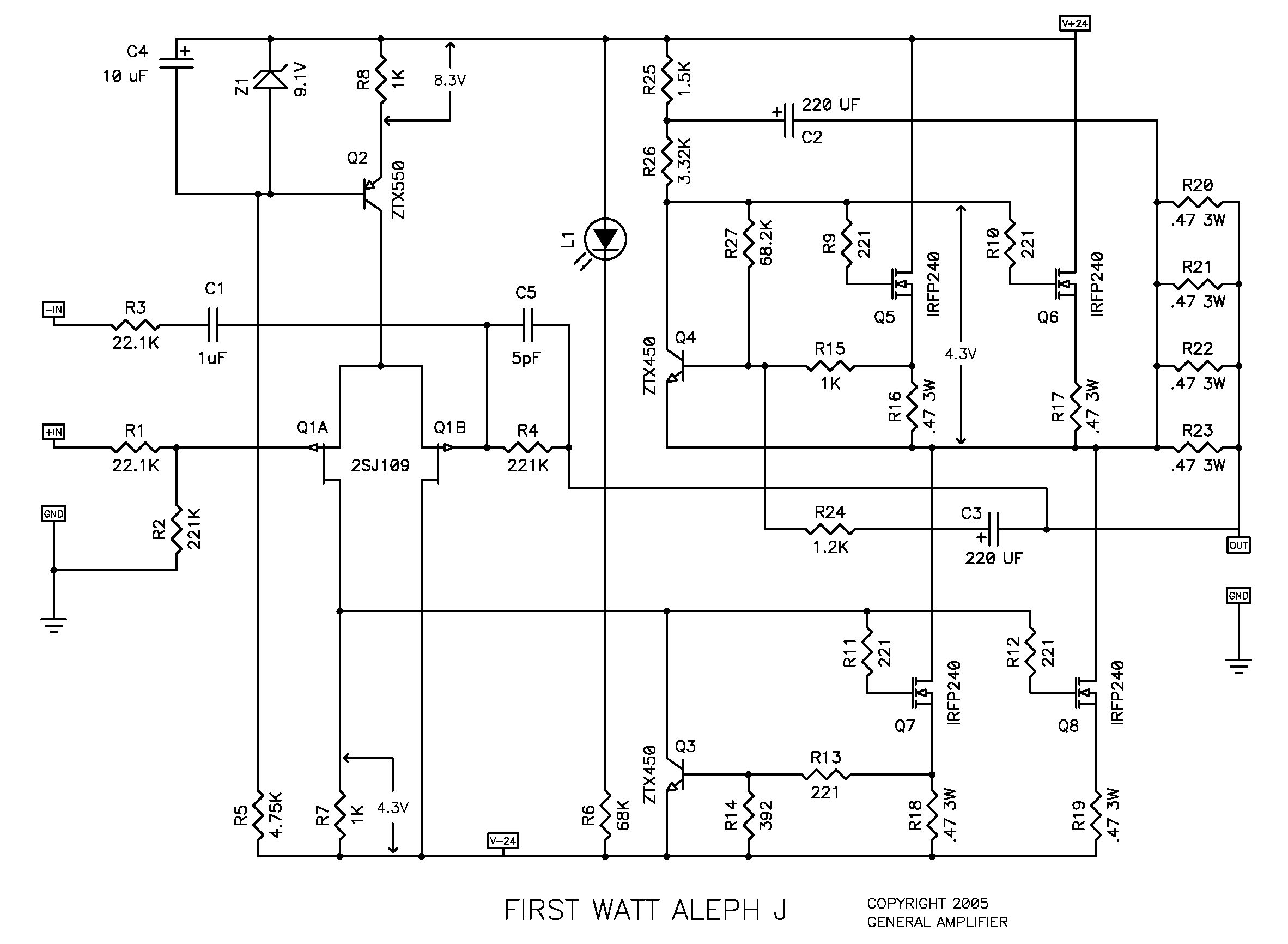

9. For Led wich one do you prefer, 2 Led (one Led for Each Rail ) or 1 Led as on schematic?
For Reference i use this schematic, but I change ZTX to BC.

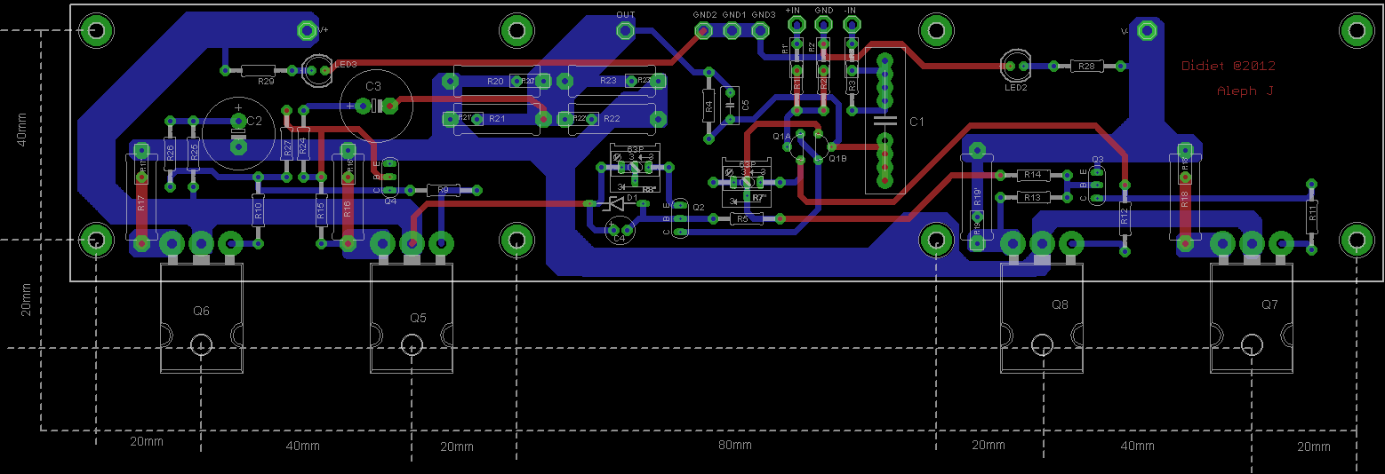

The intent of this board is that it will become the one sold in the DIYaudio store -- Hence the UMS and a few other tweaks.
Finally, an Aleph in the store? Cool!
My one request is that pads are spaced such that all the resistors will fit without having to stand them up or contort the leads (unlike the other Aleph board...).
5. C1 film as you have drawn it in most recent revision. 🙂 People will want to use film, and 1uf at these voltages is small.
6. R7 Yes. R8 ?If there is space for it...?
9. One LED each rail. Nelson said the LED as drawn in schematic was nothing more than panel lamp. With 2 they can be indicator for rails, or if people just want lamp, they can use one.

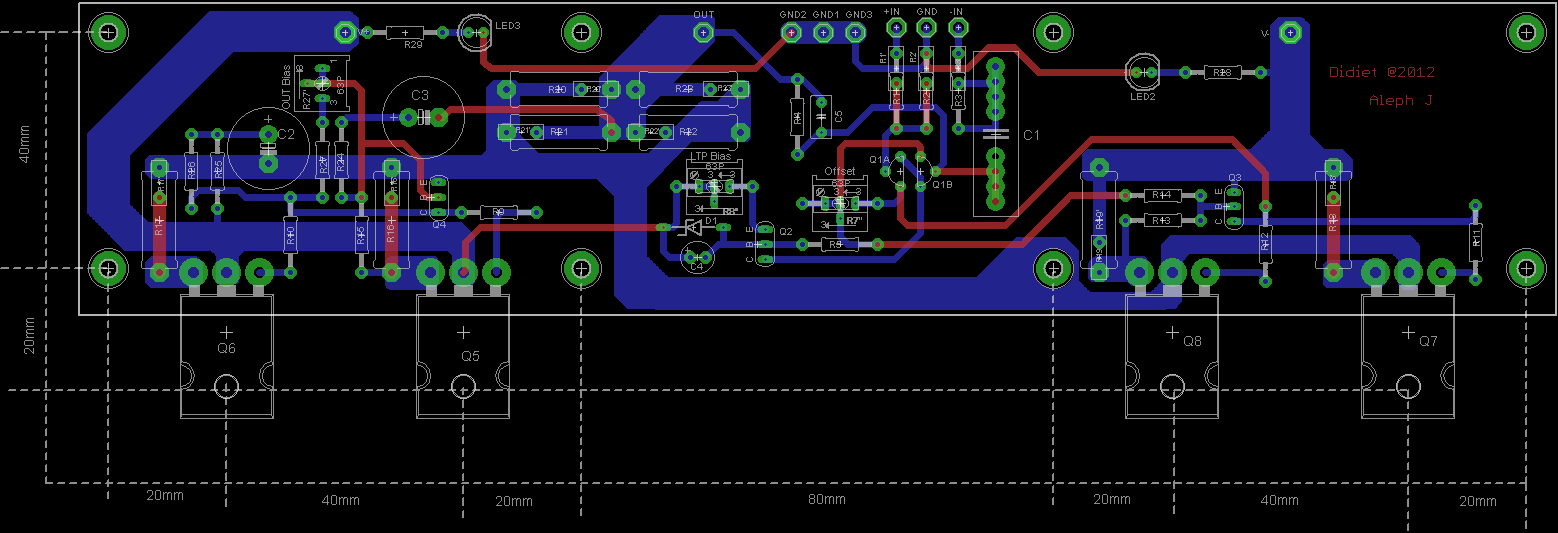

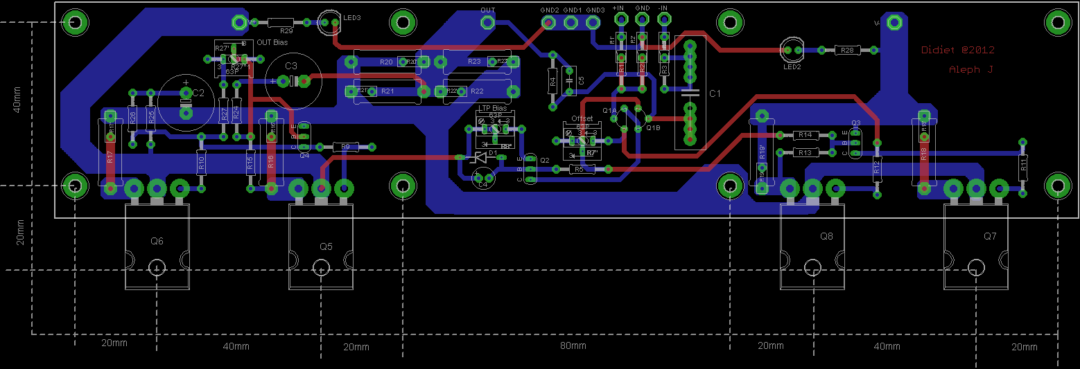

Pinout of BC transistors is CBE. Pinout of ZTX is EBC. How about leave silkscreen genderless, but mark the pinout and the channel of device. (see Q5 in photo) This is similar to current F5 F4 boards.
Also, measured from current F5 board - (And I can locate my fine rule, so I won't even guess the hole sizes)
Small resistor lead spacing 12.5mm (That will easily fit a Dale CMF60) and input resistors have 2nd set of 5mm holes for expensive Caddock or vishay square package (see photo)
Large resistor lead spacing 15mm with 2nd hole for 5mm bent knee lead square package (see photo)

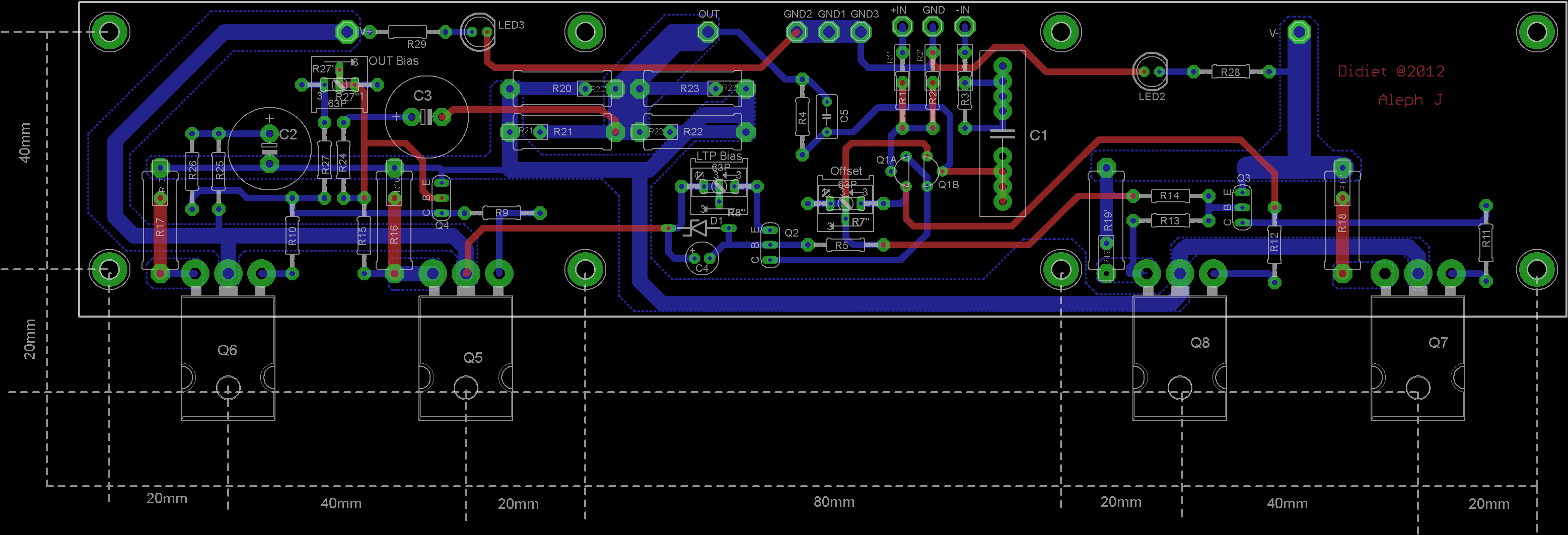

Still on progress change eagle lib :
1. Small R spacing 12mm, drill dia 1mm ?, add 5 mm spacing for R Input.
3. Big R spacing 15 mm are enough?, add 5mm R
7. Add Pinout, change silk
For drill dia : small component 1mm, Big R 1.5mm, wire 2mm ?
Didiet

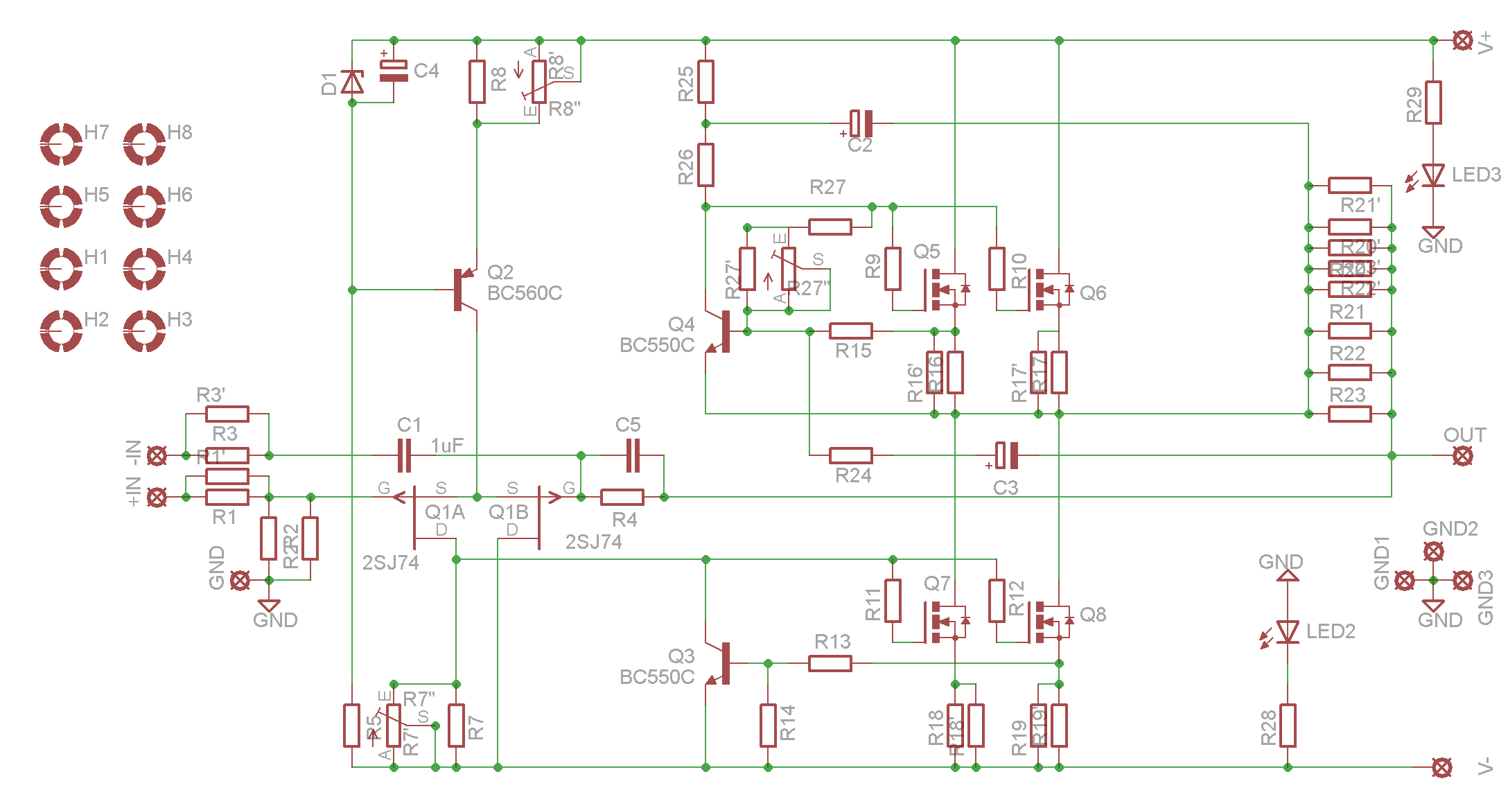

Didiet - I am waiting to get some specific answers regarding the potentiometers. Sory for the lack of communication.
Everything is looking very good so far! 😀 😀 😀 😀 😀
Once the boards are tweaked and look good I am planning on getting a pair made locally for proof of concept and prototype.
Yes, thank you! That is great. 🙂 🙂 🙂
A question -- I do not have much resolution when looking at the drawing, so I need to ask, ?Are the potentiometers being connected as variable resistors? I.E., with the wiper connected to one of the legs?
