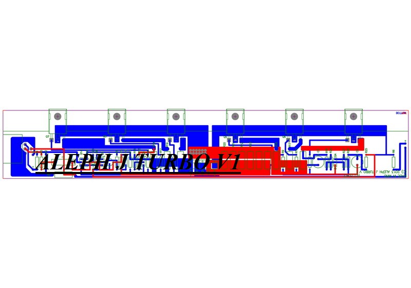

Aleph J turbo V1
This's my Aleph J turbo V1. Added 1 pairs of IRFP240 seem like Aleph 30 era. I havn't used any trim pot because all of parts are well matched and 1% rated.
Also used XLR pcb mounted socket with removable cover type, total capacitance 120,000uF a pairs.
Anadigit

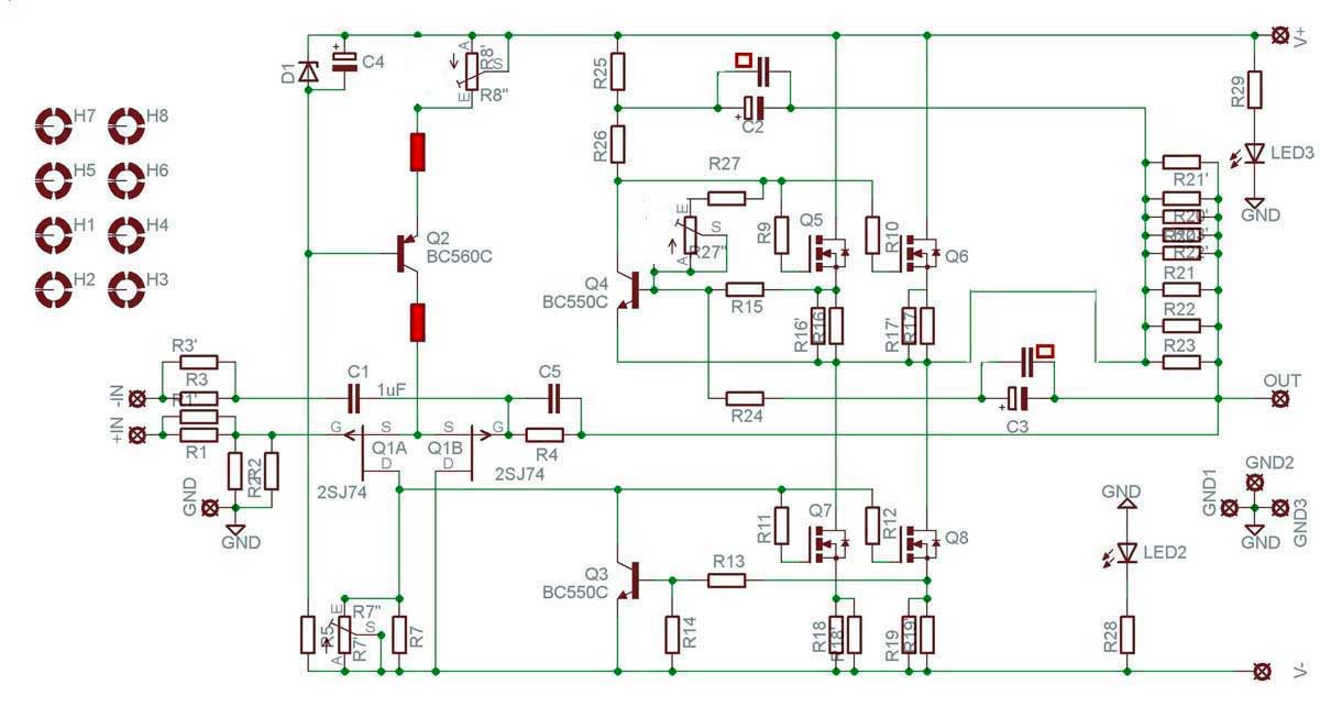

Hi Anadigit,
Some people say that one J109 in the input did not drive their three pairs of IRF at the output very well......🙁
A pair of 610 like in Aleph 30 may not have this problems. Transconductance of a pair of 610 is of course much higher, so the ratio of open and closed loop is changed....
ZM would possibly say "trust your ears"....🙂

Yes, I know there is interest in this project! That's a good thing. The current push for he store is to get the F5T boards proofed and tested, once that's rolling along by itself this will hopefully move forward.
Hang tight. 🙂 🙂 🙂

I can solve transconductance problem if it show any hint close loop/open loop gain by parallel them together.

I would be very interested. I have my Aleph 60 built on BrianGT boards. So, ideally, I would like something like main boards for J60 similar to BGT mains, so I can just swap it to try.

The scope of this project will be limited to the 'Official' Aleph J schematic - with our slight revisions... Specifically it will only be for 2 fets each in the output section and the current source. The driver will be the pair of 2SJ74, as J109 are practically impossible to source anymore.
The layout and scope will not significantly change from this -

What is the purpose of the resistors on C and E of the current source?
And why add gate resistors to jfet LTP?
I'm only asking because I'm an electronics beginner compared to most. 🙂
