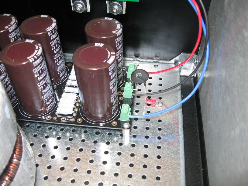

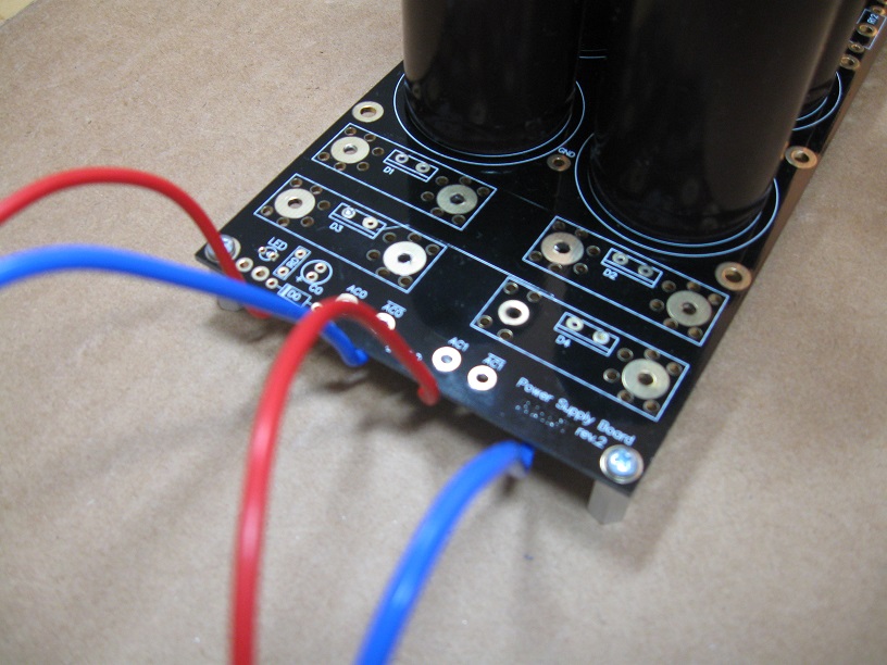

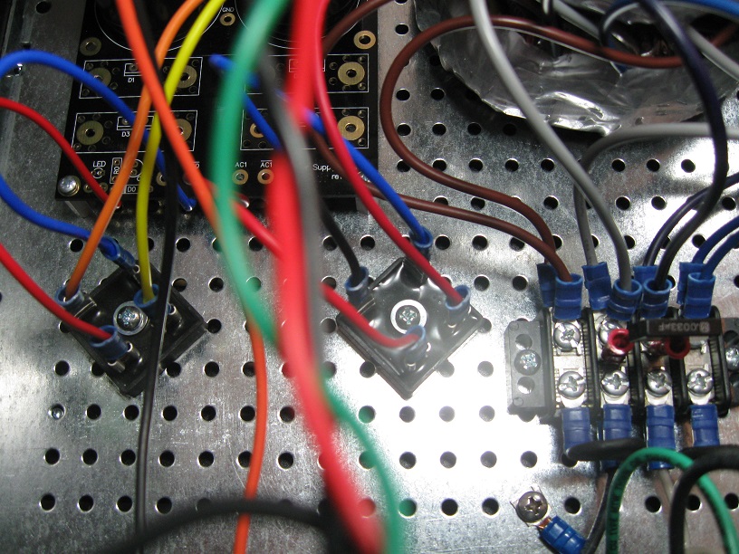

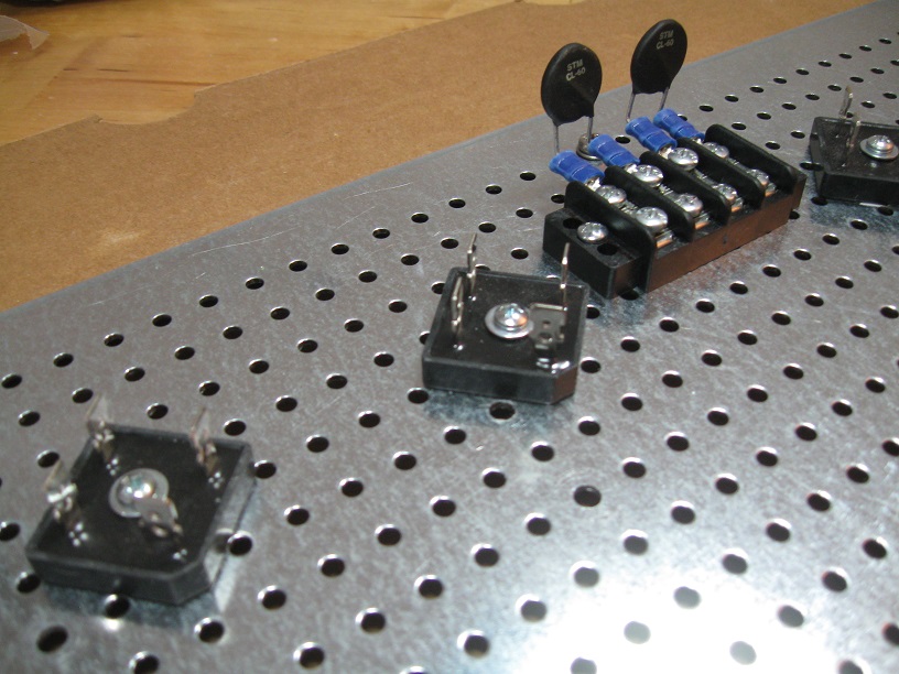

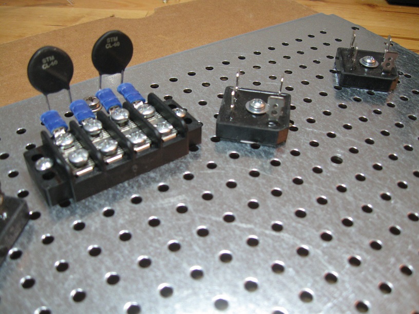

After I determined that both the Ultrafast Recovery and Soft Recovery diodes caused mechanical hum in the transformers, I removed them from the boards and attached Fairchild bridges to the chassis perforated insert.

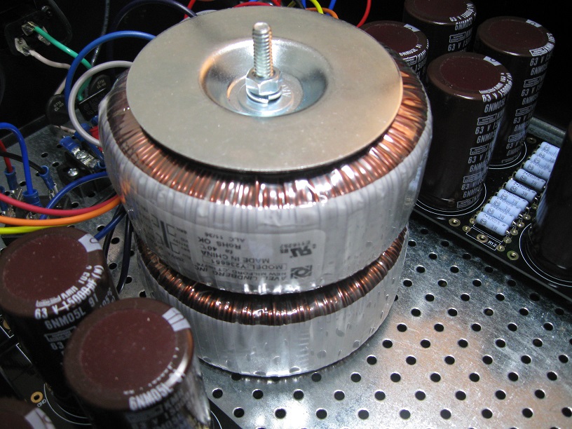

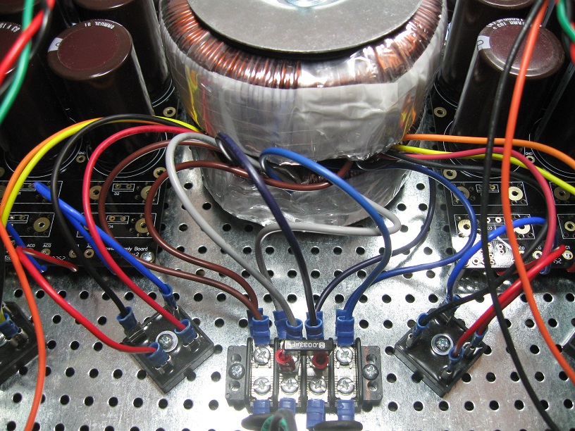

The two transformers are stacked in the center of the chassis. The top one is upside-down (yes, you can do that) just because of the limited length of the wires. What is not visible in the picture is that the bottom transformer has its own top plate, lock washer and nut installed. Using the oscilloscope attached to the output I started one channel and carefully rotated the transformer until no noise was induced into the output. I then locked it in place so rotating the top one would not disturb it.

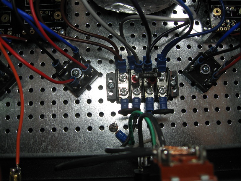

I first tried to return the PSU ground to AC ground with wires and thermistors. Dropping the CL-60s straight to the chassis floor gave me the best results.
Below you can see the AC connections including the ground connection close to where it enters the chassis.

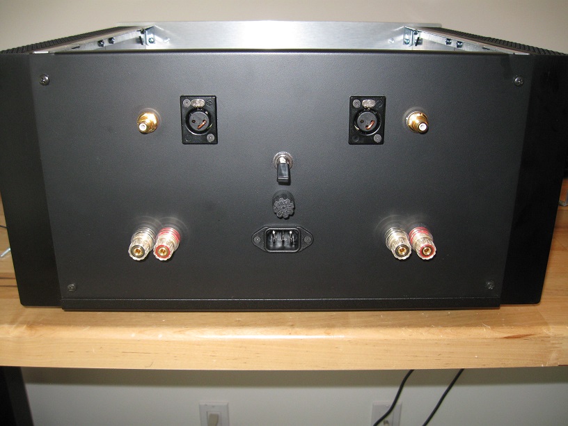

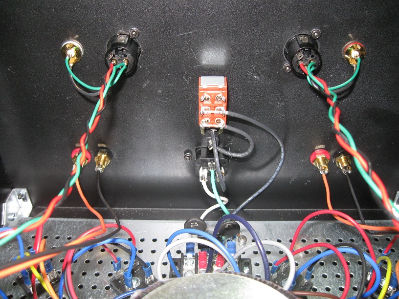

This is how the back panel looks from inside the case.
And this is the view from the outside.

3) Stacking transformers is a non-issue
4) Flipping one of them upside-down is not an issue either

I wonder though if it is not the fact that the BrianGT PSU boards forces you to use one bridge for both secondaries of the transformer, where he now uses one bridge per secondary via the block devices.
I seem to recall a previous posting by NP indicating that sharing a bridge between 2 secondaries may induce mechanical hum in the transformers if DC is passed back into the secondaries.
Very reasonable thought. You could easily bypass the onboard spot of the Brian GT boards and do the rectification off board.
A very fair conclusion. I have used the BrianGT PSU once before, with TO-220 high-speed devices and the amp (an F5) is amongst the quietest I've built.
That is only an observation - not trying to discount your idea, merely share my experience with it.
That is my understanding of it as well.

Meaning exactly what is being discussed here: a single bridge of discrete devices being overtaxed in the way they were used.
I am not discarding MUR and MSR as good diodes. I also have not tested Schottky devices. What is clear is that once I replaced the four diodes with two external bridges, the mechanical hum disappeared.
"MUR and MSR diodes are not well suited for this application"
I am not discarding MUR and MSR as good diodes... ...What is clear is that once I replaced the four diodes with two external bridges, the mechanical hum disappeared.
I'm not surprised, I have been having similar issues with the F5T, and the pair of (slow) diode bridges is helping.
I'm sure there are plenty of builds with high-speed devices that are quiet. My (very limited) experience is showing me that the normal bridges might be a better place to begin for most builders, to keep issues to a minimum.
This leads to another question - is there any TO-220 or TO-247 discrete, slow diode of suitable rating that could be used in the BrianGT boards? Perhaps the single bridge isn't necessarily the issue -- the factory Aleph's were single bridge.
