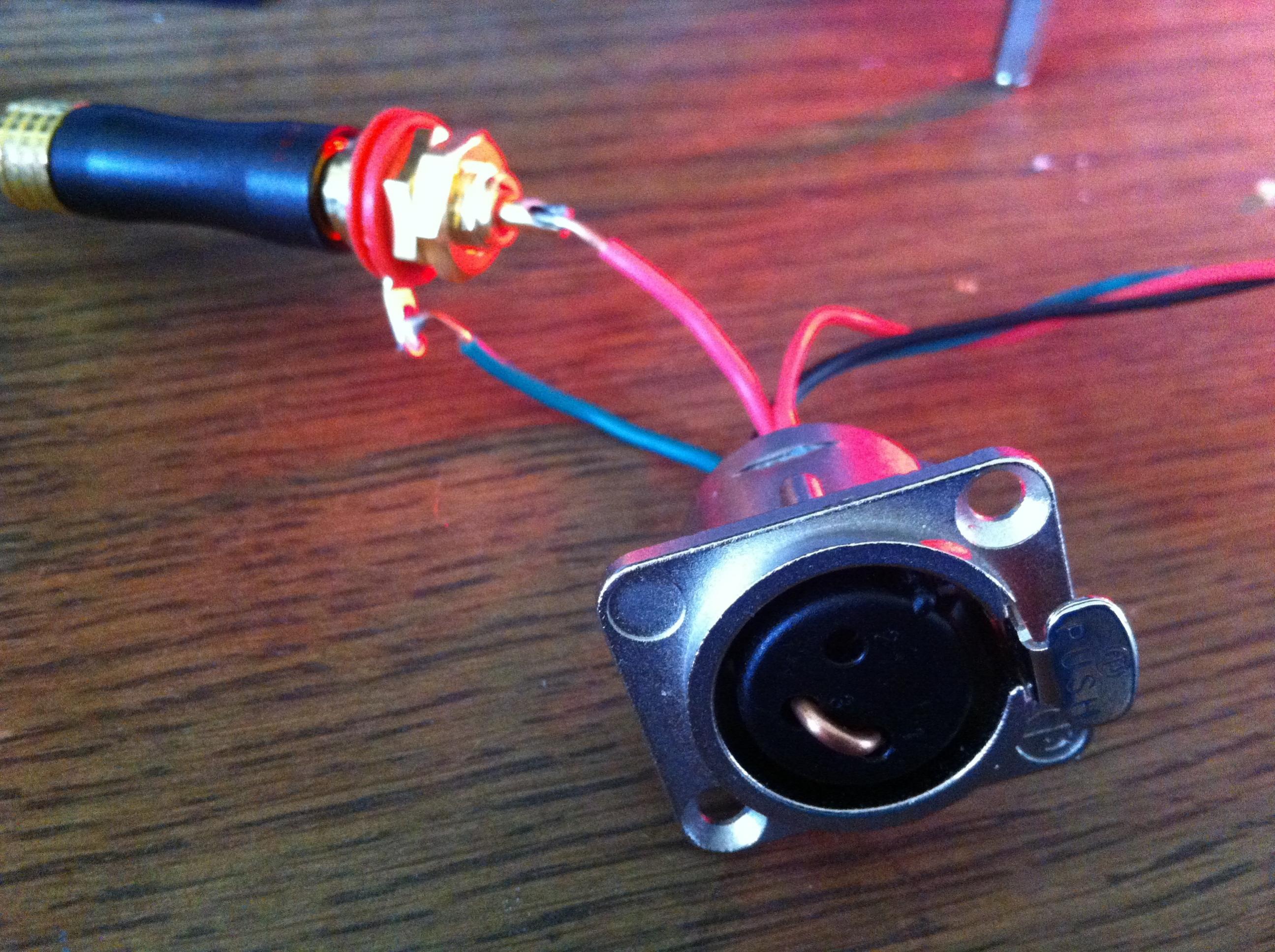

try like this :
twisted triple of wires ( +,-,gnd) from PSU to (each) output pcb , shortest possible route , not going from coast to coast);
RCAs isolated from chassis ; their GND tabs connected with one wire bridge ; from exact mid point of that bridge - one wire to main GND point of PSU ( which ic connected to chassis/safety gnd via NTC)
then shielded ( or twisted pair ) from each RCA to correspondent channel pcb , where gnd (shield ) wire connected just on RCA side
if needed - fat , shortest possible , wire as bridge connecting two pcbs main GND points
Well if you look at Nelson's amps with balanced inputs, he uses a balanced audio line from the rear panel to the circuit board, and then for unbalanced operation just sticks a jumper in the XLR connector. I imagine the resistance of that arrangement would be more than the short length of small-gauge jumper wire that 6L6 has used?
I know, just suggesting a possible issue. Hook scope up to it with inputs grounded and then plug in amp. Lets see what's happening

Yes Choky. My assumption was that his RCA's are isolated completely from the chassis. If not, it may cause some major problems, but I am sure he knows better. 😀
Ok, I was going to try that next anyway...
They already are, so that's easy! 🙂RCAs isolated from chassis
Ok, I like it! Is this different from equal length wires connecting to same point on PSU?their GND tabs connected with one wire bridge ; from exact mid point of that bridge - one wire to main GND point of PSU
Yep.(which is connected to chassis/safety gnd via NTC)
So the shield will be at same potential as GND... Very good!! 😀then shielded ( or twisted pair ) from each RCA to correspondent channel pcb , where gnd (shield ) wire connected just on RCA side
Will try that last to see if it helps.if needed - fat , shortest possible , wire as bridge connecting two pcbs main GND points
