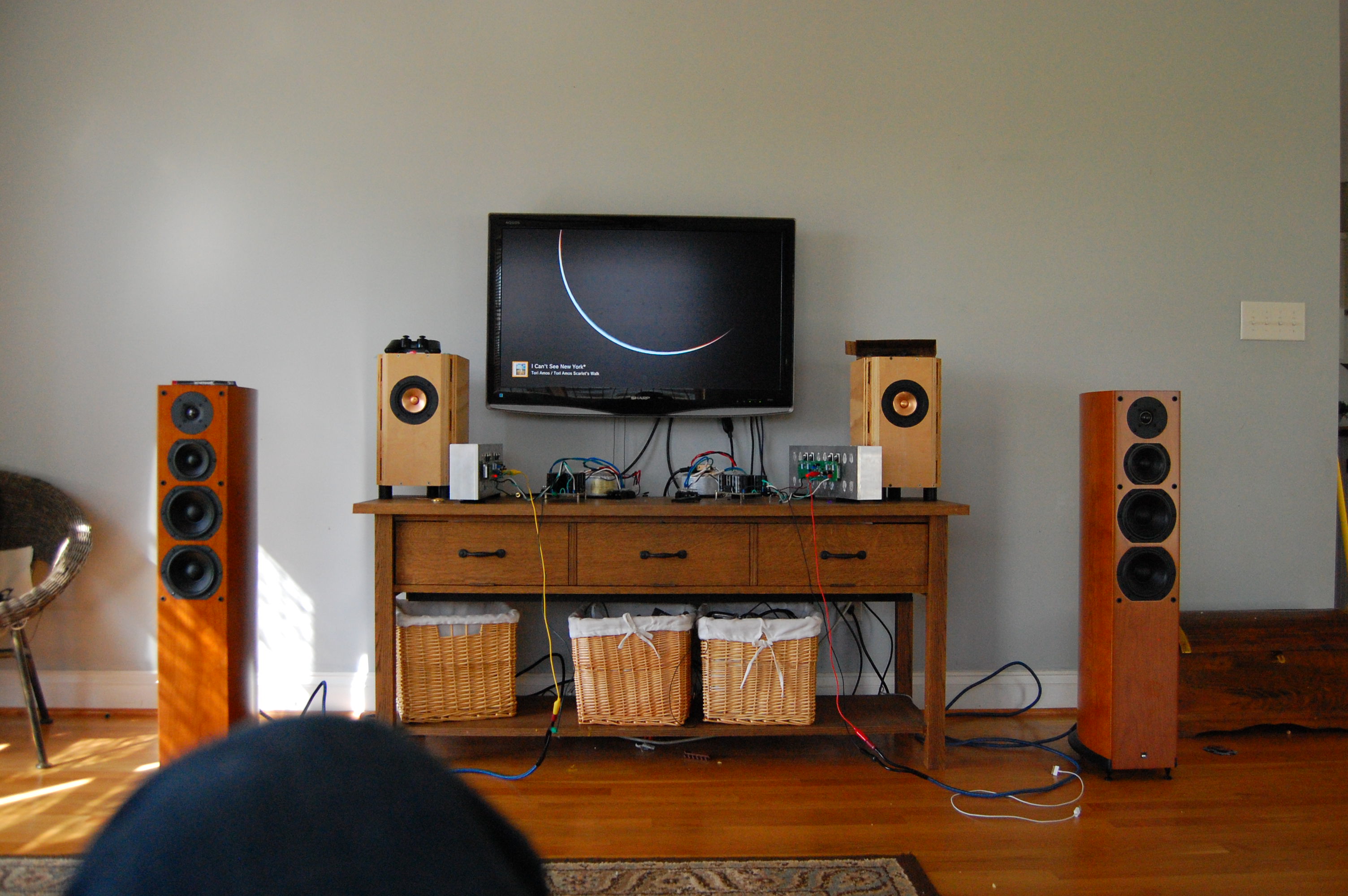

HEre ya go gentlemen. Biased perfectly. My offset is little high, as I need a little more Vgs on the gates of lower fets, due to higher Vga at current source bias. I remember this isuse before, but lickily the boards have so many places to trim all necessary biases. What can I say. I think the Aleph is one of defining sounds of Nelson.
