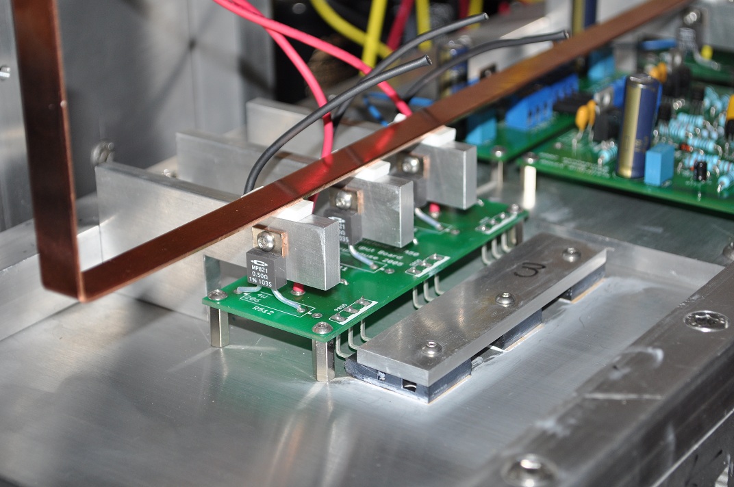

BTW, I always use the 12mm standoffs when mounting my power transistors this way and it leaves enough space. Attached is pic of my KSA50 done this way.

I have an assortment of female/female standoffs, the kind I prefer. In this case I bought a few of the 5mm male/female type to use the pre-drilled and tapped holes in the heat sink. I have already added taller ones to my Mouser project manager, to include in my next order.
Zen Mod,
I am using a case purchased from the DIYAudio store. The heat sink already has the holes pre-drilled and tapped so changing the point where the legs are bent would require more drilling and tapping. I did prop the standoffs up using washers, and it was an easy fix. However, since I had used the same exact standoffs for the F5 boards with no problems, I wanted to determine what caused the PCBs to touch the MOSFETs. Since these boards are meant to prototype the design, trimming the edge is something easy to do.

Can you trim offsetlower?
I did not install any trimpot on the board, wanted to try a standard build first. The picture was taken about 20 minutes after setting the rails at +23V/-23V and the DC offset was still going down but slowly. I was hoping the trimpots would not be necessary since I got tightly matched JFETs and MOSFETs.
Standard build would have trimpot on leg of LTP to set bias of lower get as well as adjust offset.
You are correct, in that it is unnecessary if you have perfectly matched fets, but as your build shows, even perfectly matched fets yield non perfect results. Something as simple as poor MOSFET mounting could result in mode offset. Your number is not at all unacceptable, but with pot, 0-5mV offset is achievable. It really comes down to flexibility, which will be necessary in most builds. If after adjusting, you want just resistor, it can be done and is a good suggestion.
