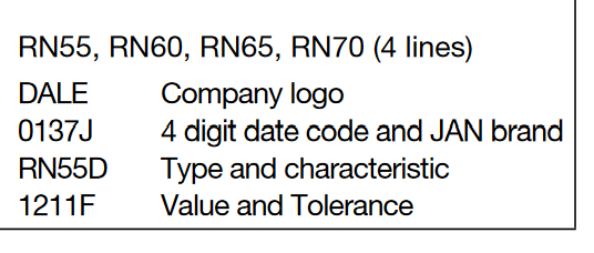

PPinto1 - disregard my previous post. My fault for not looking. I didn't see the correct code on the parts. 😀 It makes it much easier to help if for future builds you put the number with the resistance facing upward. Not your fault I read it too quickly, but it'll help in the future for things like this.
Eddyvb - still, great eyes and call out.
While 2210F isn't visible on R11 and R12, you can see both numbers on R10 here.
EDIT: 1934J is a "4 digit date code and JAN brand" where "JAN (Joint Army - Navy)"

Wowbagger - yep. I saw R9 and R10 looked good in the pic you linked, but I jumped to the wrong conclusion (read the code incorrectly) for R11 and R12. I got all excited when Eddyvb posted. I had been staring at the pics for 20 mins going cross-eyed. 😀
Ppinto - just peek at R9 and R10 to be sure they're 220R.
PPinto1 - I've checked what I could see. I'll assume the earlier miswiring and subsequent checks burned the MOSFETs and that replacing them, doing some short checks, a dim bulb check, and powering up in a controlled sequence will result in success. 😀
It'd be great if it were something obvious and visible. The solder work on the existing FETs needs some love, but you can tidy that upon replacement.
Wowbagger - thanks again - I never knew the meaning of those codes. Still, I know better than to look for anything but the "4th" line on a Dale for the value. Mea Culpa.

R9, R10, R11, & R12 all have 2210F printed on the. Sorry for the orientation.
