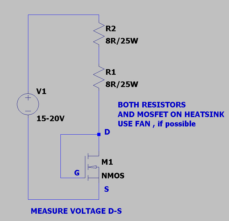

you got it wrong
positive rail - resistor - mosfet Drain + Gate tied - Source to GND
connect meter black probe to Source, Red probe to Drain

I have results. Using a 19.4v power source and a 50R resistor:
4.26v
4.26v
4.24v
4.18v
They would get warm when tested, but definitely not too hot to hold. I tested each for 30 - 32 seconds.
I don't understand how this gels with my previously finding a short between leads on one of them. I re-tested and don't see that now.
What do the measurements tell us?
you're good, more than
put both 4V26 down , rest of them up (in Aleph CCS)
how you got bogus measurements before - who knows, I'm always blaming Gremlins, not my own stupidity

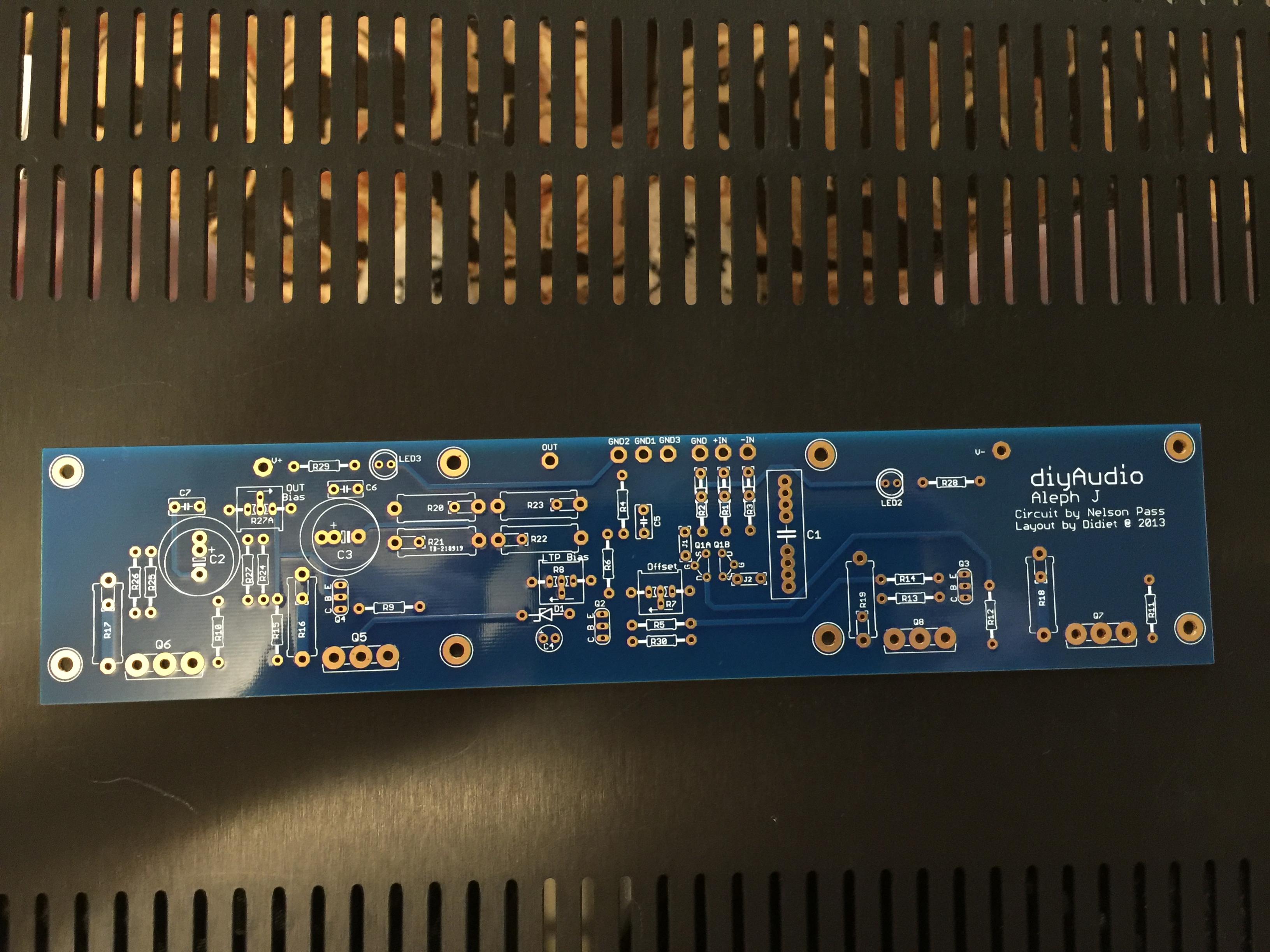

I’m not one to ignore a suggestion, though. Is there a place I can obtain a quality image of an empty board? It would help me identify component location, as the labels are mostly blocked.

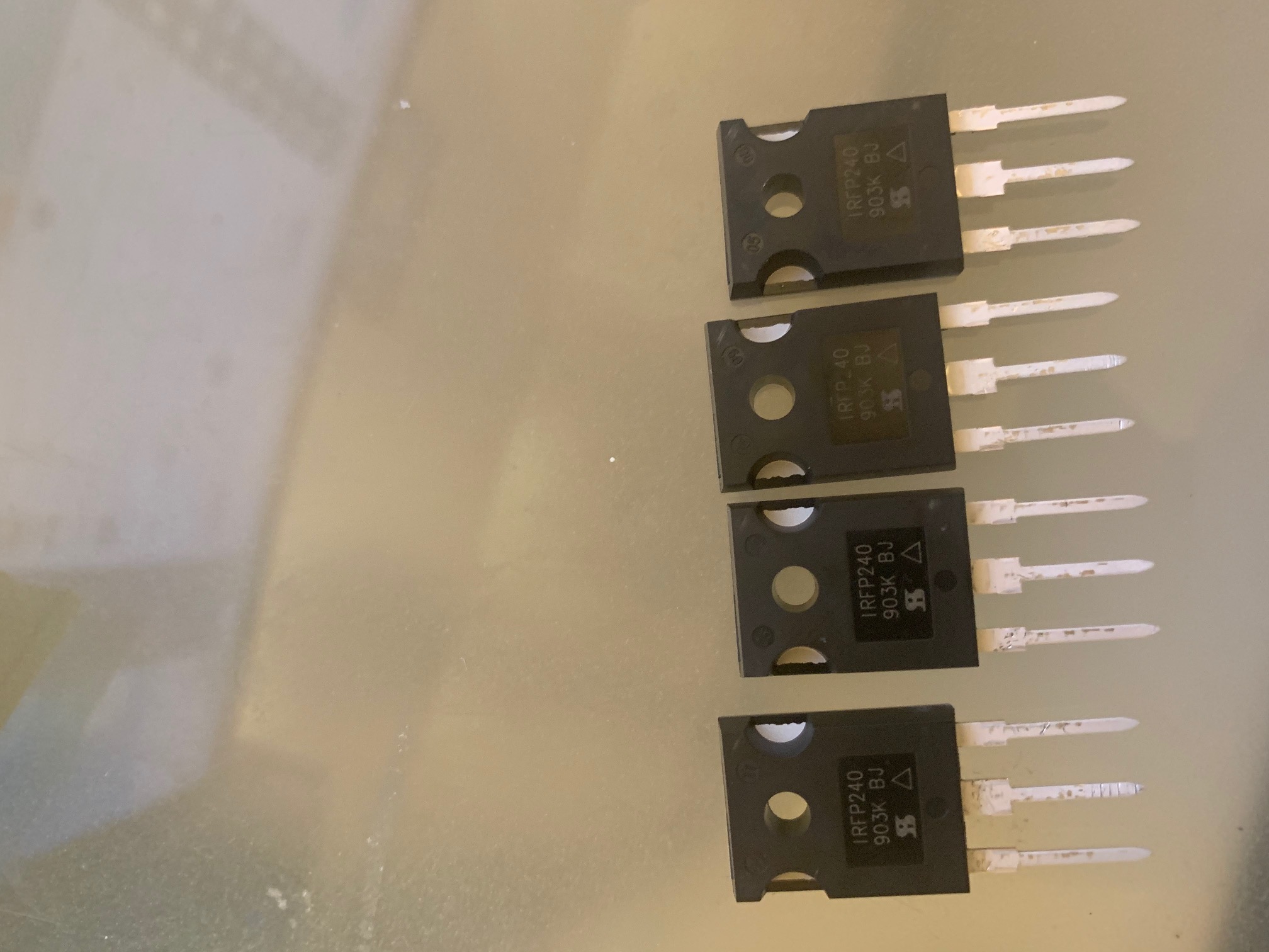

Something unexpected happened this morning. I had MOSFETs back-ordered with Mouser from my original order for the F6. They arrived. Test results:
4.15
4.14
4.14
4.14
Guess who's plugging in their soldering iron!
