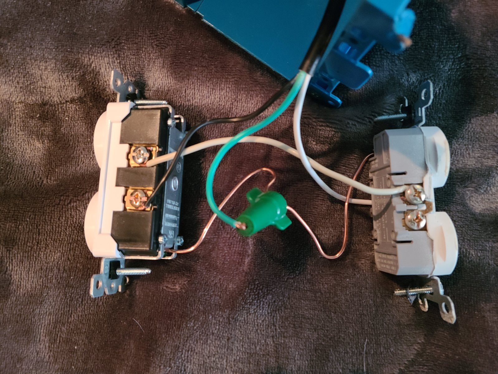

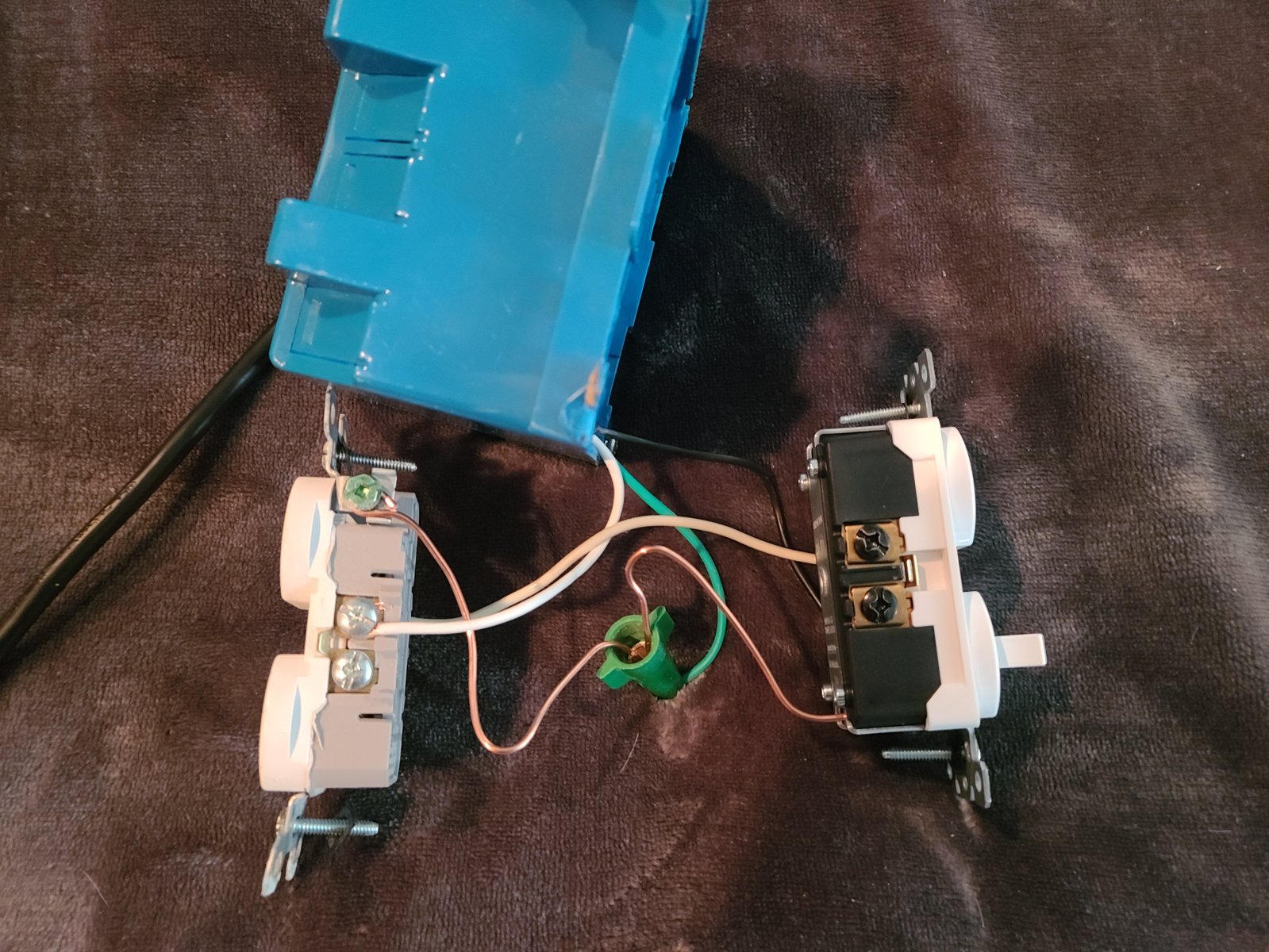

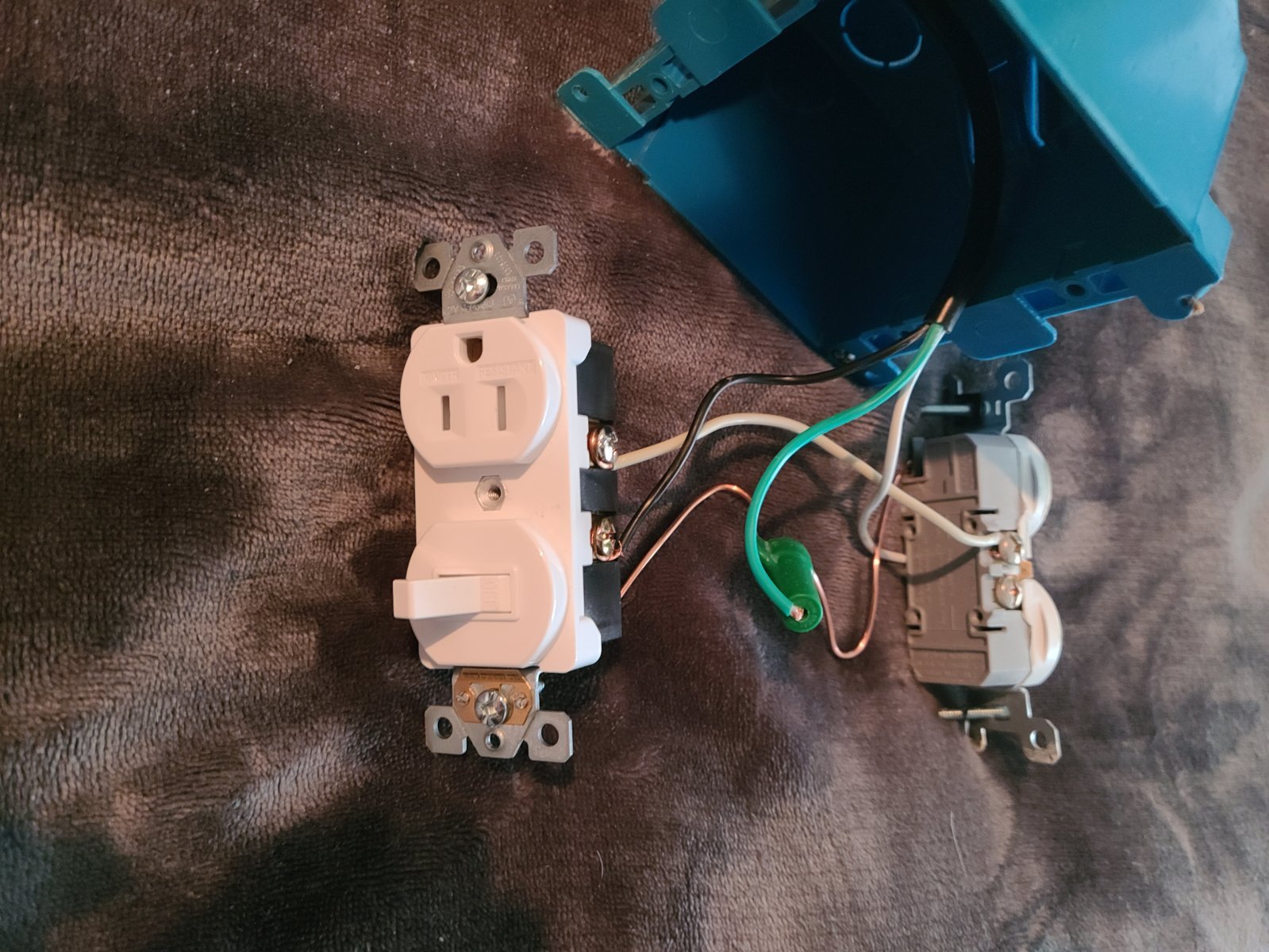

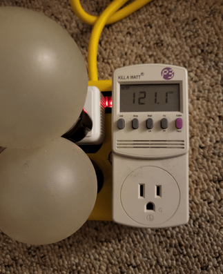

Attached are pics that should help????
20240421_162514 (FILEminimizer).jpg20240421_162536 (FILEminimizer).jpg20240421_162545 (FILEminimizer).jpg

Are they different wattage? Is the first bulb limiting the current such that second (higher wattage?) bulb just doesn't have enough electrons to heat up the bulb filiment for the one in the duplex? If so maybe it's working and the little bulb is protecting the big bulb 💡 😉
I have confirmed with a meter, with nothing plugged in to the duplex I get 0 when switch is off & 110v when switch is on. Plug something in to the duplex and the bulb, switched side, lights but there is no longer voltage across the duplex outlets.
[Thought Experiment Only]
Let's say you plugged a paper clip in the duplex outlet to bridge the outlet and complete the circuit (Anyone reading this, please Do Not do this!), what voltage would you expect to get across the paperclip?
The "something" plugged in probably matters for the Vac measurement your taking.
My only use for the dbt to date has been testing power supplies on initial power up. I've taken a few readings with various loads and the device appears to be very well suited to testing a linear supply on start up and little else.
The 40R of a 25W bulb will barely allow enough current turn a 15w fan. We'll below the speed of the ~ 7.5 watt low setting. Two such fans will light the bulb but do not operate.
The same two fans will run well below the normal rpm and dimly light a 100W bulb.
A 20V 200va transformer, FWB and a single 15000uF cap will briefly light the 25W bulb as the cap charges. Using a 100W bulb, the cap charges without lighting the bulb whatsoever.

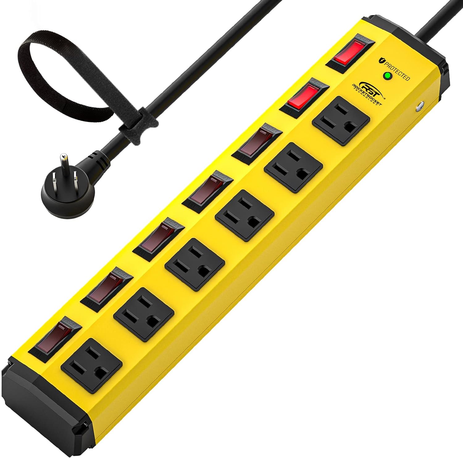

My suggestions:
1. Plug in a "kill a watt" into the duplex receptacle, and plug the device under test to the "kill a watt" to monitor its Voltage, Ampere and Wattage.
2. Plug a power strip with individual switches and some incandescent bulbs (25W, 40W, 60W and 100W) into the "bulb" receptacle to select any wattage combination for testing.

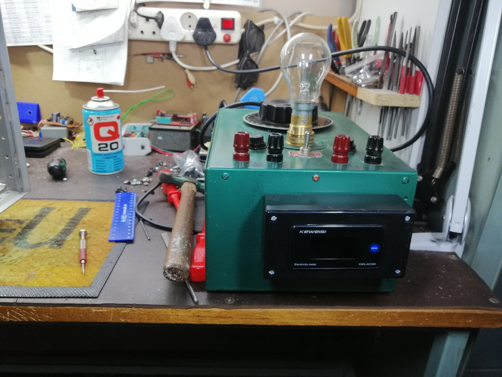

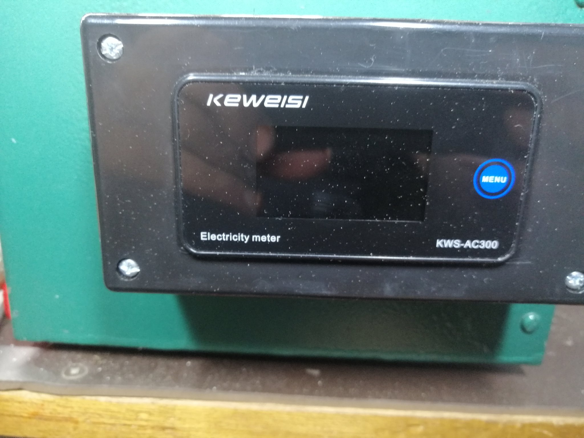

This is my 1kva jobbie, using a cheap Ali-express meter for power factor, amps, volts and some other things, has helped me to prevent " blitzen und sparken ", works great to work out transformer primaries without surprises. I use two outputs, one through the bulb and the other direct, works for me.
