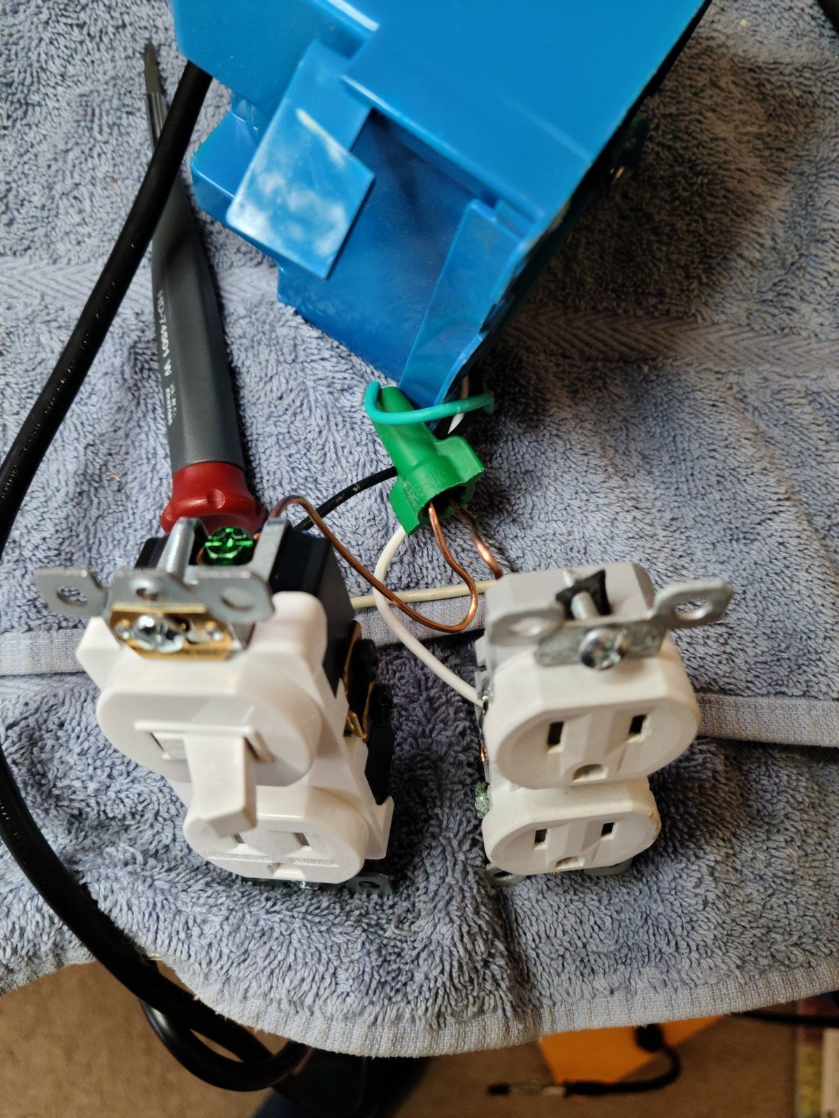

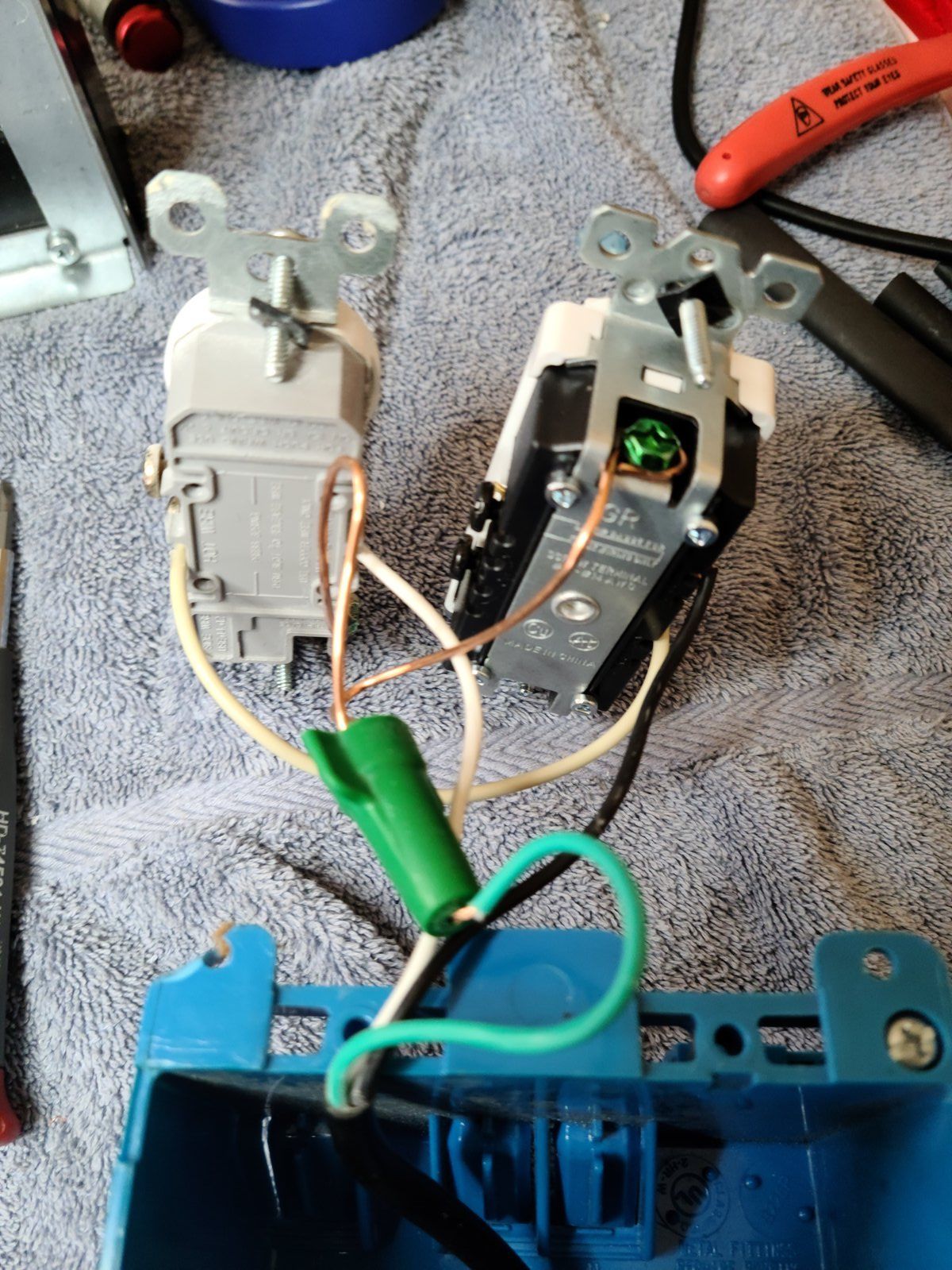

My pleasure... proper grounding and bonding is key in regards to safety. BTW, If your box is metal, it will also need a ground jumper. While I'm at it... don't buy the cheap outlets with push in terminals (backstab) spend a couple extra bucks. Screw terminals with pressure plates always and never gauge the quality of the connection by screw pressure alone. Pull on the wire-
Love my Klein screwdriver with the little widget for putting a bend in wires... and bend the wire ends around the screws.
Adequate but second tier. If you're using a stranded wire ie: thhn or the plug in pigtail youre most likely using, a crimp connector is required for a std screw terminal. Pressure plates provide a more secure connection and accept strd or solid.
Grab your 25W bulb and socket and plug it in to the switched outlet. Reading resistance from the upper and lower screws on the input side should alternate OL- ~40R as you throw the switch. When that's done, the hot will run from that upper screw (outlet adjacent) to the brass or black screw on the duplex. This will correspond to the narrow blade. The neutral will tie down opposite under a silver screw and will correspond to the wide blade and will be a single wire direct from your pigtail. The switch/outlet side does not get a neutral connection.

I'm really only familiar (and happy) with the solid conductors we used to specify for the building systems we designed.
I bow to your superior experience with stranded conductors. "Pressure plates"? The wiring devices I'm know only have a screw that secures against the brass component (or structural frame for the "green" ground screw) of the device.
@mhenschel They're fine, I'm just picky. Power and light isn't my everyday thing but when it comes up, it's usually pipe and stranded thhn so it's either crimp and heatshrink everything or use devices with pressure/contact terminals. The same applies to corded setups like this but a couple of crimps at the workbench are nbd. I dropped wirenuts for wago lever locks for the same reason and will never go back

Of course it won't work on stranded, the stranded wire is from the plug gnd wire coming from the wall outlet, whch I tinned before attaching.If you're using a stranded wire ie
@Toys4Boys right on, all set there? The dbt is such a useful tool. One of the few areas in life where I rarely make a mistake is wiring but I still lean back and close one eye when I throw the switch. Probably shell shock from connecting a cap bank backwards ~15 years ago...
