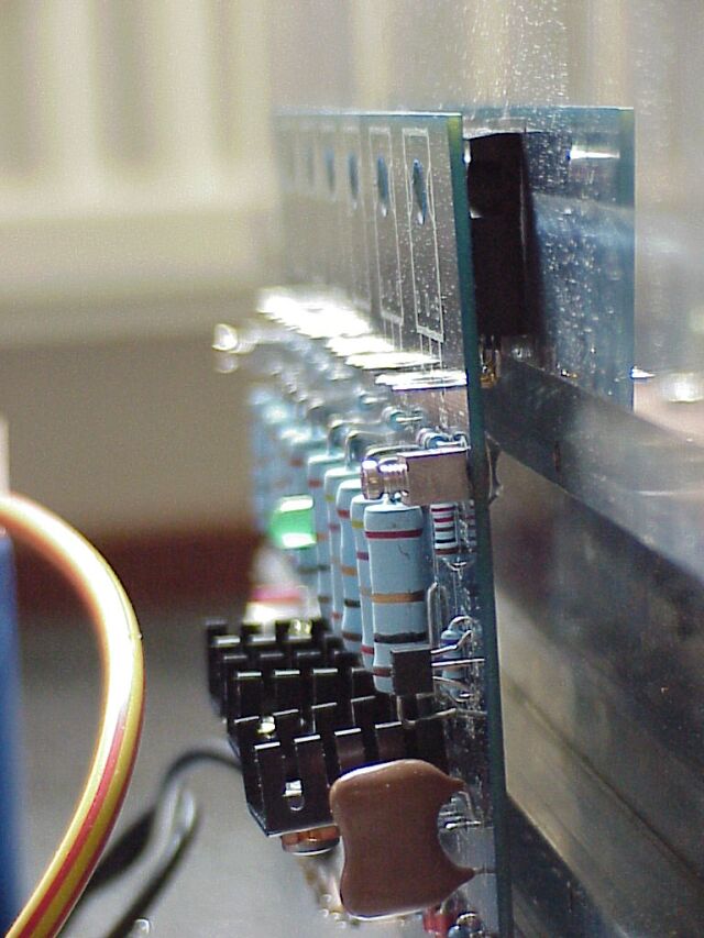

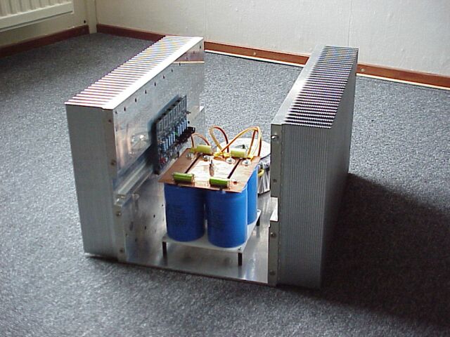

Just mount the second PCB and we're ready to enjoy
Cover and front panel will take a while because they're milled, anodised and laser engraved.
Only problem is that the guy making these panels isn't a full time DIY'er. Guess i can listen to the Aleph without a cover too
Grtz
Nick

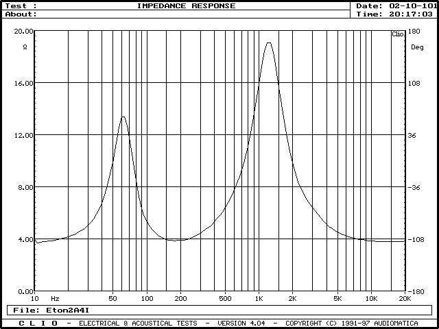

Lucas,
Aren't you worried that its a 4 ohm speaker?
And are you also going to build the sub with the 12" Eton.
Edit O, yes you wrote so in the speaker thread. Active or passive Xover??

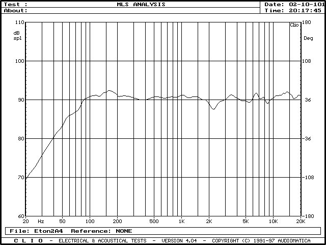

Hi Duck,
I was a bit concerned that it is a 4 Ohm speaker. That is why I changed the bias-setting of my Aleph 5 according to the experiences of WuffWaff...
I am really satisfied with the sound now, although I am of course still missing the sub 100 Hz area... But that will change!
I am still not sure what kind of subs I will build...
Maybe two 20 cm woofers a piece. Or maybe 2 times 25 cm.
It will surely be an active system.
They will stand, of course, under these "satelites".
It must a system capable of delivering 30 up to 150 Hz flat.
Any suggestions appreciated!

The bias boost will help I guess.
Frequency graph looks very good.
I'm just planning to build me a 3-way system (with partial active Xover) with these units. Nothing definite yet, still has to finish my Aleph5 first. (see here for some more info)
PS You actually have an f3 of somewhere around 80 Hz now (maybe a little better because of room boost)?
Hi Duck,
Regarding the bias boost I still don't fully understand the function of R19. That is why I just posted a question here:
http://www.diyaudio.com/forums/showthread.php?postid=159195#post159195
Yes the f3 is not that low. However the two octaves from 20 to 80 Hz are dearly missing since they can bring so much more depth and emotion to music. Also they effect our perception of the higher frequencies since we can pay more attention to higher frequencies because our mind is not burdened with filling in the ground-frequencies of bass-tones of which we hear inly their upper harmonics... So I am keen on getting this done as well.
