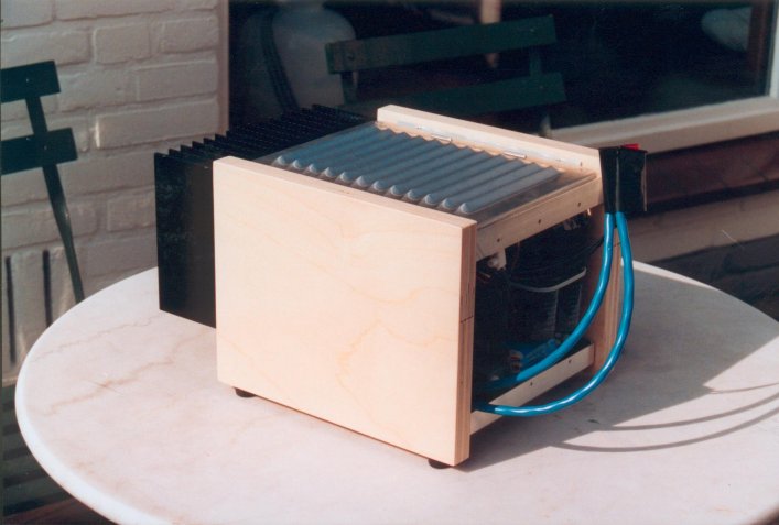

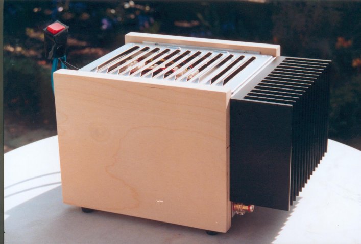

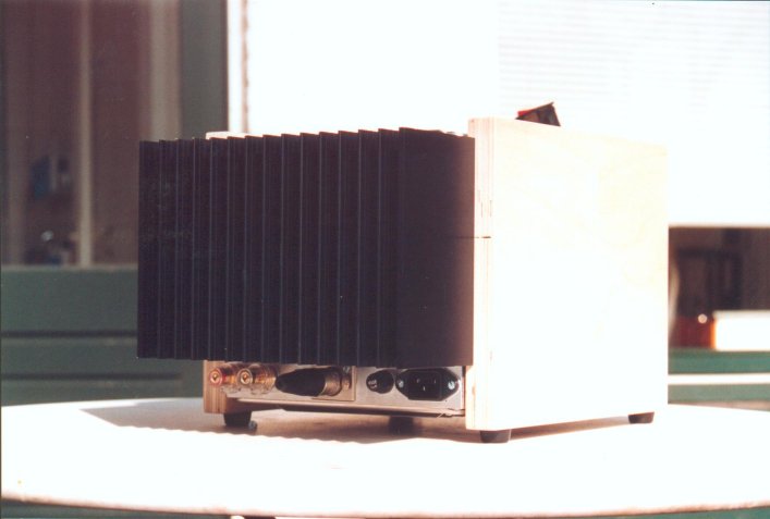

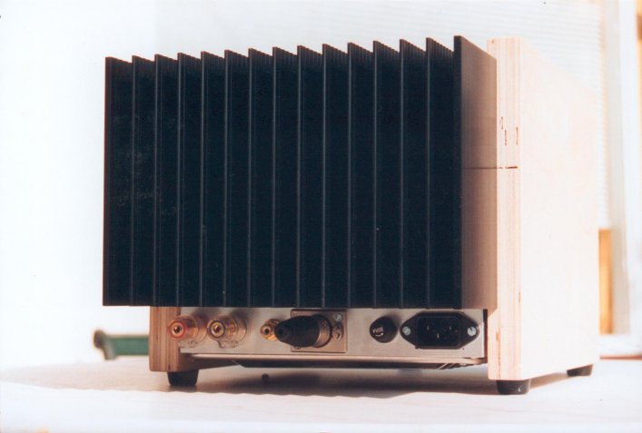

Hi Duck,
I have made some better photo's with the sides attached; now the ugly duck has found out it's a.... 🙂
But it will take some time to develope/print these and scan them 🙁
Furthermore it was I who sidetracked this topic, so never mind!

Can't wait to see them. Did you play it a little longer? I was wondering why the red copper strip. Is it better then sticking the mosfests directly on the heatsink? Would you also do it if you would mount the mosfets p2p?Lucas_G said:
Hi Duck,
