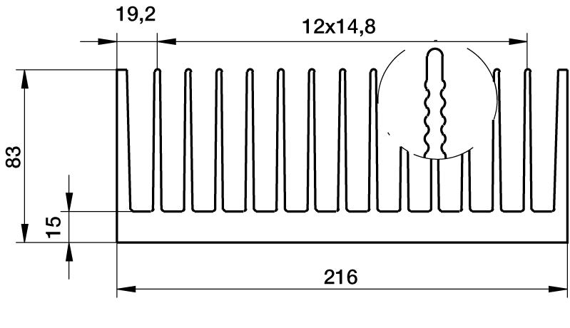

How long was your amp running when you measured the your 47 degrees?
More than a hour?
What was the ambient temperature in your room?
What did you pay in euro's for the heatsink?
Thanks,
Edwin

Hi Edwin,
The amp was already running for a couple of hours.
The ambient temp in the room was 20 degrees Celsius.
I paid appr. 60 Euro per heatsink.
They also sell a 300 mm long model, called KL 271. It is not much more expensive, and it has a C/W of 0.11
Lucas.

Glad that the Seiferts are truthfull about their Cw value, because I have a pair the 300*200*83 mm KL271 for my Alpeh5s. Notice you also have some "spots" (beschadegingen) on them.
My youre amp is ugly btw 😉 Maybe I can make an even uglier one 🙂
PS The Seifert KL271 200 mm high costs 65 euro excl. taxes

Hi Duck,
Yes, there were already some spots on them when I received them.
I guess you can can fix these with the help of a permanent marker lik an Edding...
I will do that only after finishing the outside of the amp (concealing what you seem to be finding utterly ugly
Lucas

Hi Duck,
That is going to be damn impressive!
So you use 2 pieces of 150 mm Seiferts on each side...
That should give you a C/W of about 0.06
This is a bit of overkill for an Aleph 5.
Even if you decide to rais the bias, as I did, your Aleph 5 won't dissipate more than 200 Watt. That means that your heatsink will reach a temp of appr. 200 x 0.06 = 12 degrees above roomtemperature. With 20 °C your amp will reach 32 °C.
This is bit low for getting up to its best sound, I think...😱
Why don't you use all that capacity to built an Aleph 2 instead.
You could even use your Kristijan Aleph 5 boards for that. You would only need to add an extra 6 Mosfets per channel and change some of the resistervalues...
Have you ever thought on building two monoblocks instead of one supersize stereo?
The weight of one stereo should easily exceed 50 kg. Hope you have got your back well insured for this 🙁
Good luck on building!

Its even worse, they are 200 mm high. We didnt think that the C/W value actually was that low (as on the graph).Lucas_G said:
Have you ever thought on building two monoblocks instead of one supersize stereo?![]()
Lucas

Hi Duck,
The 30 Volt Tranny would be just fine. it would deliver some 40 VDC when joined by all your caps.
This is some 10% less voltage the the original Aleph 2 but that only means you will have a slightly lower peak powerrating.
Since you have such extroardinary cooling-capacity, you could also choose to built an Aleph 2 with an extra high biasing, easily driving all kinds of loudpeakers and with massive slam and super soundquality! Do consider this.
How much VA rating do your trannies have?
If they have 500 VA or more they would easily do.
Lucas

Hi Duck,
You probably could do with 8 instead of 12 mosfets per channel.
Especially if you keep the temp down, because of your oversized heatsinks, they would survive 1.5 times the dissipation.
But why don't you use 2 times 6 mosfets for one channel, and then buy another two times 6?
Your pcb is wonderful for an Aleph 2. Take a look on Kristijan's site and you will see quite the same for his Aleph 2 boards.
You will only need two driversboards (easy to use standard breadboards) or just make p2p connections like many here have done (attach mosfets on heatsink and then solder copperwire in three rails with little connections to the pins of the mosfets.
Lucas
