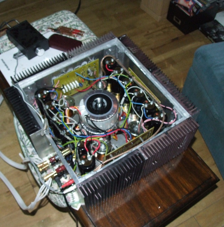

Detail of how the Current Source and Signal MOS-FETs are connected to the Main Amplifier board.
The amplifier is designed symetrically so the second channel is a mirror of the first.
I'm confused as to what the LED is indicating.
At IDLE the Cathode will be at approx 0V so the LED will be ON.
With a large signal the Cathode will vary between close to +Vcc and -Vcc so the LED will appear to FLASH with the music.
Should the Cathode not be connected to 0V to indicate POWER ON ?

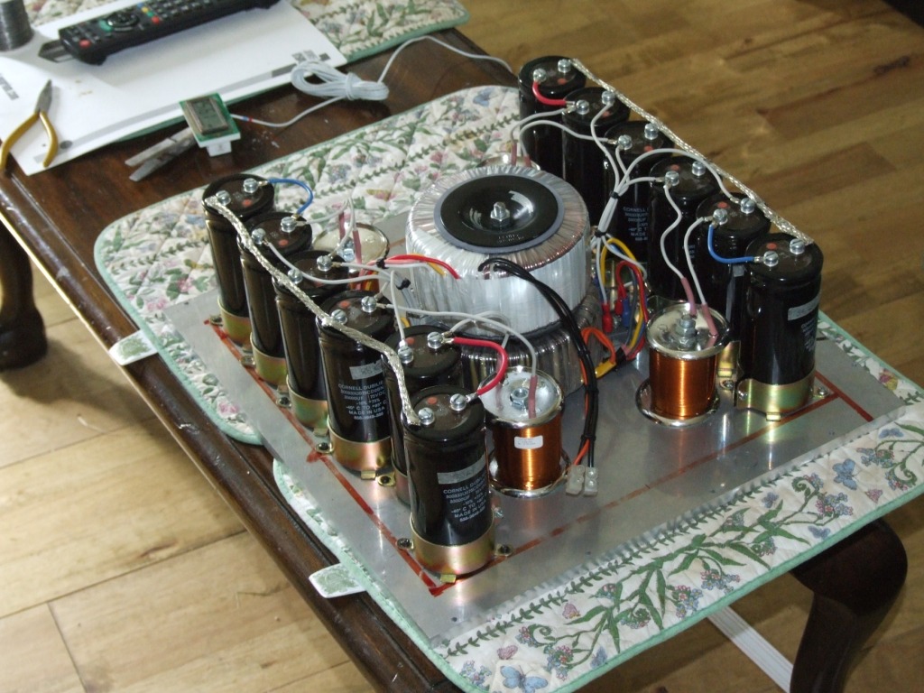

Power Supplies
At long last I've completed the Power Supplies.
I don't know how I'm going to lift this beast once it is complete. The Heatsink Assembly is almost too heavy to lift and this Power Supply is positively hernia inducing.
Interesting in the diagram that I am working to, there are no PSU chokes. I'm only using them as the KK-PCB Power Supply includes them.
Would I be better removing them and allowing the PSU rails to increase to +/-45V.

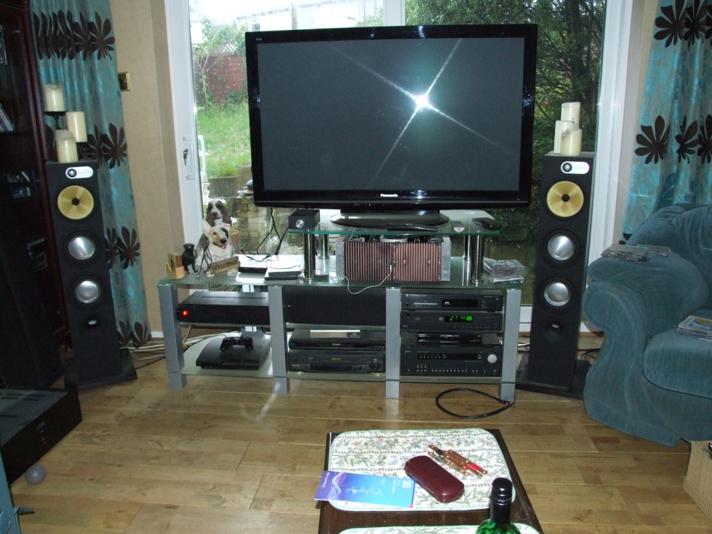

I just can't turn it OFF.
Well, the technical bit has been done and its soak testing after my disasterous mistake. I still can't believe that I didn't do more damage.
The test system is
ARCAM FMJ CD36
SHUNTKY / PUMPKIN Pre-Amp
PASSIVE 100K LADDER ATTENUATOR
B&W DM683 Speakers
The results are STUNNING
There is absolutely no audible noise when there shouldn't be.
BASS SLAM is amazing - no need for the subs anymore, not that the 683s are shy on BASS at all.
The 683s share a lot of technology from the Nautilus (the surroundless Midrange and the Nautilus Tweeter). The Aleph 4 controls these extremely well and the sound is both beautiful and lovely to listen to. I've got them bi-cabled with QED Qudos cables but 15A ring main cable is very good as well.
There is no audible sibilance. Piano sounds like a piano.

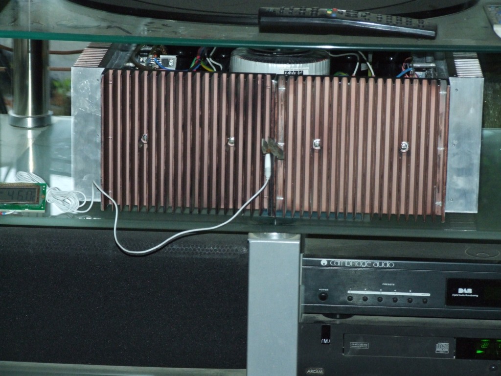

I've got these biassed at 2.4A and the heatsinks are comfortably warm.
Total draw from the 240V mains is 1.6A (so 380W)
When I can stop listening to it I'll get around to fitting the top cover and painting it.
No-one's going to pinch it - It weighs 48Kg.
It's getting near to my "Granny" neigbours bed time, I'll have to turn it down soon, but it's only running at (Nelson's Sweet Spot) around 1W or so. 5W with the 683s is LOUD. I haven't even attempted 50W as its just too loud to listen to. It's nice to have the headroom though so that the sound is both musical and unrestrained.
