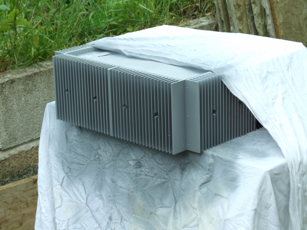

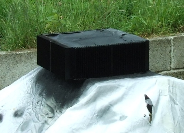

A lick of paint and she's almost done.
It's amazing what a lick of paint can do.
Just the final Black to go. And of course a lid.

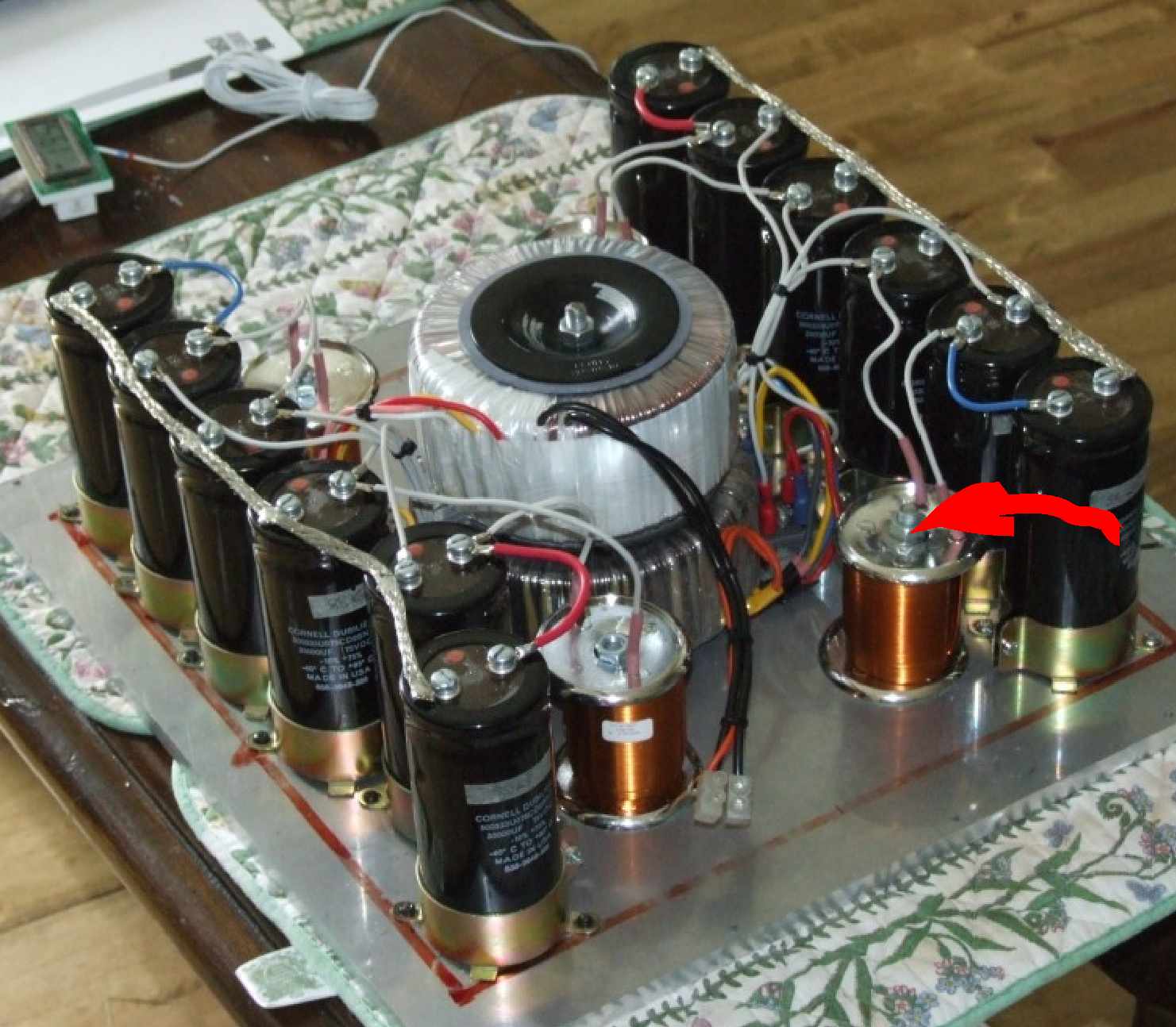

How else would you suggest mounting them. They were supplied as coils of wire with no mounting arrangements.
I could "pot" them with a steel nut and then bolt them to the bottom of the chassis.
There isn't enough "Real Estate" to lie them down.
Suggestions are always welcome to improve the project.
The big washers by the way are plastic. I appreciate that the steel bolts will become magnetised in time, especially with 2.4A passing through quite a few turns of coils.

PS: I would have sympathy for the suggestions of (1) finding more ventilation above the amp, i.e. get it out from the current location under the TV, (2) cutting adequate vent holes top and bottom of the chassis to reduce internal T and (3) finding another mounting arrangement for the chokes.
It might look tight in its confinement but the fins on all sides have clear ventillation and heat is not a problem.
If the Chokes have become magnetised could that be the problem in the CLCC configuration.
Nelson doesn't use them, I might just try running the same CCC configuration that I did with the A700. It worked fine with that amp.
