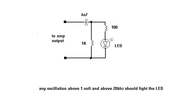

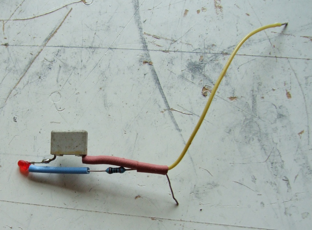

I don't know which problem you have , especially if you can't see any oscillation ;
anyway - good trick for detecting oscillation is written here : http://www.diyaudio.com/forums/soli...r-high-end-audio-equipment-4.html#post1384373

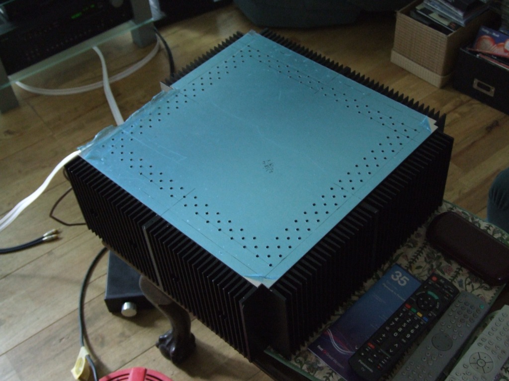

Time to see if I've drilled enough holes in the lid.
A good trick here is to make a template rather than rely on all your holes lining up. I bought one of those steel plates that DIY builders merchnats sell fro joining two bits of timber together (cost me £2.00).
I've drilled 4.5mm holes to stop little fingers dropping little things into the amp.
I'm not a thermodynamisist. Are the holes big enough or should they be bigger.
There is very little space on the base plate for holes so most of the heat must be radiant rather than convected.
I never go over 3 mm. To danger... 😉

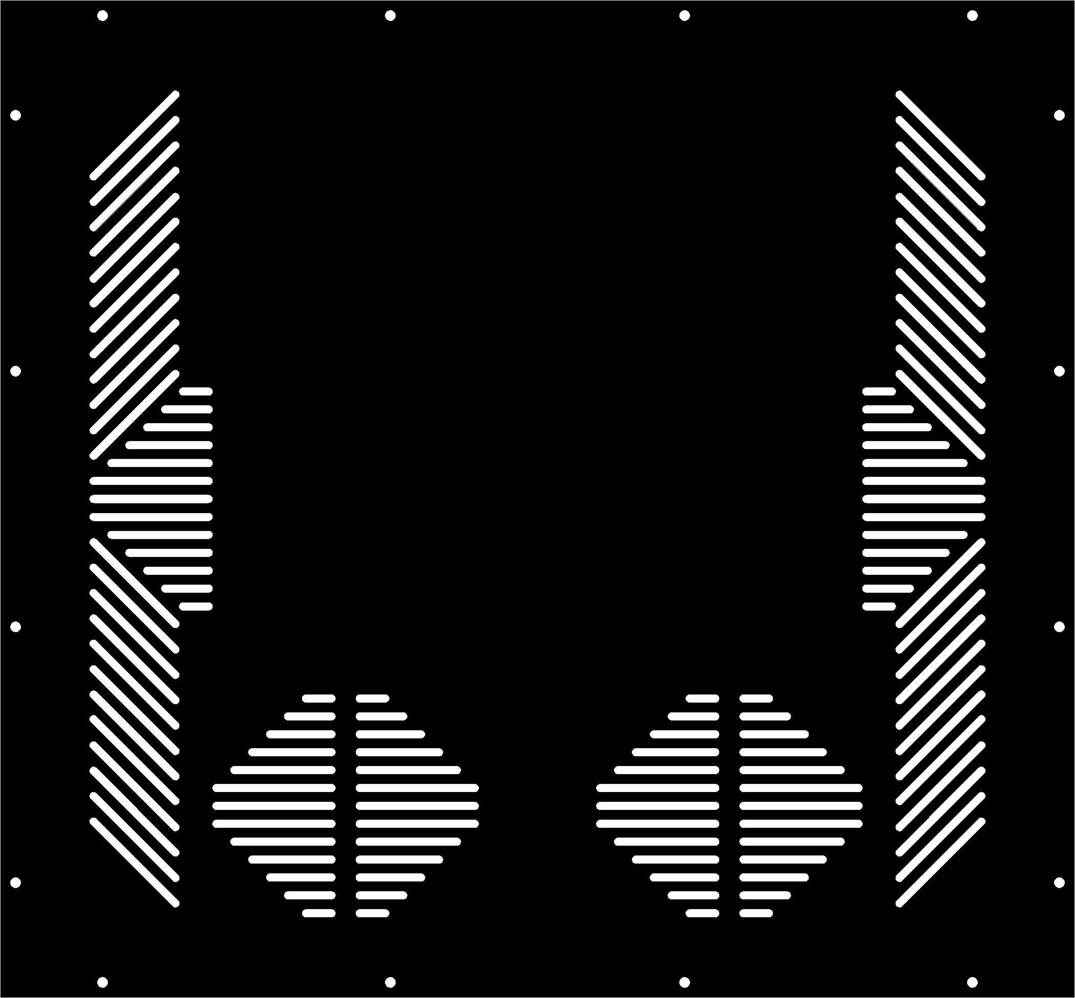

See the deck sketch for my N. Pass F5.

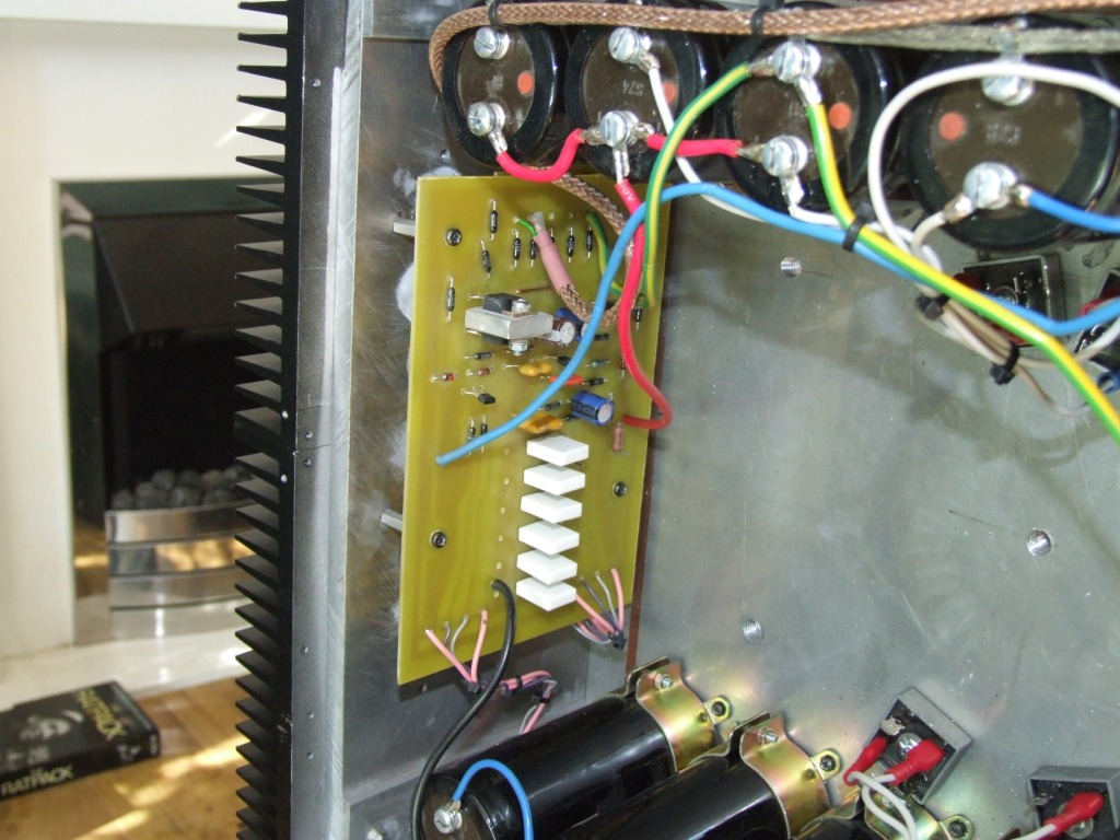

What an absolute Pain-in-the-**** that was, changing the tantalum C11 for the Elna Simic II.
I had to remove the two mains transformers and the chokes just to get at the PCBs.
While I'm in the process of changing C11 on both channels I'll sort out ventillation holes in the bottom of the chassis and fit the chokes with nylon bolts.
