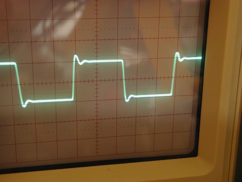

about 20Vp-p. The amp clips with a sine wave at about 22Vp-p so just under clipping. The sq wave still has ringing at lower p-p voltages as well, although at lower voltages it has slightly less ringing. The pic is at 10Vp-p.
Would ferrites somewhere possibly help?

Hi!Which is the maximum undistorted output signal with a sinusoidal input signal?
The output load is 4 ohms or 8 ohms?
Can you post the picture of the oscilloscope?

now desolder both 1nF caps - they;re antioscillation thingie , observe that you don;t have oscillation ,and the fiddle with value of C4
try 15pF for start

22Vp-p
I'm using an 8R 100W load resistor
try 15pF for start

The Power out with 13,8V is ok! I think too that the cause should be the C4/R15 conbinate values.I think too that you have to try to change (slightly)these values.

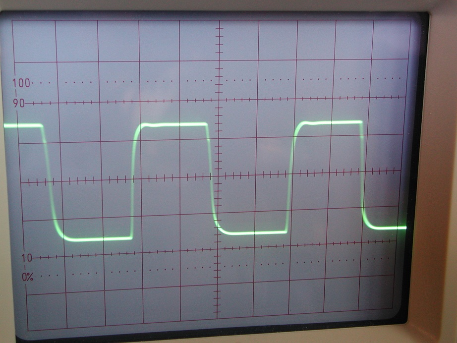

OK, that made a big difference. I paralleled another 10pf with C4 for a total of 20pf.
I'm starting to understand.......R15 is the feedback R and C4 is the compensation cap, correct? Now I want to play with reducing feedback........😀
So my new square wave would indicate a bit of HF loss, correct? Leading edge is a little rounded. Looks like for 100K feedback R, the optimum C is somewhere between 10 and 20pf. Of course my pf cap selection is a bit thin.....

Hi!ZM what do you think about 15pf value i think it will/schould be perfect😉that's good
leave it as is
Hi! BW do you think that you will try with 15pF or not?OK, that made a big difference. I paralleled another 10pf with C4 for a total of 20pf.
