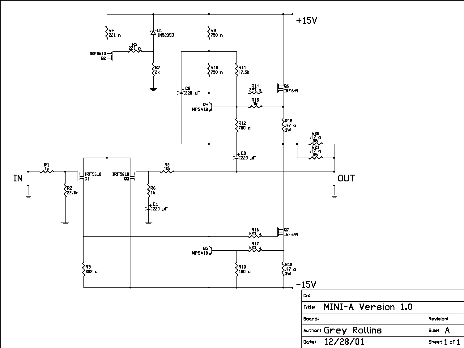

I have finished yesterday my Mini A using BrianGT pcbs.

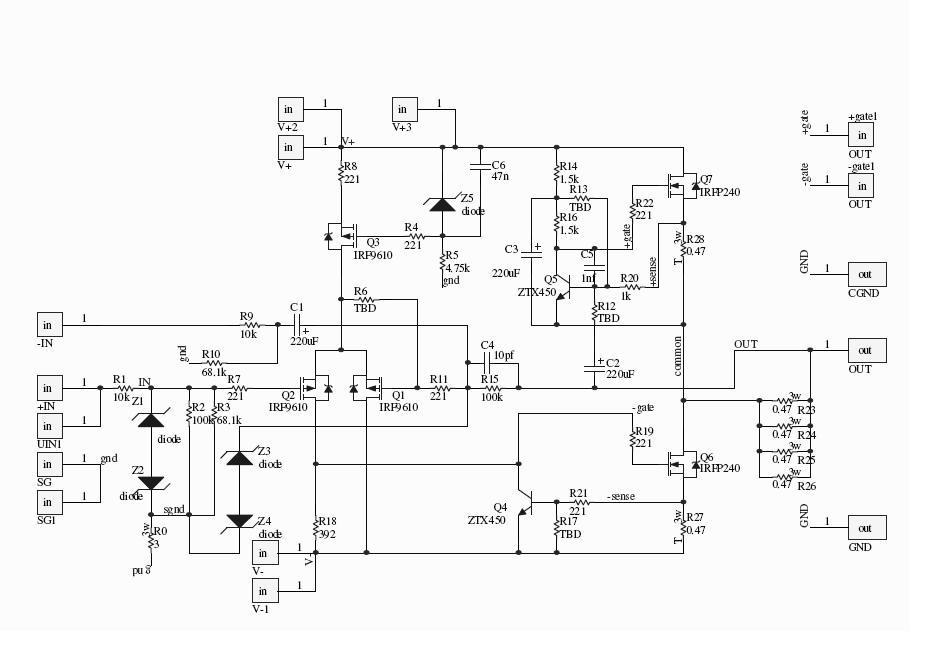

I haven't installed R10 and shorted C1. The thing is I do not understand the gain anymore.
In the seminal GRollins schematics the gain was 1+R8/R6 (GRollins schematics)
If I kept R10 and C1 (BrianGT schem) I would calculate the gain as 1+R15/R10. Is that correct? If so if I follow the gain formula with R10=infinity I get gain equal to 1?
Now (without R10 and shorted C1) the gain is controlled by R15. How to calculate it.
The background of my question is that while I find my Mini loud enough I expected more power. In fact it is quieter than my ACA.
I run my Mini with +/-15.8V and 1.3A. The speakers are about 95dB.

Here are the diagrams I was referring to.
Did I mention that I am running my amp in the unbalanced mode.
Do I need to ground -IN then ?(then I could sort of see the analogy with GRollins schematics and the gain would be 1+R15/R9=11 using BrianGT part numbers)
Many thanks!

short C1 , remove R10 , ground -IN
remove R3 , increase R2 to 1M
then calculate gain with helpp of any operational amplifier cook book , using example of non-inverting amplifier

So I shorted -IN to GND. I think this gives me way too much gain (and I can hear some hum - but that's probably due to too small capacitors tank 30000uF for both channels each pos and neg leg). So I decided to lower the gain adding 10K to R9. So I effectively have R9=20k, R10=infinity and R15=100k. So my gain would be 1+100/20. Any ill effects of this?
Why do you suggest replacing R2 and R3 - increasing input impedance. I already have a B1 in front of the Mini A. what would change technically and soundwise is I do that?
BTW What a great little amp!
in original (say that , for temporary clarity sake , those two Minis are originals) , gain is established with values of 100K and 10K
everything messing up with those two values (connected to important nodes) is .... just mess-up
properly high values of additional resistors are doing their job (keeping gate at gnd potential ) while not influencing feedback net values and operation
R6 is the so called McMillan resistor. R6 can be used to minimize DC output offset. Apparently it has a lot of influence (negative) on the sound of the amplifier. Ideally you leave out R6. Proper matching of the input differential pair ensures low DC output. If you have to use R6, start with 47k.
Search for McMillan resistor, lots of info in the Aleph X thread.
