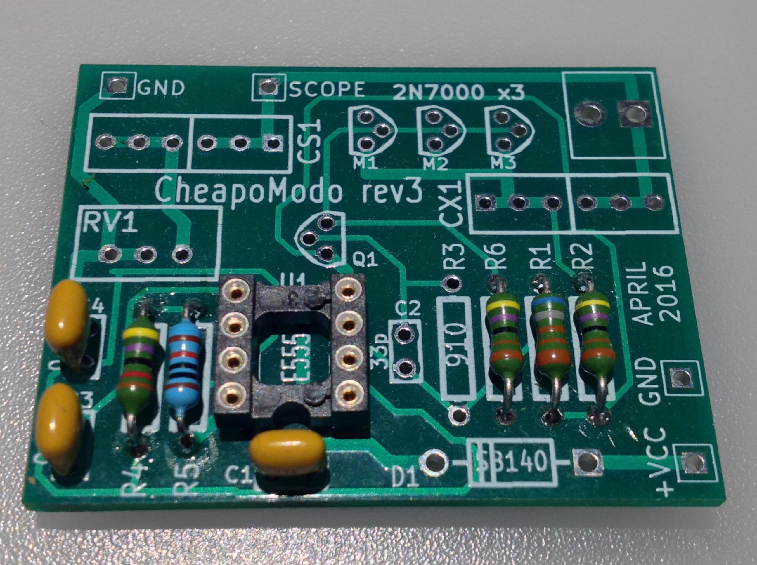

Quasi or Cheapomodo ? 😀who is this quasimodo ?
CheapoModo: quick and dirty transformer snubber bellringer jig
i have found 450VA in a review , so i will put 8nf on each AC side of the 2 bridges , and no quasimodo 😉
